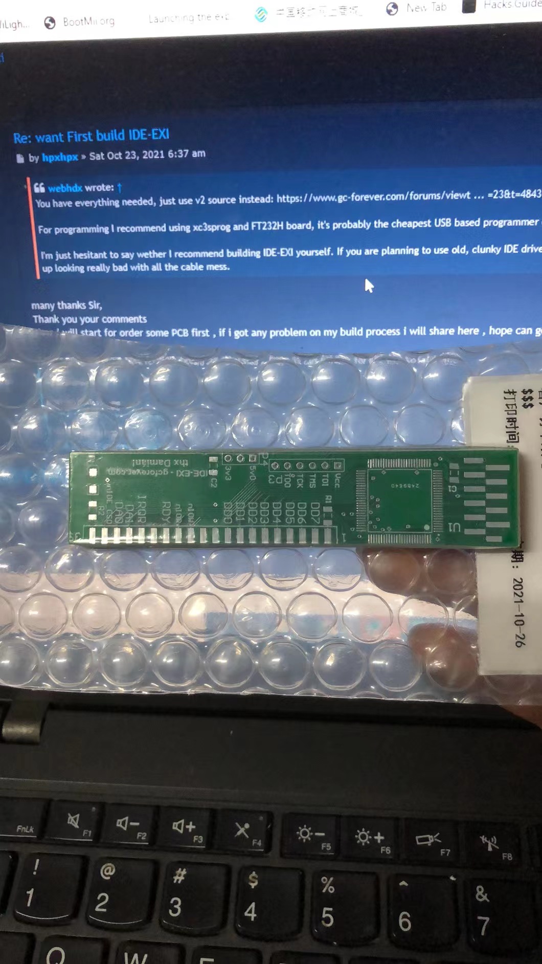

i received my first IDE-EXI PCB today

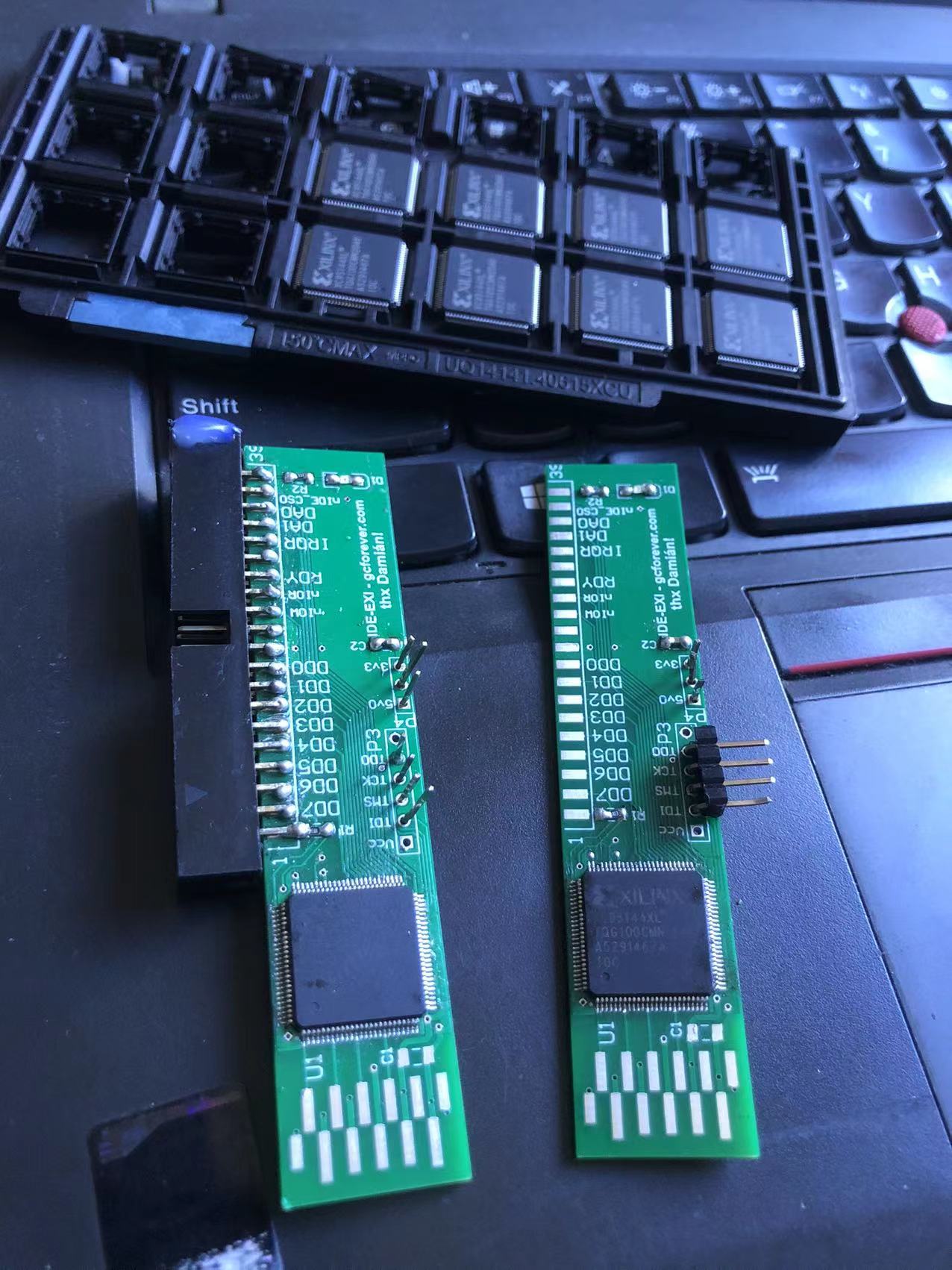

Post by hpxhpx » Sat Nov 06, 2021 12:59 am

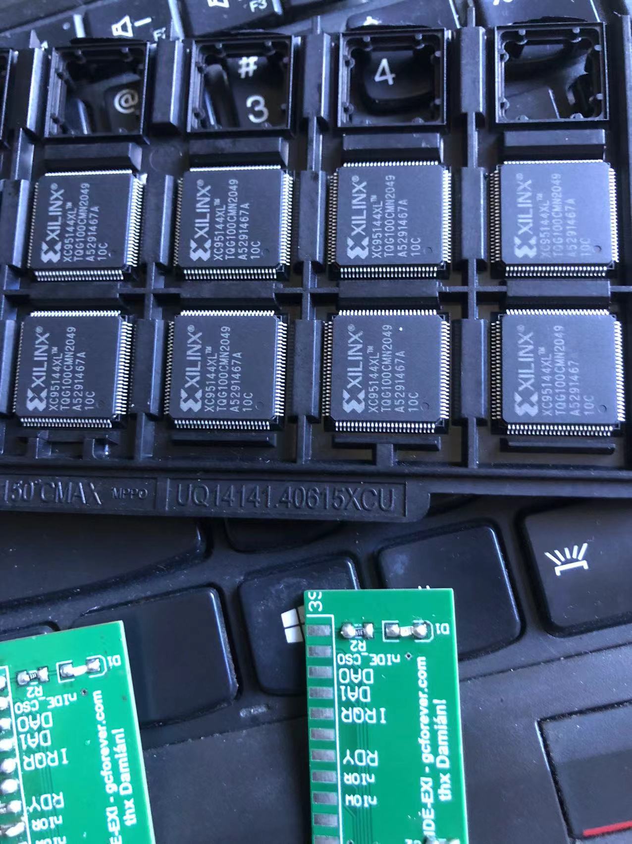

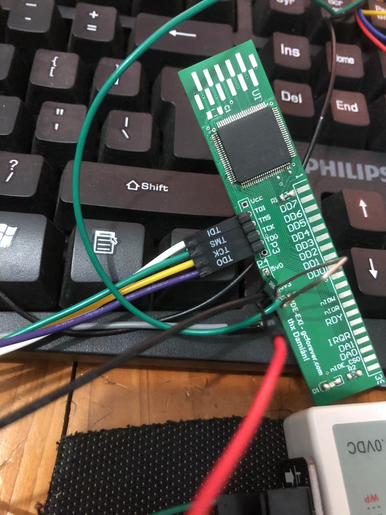

two board already completed the components soldering
programmer on the way ,waiting programmer arrive for FW programming
(276.27 KiB) Not downloaded yet
(265.74 KiB) Not downloaded yet

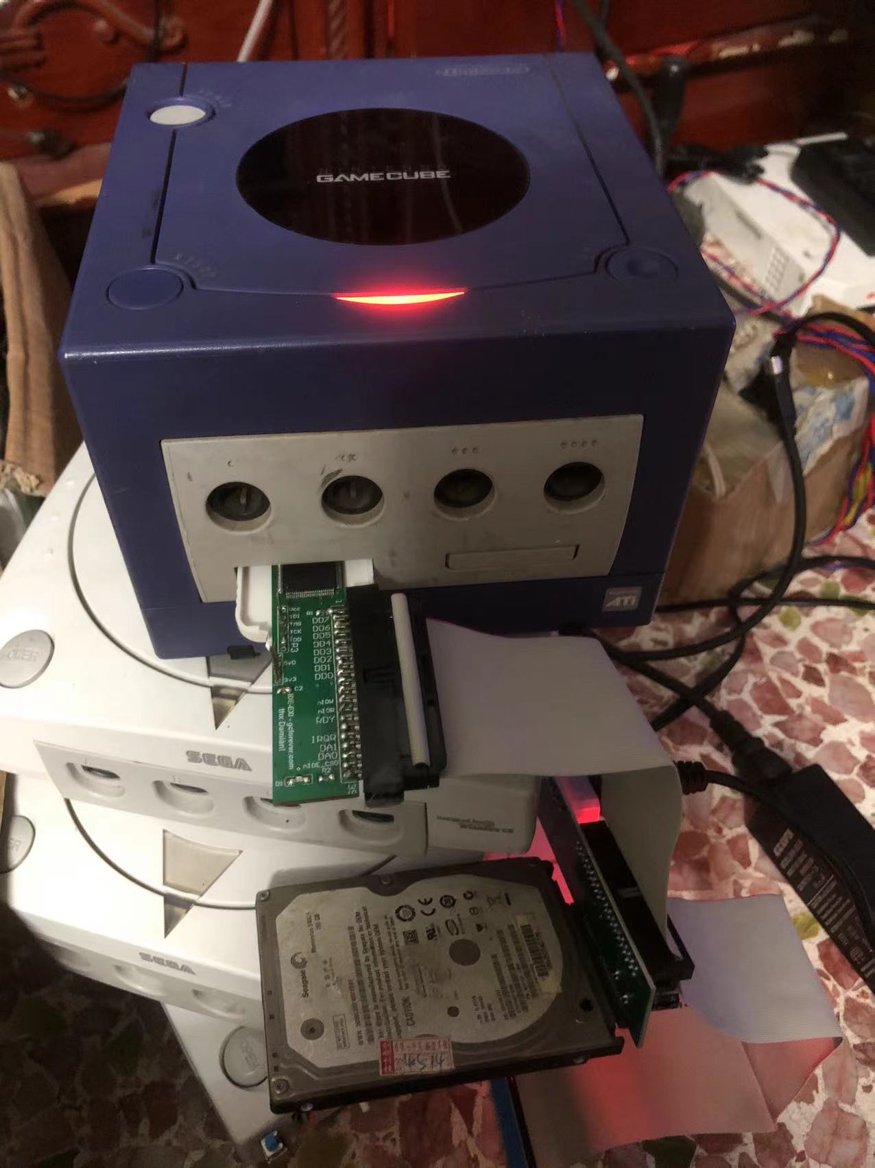

seems my subject was closed and unread so i'm here and need your help
Dears

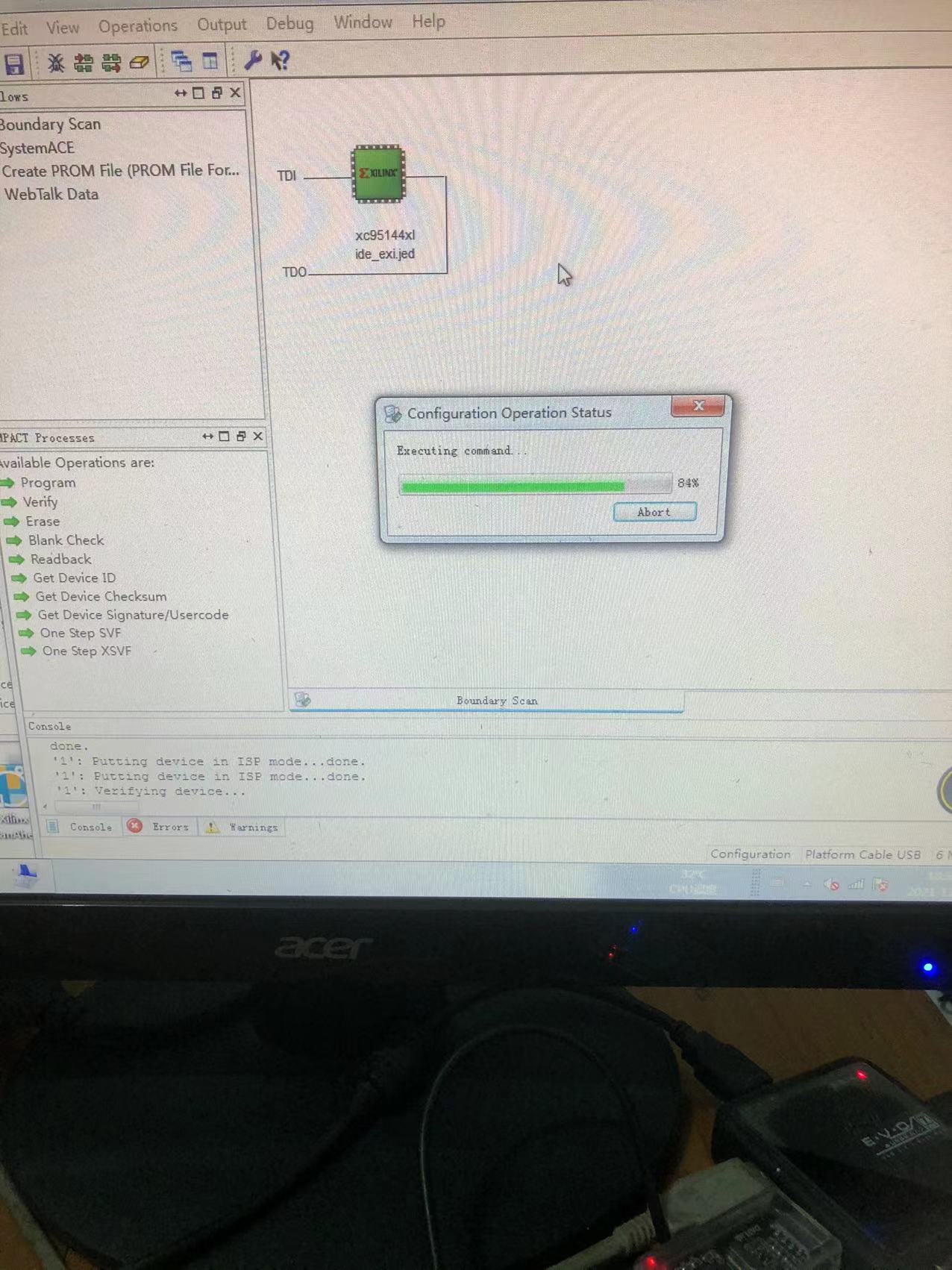

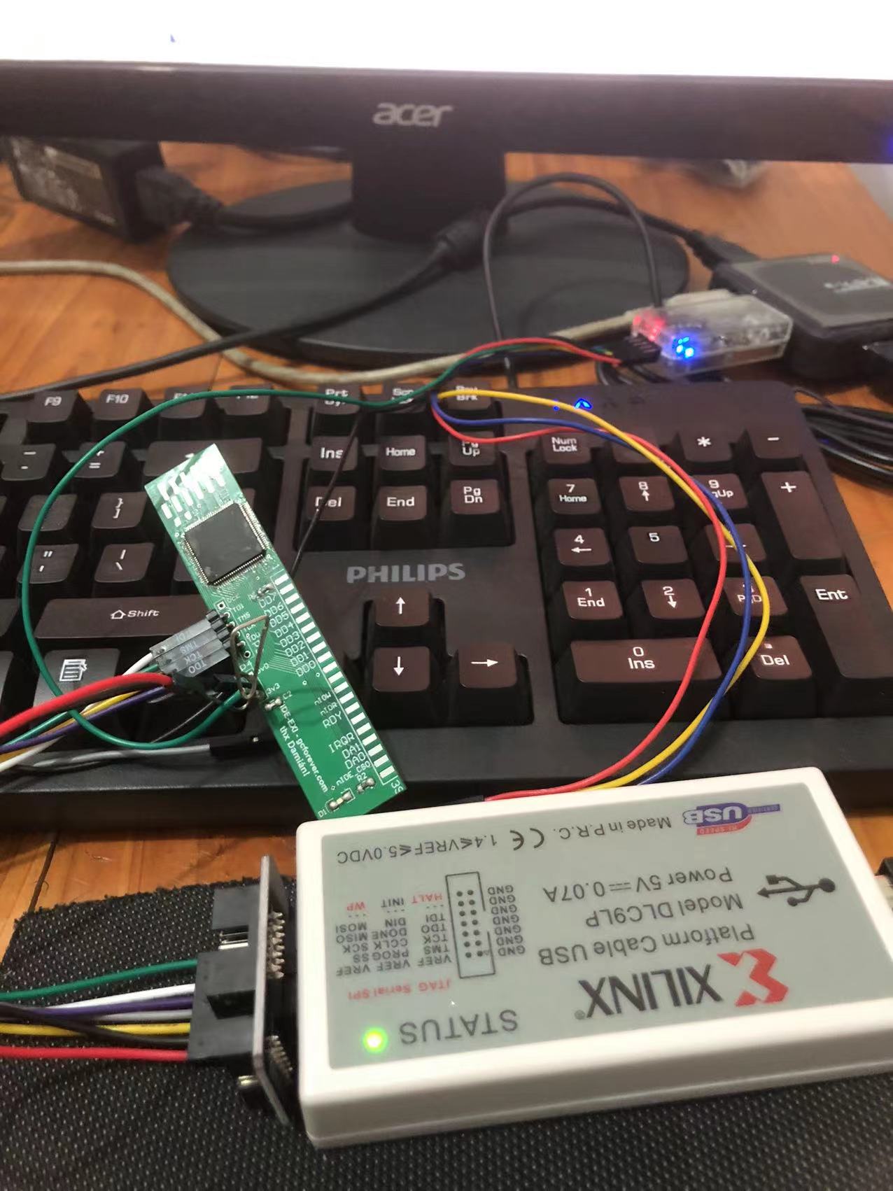

i got problem for use IDE-EXI, Please any one help me you if have any idea

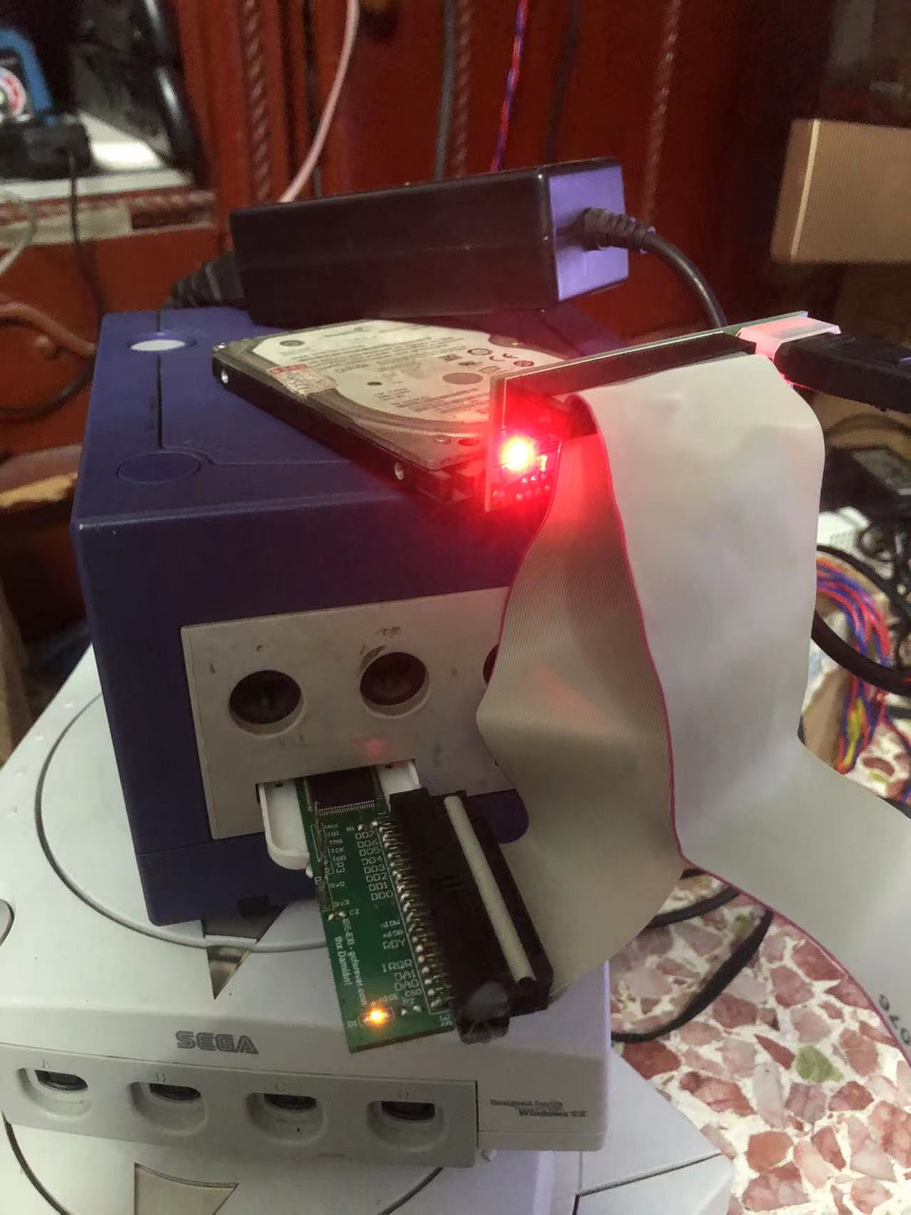

I finished my IDE-EXI board build but it can't working

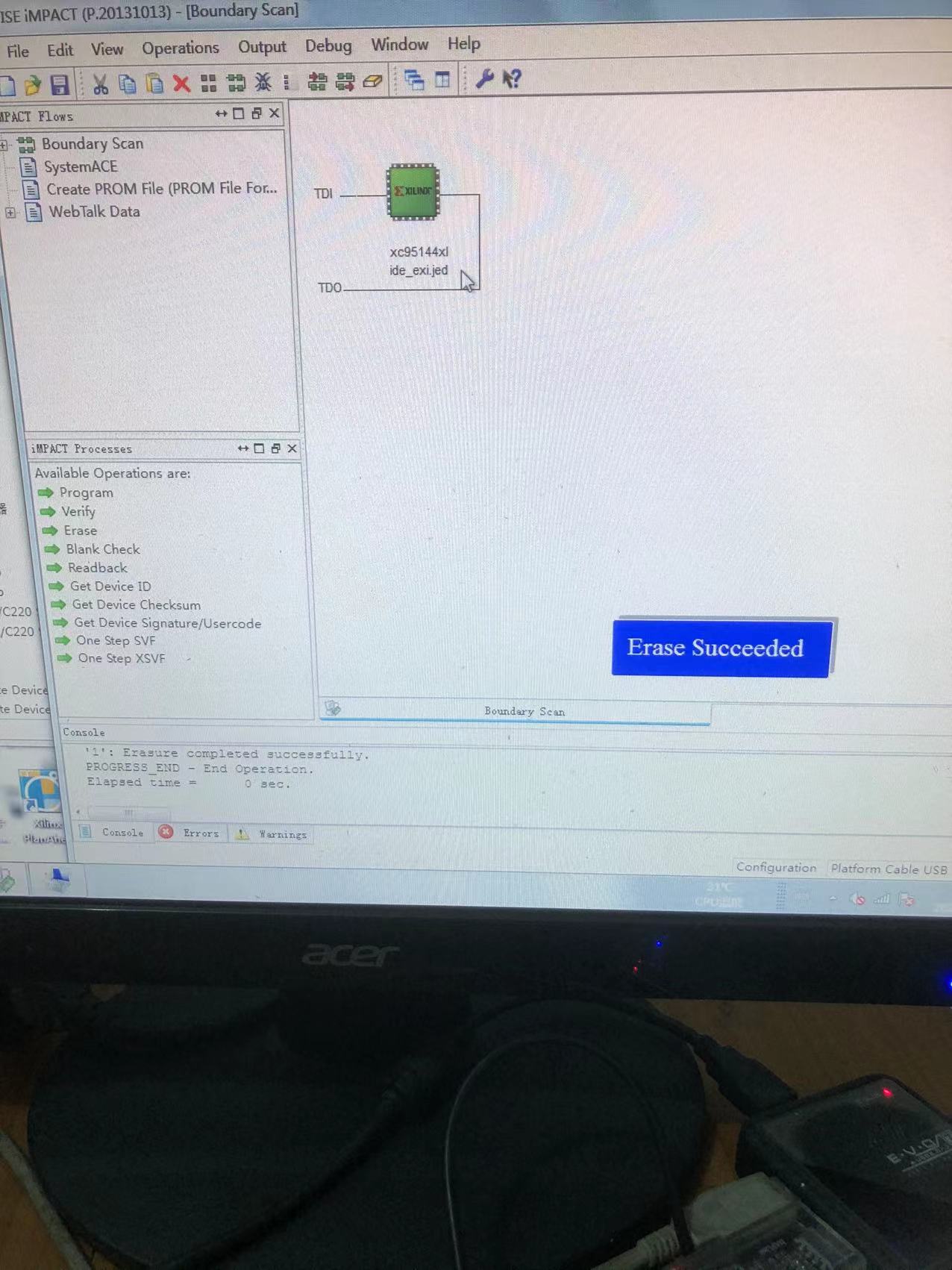

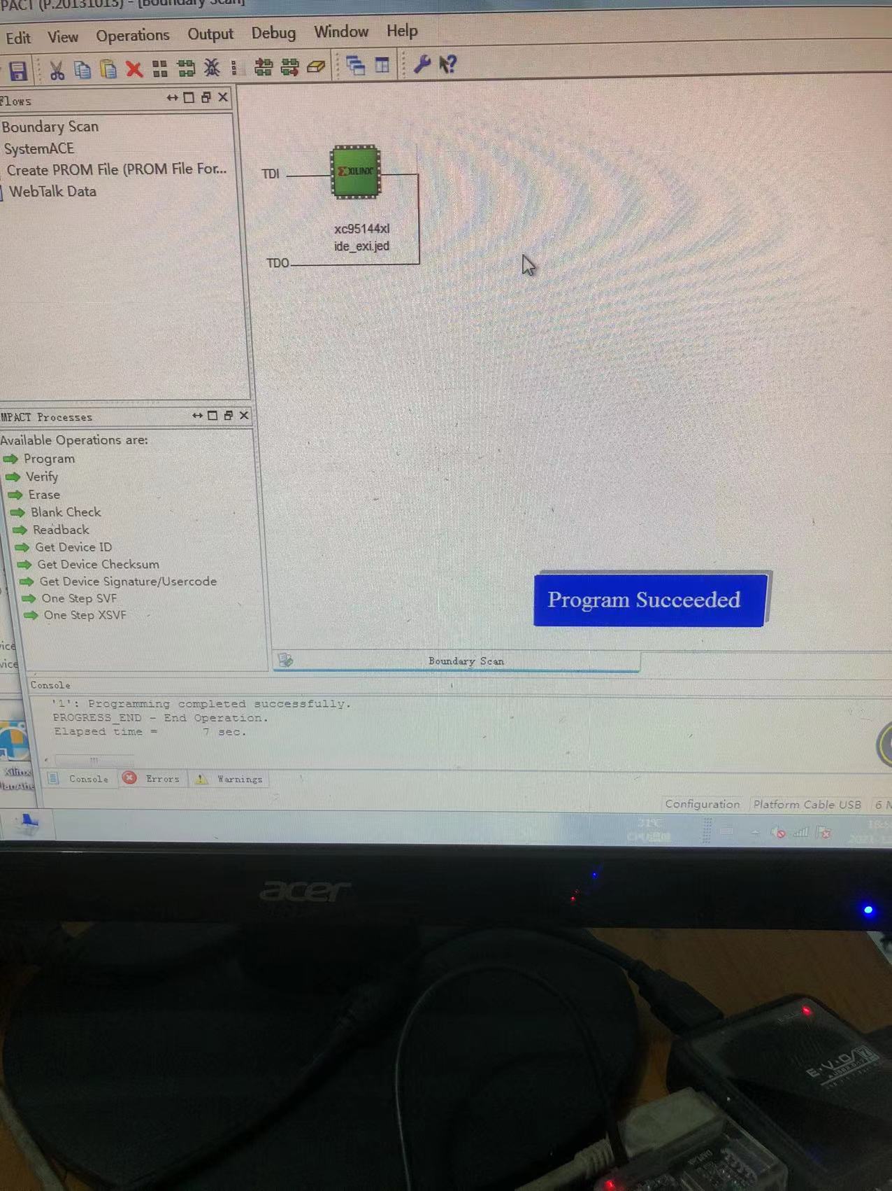

use Xilinx DLC9LP usb programmer for programmed IDE-EXI-V2 and the programming was succeeded

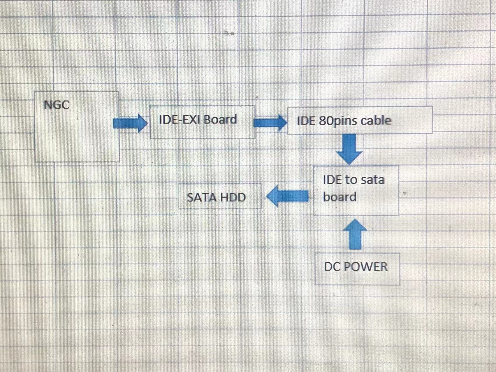

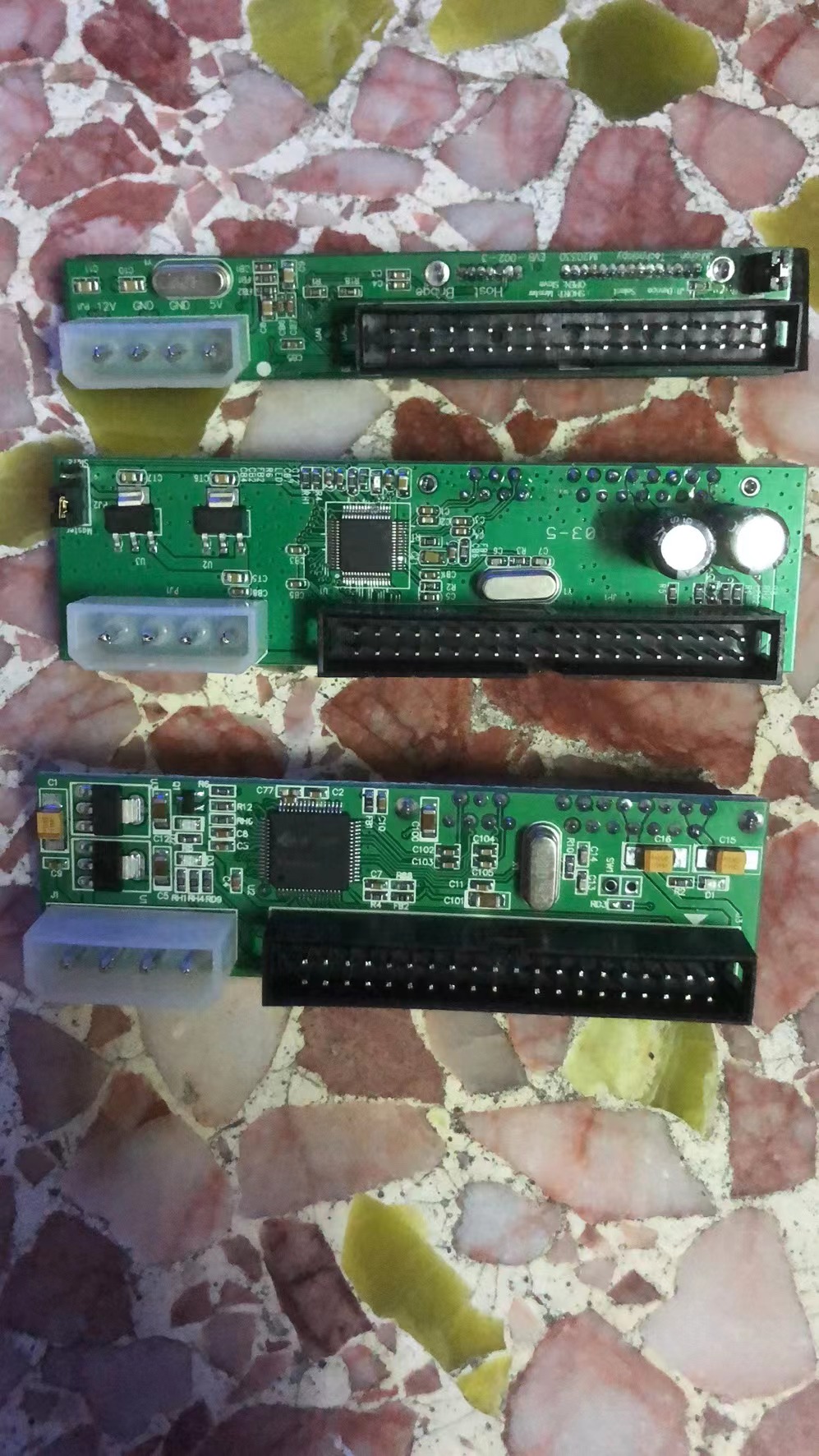

my connection as the setup flow picture (NGC-->IDE-EXI Board-->80pins IDE cable-->IDE to SATA board-->HDD)

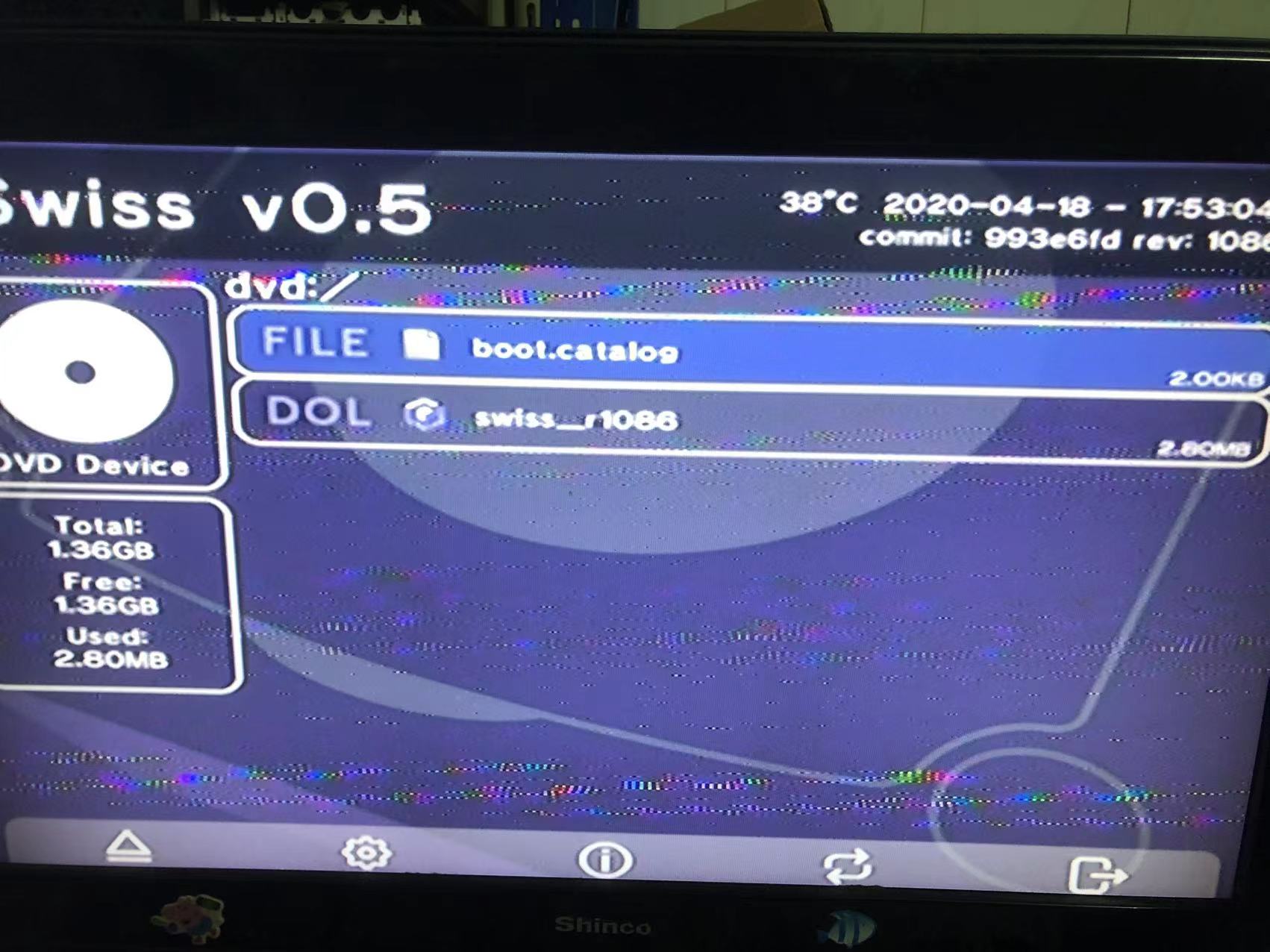

HDD Format FAT32, Copy Swiss 1086 to HDD
By the way ,my NGC can boot by sd2sp2
picture part1
(149.54 KiB) Not downloaded yet
(301.77 KiB) Not downloaded yet
(430.83 KiB) Not downloaded yet
(239.21 KiB) Not downloaded yet
(208.71 KiB) Not downloaded yet

picture part2
(232.75 KiB) Not downloaded yet
(277.74 KiB) Not downloaded yet
(491.85 KiB) Not downloaded yet
(168.76 KiB) Not downloaded yet
(168.85 KiB) Not downloaded yet

Posts: 973
Re: IDE-EXI Gerbers, Design Files, BOM, PDF and Program Files
Post by Papy.G » Thu Dec 09, 2021 11:57 am

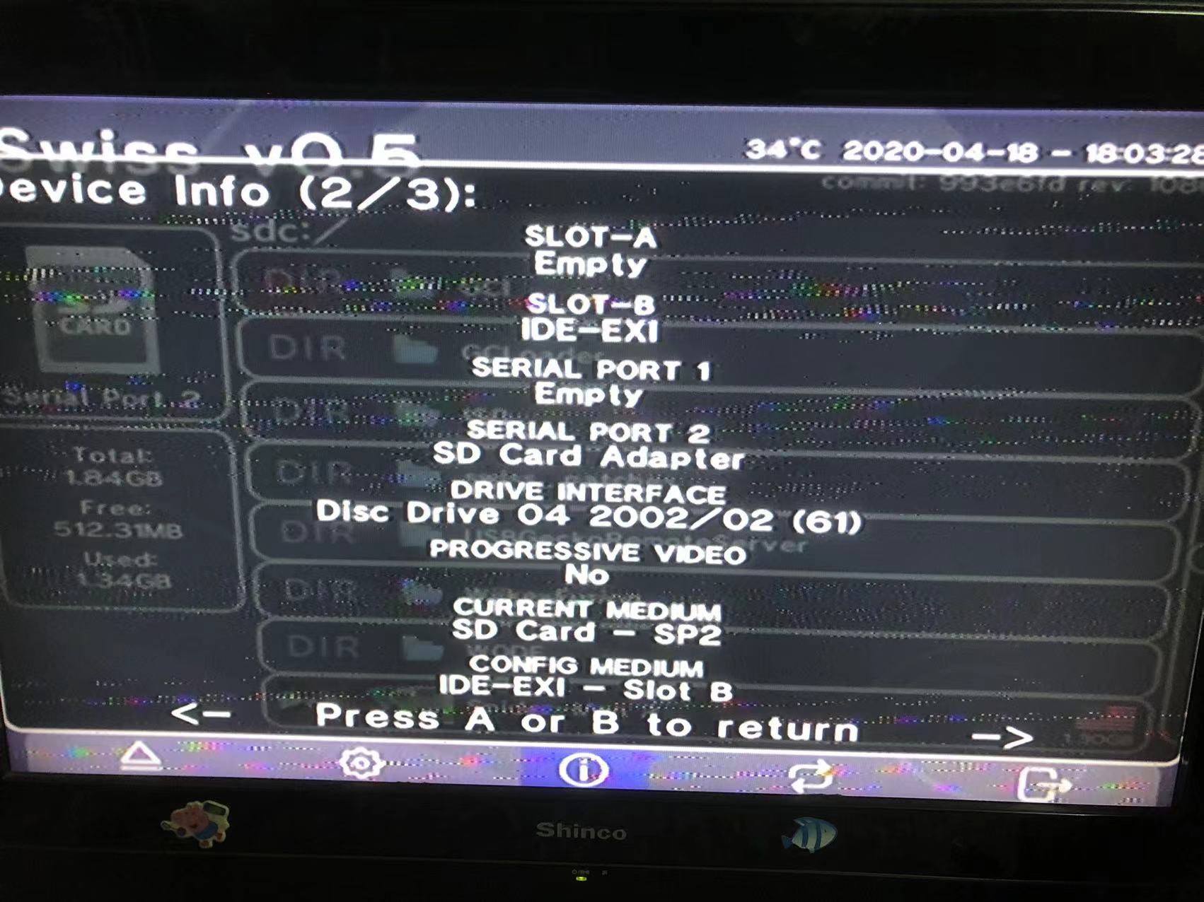

Are you sure your boot method can boot off IDE-EXI?
Try to boot SWISS off your SP2 device first, then see if it can see your hd.
Check github for updates.
hpxhpx
Posts: 21
Joined: Wed Oct 20, 2021 5:51 am
Post by hpxhpx » Thu Dec 09, 2021 12:23 pm
many thanks Sir
the IDE-EXI can detected from swiss by boot from SP2
seems i don't know how to use IDE-EXI Board
i just format HDD FAT32 and copied swiss file to HDD same as SP2
(232.53 KiB) Not downloaded yet
