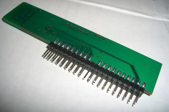

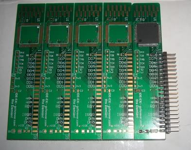

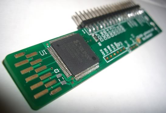

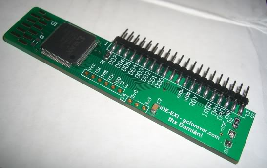

Re: IDE-EXI Gerbers, Design Files, BOM, PDF and Program File
Post by dilav » Sat Mar 24, 2012 8:25 am
(25.35 KiB) Not downloaded yet
(24.18 KiB) Not downloaded yet
(31.63 KiB) Not downloaded yet
(35.87 KiB) Not downloaded yet

Posts: 1814
Post by liquitt » Sat Mar 24, 2012 8:29 am
nice! even with the kind "thank you" words :)
how many did you make?
dilav
Posts: 129
Location: USA
Post by dilav » Sat Mar 24, 2012 9:16 am
It was for personal use, so I had five boards made since price increase isn't much.
