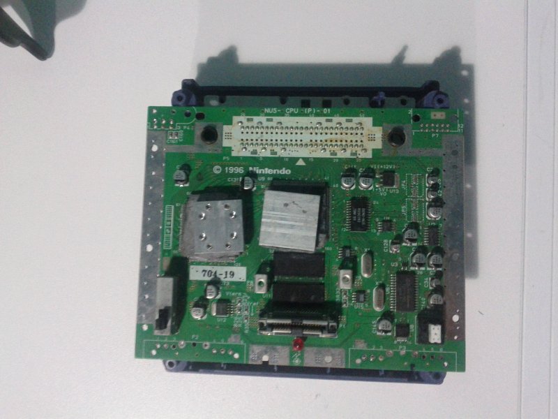

Looks like a bit of N64 mainboard trimming is in order

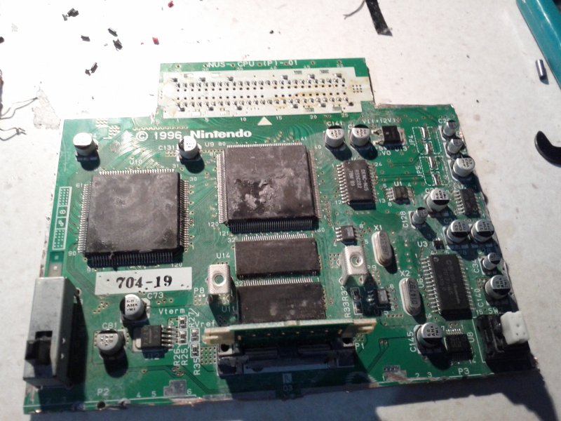

I think it'll be fine though

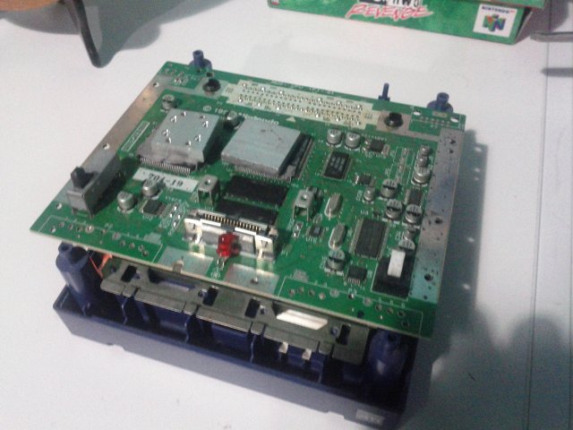

After a bit of trimming

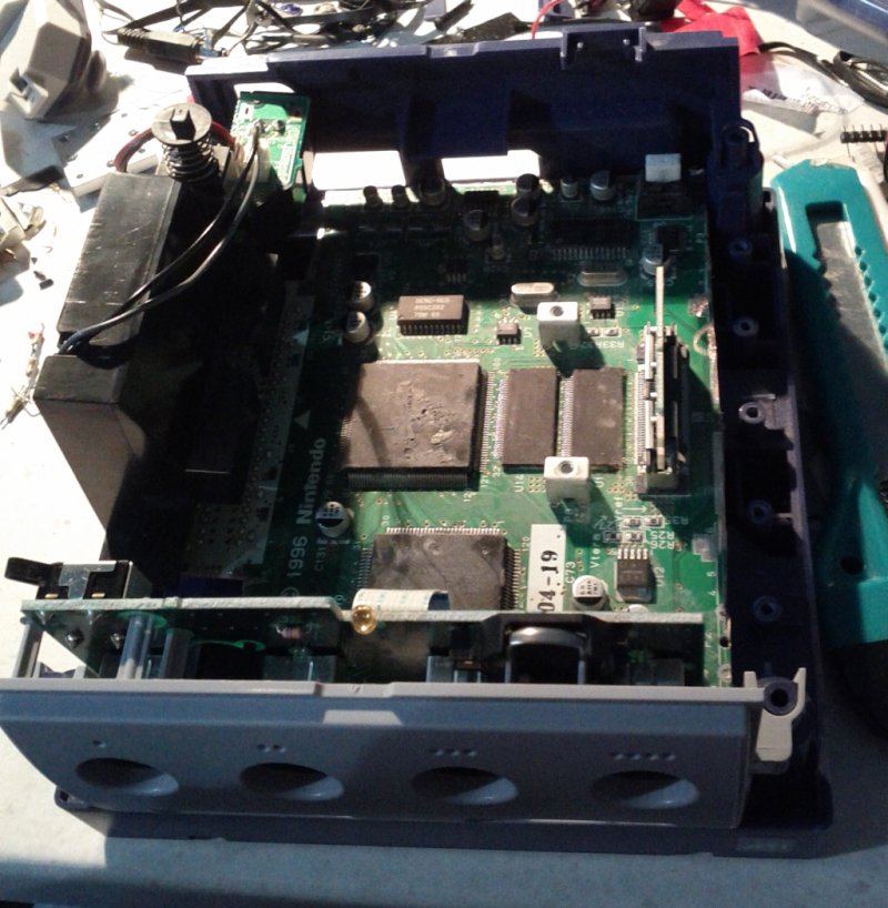

Wait a second, that's not a GameCube mainboard in there! ;)

Also, I'm wondering how you'll add the cartridge slot in the cube.

That looks pretty awesome so far Emu! Make sure you sand the edges of the motherboard to avoid the layers bridging. If you need to rewire the expansion pack, make sure to keep those wires REALLY short. The N64 is super finicky about relocating the jumper/expansion port for some reason. I guess because of memory timing/latency. I've killed a few boards so far trying to get that right.

Also, I've looked at the edges and there isn't any layer bridging thankfully. Is the cart slot as picky about wire lengths as the exp slot? I think I can get away with having the expansion pak not re-wired at all and just removing it from the enclosure and strapping it with a heatsink (fan will bring air through the system anyway so I don't think I'll have any heating issues).
Re: GameCube ate my N64
Post by Ashen » Fri Jun 01, 2012 2:28 pm
Cool. Thats probably your best bet then. Cart slot is not nearly as pciky about wire length. I've seen people do up to 12" on the wires for the cart slot.
