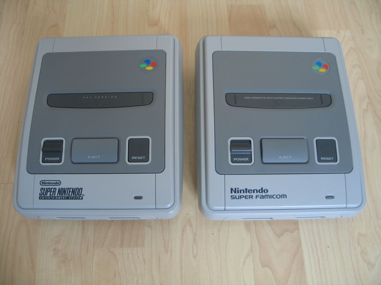

I have used it on several SNES and SFC consoles and it works great. They look like new. You can't tell the difference between one that is treated with Retr0bright and a new one unless you put them side by side.
On the Retr0bright wiki they advise not to use hairdressing creams because they can contain additives which might damage the surface of the plastic. I bought a bottle of 30% hydrogen peroxide from a chemist and I dilute it to 15%. It gives me great results.
Unfortunately I didn't make a before picture, but in the picture I have attached the SNES is original color and the SFC is treated with Retr0bright.
