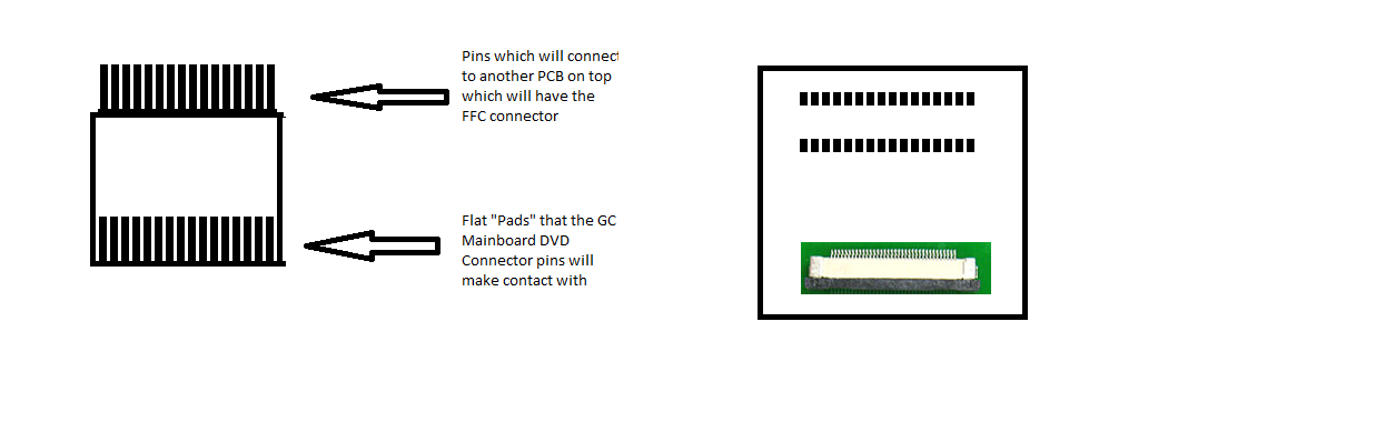

I have had this idea for a while but I haven't really tried it as I do not have the capability of making my own PCB's at home.
Basically, the idea is to have 3 pcb's, two that slot into the GC DVD Connector on the mainboard which basically pass through the connections to pin headers which are fed to a top PCB which does the actual pin mapping to a FFC connector.
I've drawn up a crude example so people can understand what I'm talking about.. I'd be keen to have some of these made (maybe if someone knows people who can get it done) as it'd be a very cheap solution to our wiring messes ;)
(33.05 KiB) Not downloaded yet

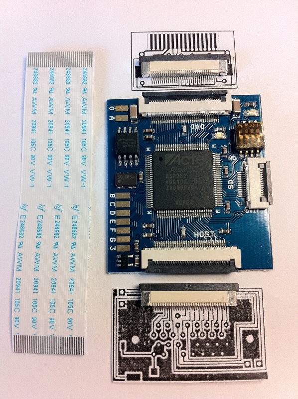

Post by megalomaniac » Sat Mar 31, 2012 7:13 am
as soon as i finish my current project, ill make a few of these
here is the initial design...
the board will have pin connectors to mate with the mobo drive port...
it should be a complete drop in design with no additional effort other than pluggin in the FPC cable to the WKF...
for wode there is 3.3v and 5v solder points...
also has the pin 29 + ground points..
currently i dont foresee any problems in the circuit design...the tricky part will be the pin alignment to the dvd port...
...should not be toooooo difficult...maybe just a bit of creativity...
overall measurements are currently 37mm x 29mm...just a bit bigger than an SD card

Post by megalomaniac » Fri Oct 26, 2012 8:11 am
i have several projects fully developed and ready for full production...
i just need figure costs into this and the biggest factor of cost will be the quantity...
production will begin within the next week and once all the parts orders are placed, there is no chance to order more at discounted cost...
im hoping to keep the cost as low as possible ( maybe $15 -$20 ??? per board )...but this will depend on quantity...connectors and cables are expensive unless purchased in bulk...
- This is a complete DVD port replacement.
- The port replacement board will have an FFC connector for direct interface to a drive replacement chip (wkf/wode)
- i have also created a GC DVD insert adaptor board.
- This will directly insert into the original DVD drive and allow FFC cable connectivity from the drive replacement chip to the GC DVD drive to restore original drive functionality (passthru mode).
Also, the DVD insert adaptor board and the DVD port replacement can be connected directly (if for some reason in the future you want to remove the drive replacement chip)
with production starting next week (maybe week after at the latest), this is now a sign up thread...who is interested?
(hint hint) Portablizers, eliminate some of your wireporn !!
(hint hint) Audio streaming regained with DVD drive !!
(hint hint) Direct connect Wii drive to GC !!
(hint hint) There will not be another production run, get it now !!

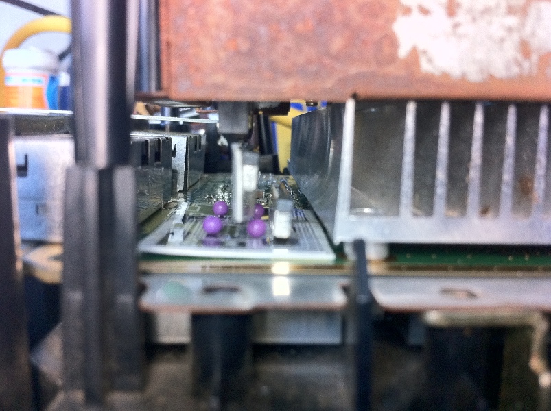

also, damn that is one rusty drive!

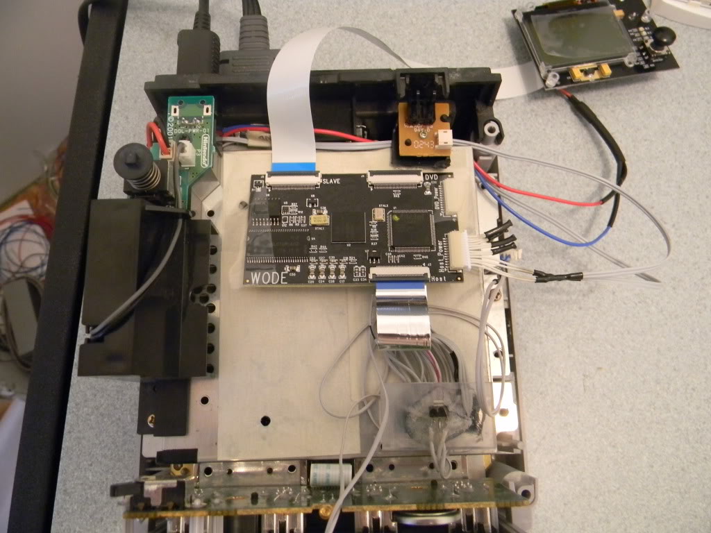

Post by megalomaniac » Sat Oct 27, 2012 12:27 am
in order to understand the benefits of the DVD Port Replacement board, here is a brief overview of the different options available to connect a WKF/WODE to GC...
option 1:
FFC to DIP adapter board
buy the board ~12$ shipped
buy the connector ~ 2$ + soldering fee or do it yourself.
then solder wireporn from the adapter to the GC
option 2:
DIY FFC cable mod
buy a FFC cable ~5$ (or buy more cables just in case the first doesnt work)
cut and mod an FFC cable
then solder wireporn to your GC
option 3:
Ashen style plug and play adapter
this is similar to the DIY FFC cable mod but also requires the DVD drive connector from dead drive or destroy your working drive to remove the connector .
FFC cable ~ 5$
DVD Drive connector ~ ?$
perform an FFC cable mod and solder wireporn to the DVD drive connector.
replacement board ~ maybe 15$ - 20$ price still unknown
remove the original DVD port and solder in Port Replacement.
remove the DVD port
solder in replacement board
i would think the most obvious benefit after reviewing the photos is the lack of wireporn for a WFK/WODE mod.......but lack of wireporn is not the greatest benefit this board offers. It also has onboard 3.3v regulator for main power to the WFK/Wode. The ability to use native FFC cable connection also allows a Wii DVD drive to be directly connected to the GC mainboard (for anyone who wants to mod their GC to front loading.) The board will have pins to allow it to be easily dropped into the mainboard and soldered...
I have owned a WKF for almost 1 year and have never attempted to connect it to my GC due to the simple fact that i did not want to deal with wireporn. I always wanted to have a permanent "solid" connection solution and this is about as permanent as it can get. I hope these photos help clear up confusion and answer the purpose of this board.
