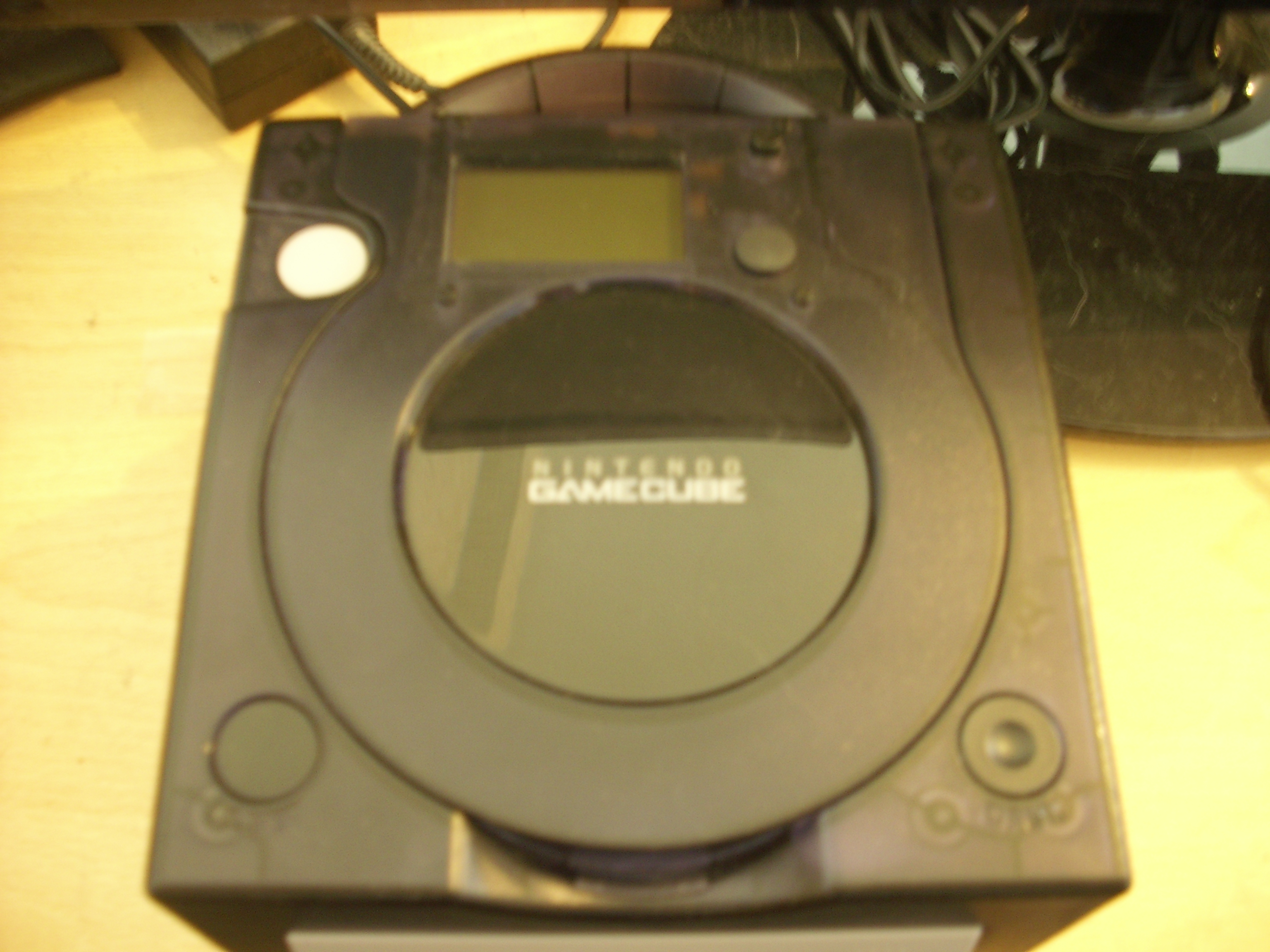

I already noticed some very professional looking portable gamecube mods on this forum. The most impressing thing is the fact that these custom built cases always look so damn sweet
Now my question, would it possible to create some custom built nintendo gamecube jewels which have a hole perfectly shaped to fit the wode display? has someone experience with building such things? i assume this will only be cost effective if we can let produce x units. maybe we can do this and sell it with partial profit for GC-Forever? it's so sad that such beautiful wode displays cant be decently integrated in a wode modded gamecube

The WODE display would be too big to fit into a jewel without cutting away some of the drive lid aswell.
My advice would be to get yourself a dremel and a few different size files and cut yourself a hole for the display. That is what I did for mine although I put it above the jewel instead which took a bit more work to fit it in.

do you have a picture perhaps?

Here's a quick picture.
Had to relocate the sd slot and usb connector and also had to wire the power and FFC cable directly to the board. Also had to do alot of cutting to the case and lid but only needed a dremel, a file, steady hand and a bit of patients. although to be honest it would have been a lot easier to ditch the DVD drive and cut a hole in the lid where the jewel goes but if you have a lot of patients then I personally think it looks better like this and if I can manage to get the DVD drive working with the WODE then it will be worth the hassle.

looks well done
i have a dremel 300 myself... what bit do you use to obtain such clean cuts? i am very bad with my dremel but i think i am using the wrong bits

by megalomaniac » Fri Jan 13, 2012 12:17 am
its the sanding that cleans the cuts
use 400grit wetsand

also, read a bit on google about plastic vs. dremel

I bought the dremel 200 and just used the 2 cutting wheels that came with it. The cutting wheels were number 426 but most of the cutting wheels for the dremel would work just as well, the smaller diameter the better though as the hole for the screen isn't very large.
Make sure you cut 1mm or 2mm inside the hole though and then file the rest as the the cutting wheel melts the plasic. Also cut with the dremel sparingly as it is better to undercut and have more filing to do than to overcut and make a mistake.
