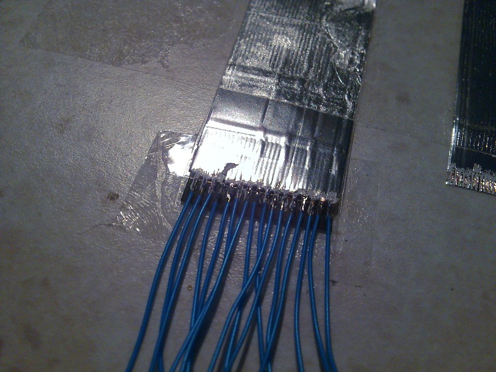

Now that's done we can prep our wires, Cut them to your desired length and tin the end of each one with a bit of solder (you only need a little bit, overkill here is bad):
Apply flux. Not too much, just enough to help aid in connecting:
Hold wire in place with tweezers, its important that the wire is pressed down hard against the FFC lead. Start at the end of the stripped wire and swipe your soldering iron forward to melt the solder and make the connection. This needs to be done quickly (as in like under a half of a second or so). If you take to long you will melt the FFC lead, plastic, metal and all:
Progress down the line:
Once done, test all your connections with a multimeter to make sure you have continuity between the end of the wire and the end of the FFC.

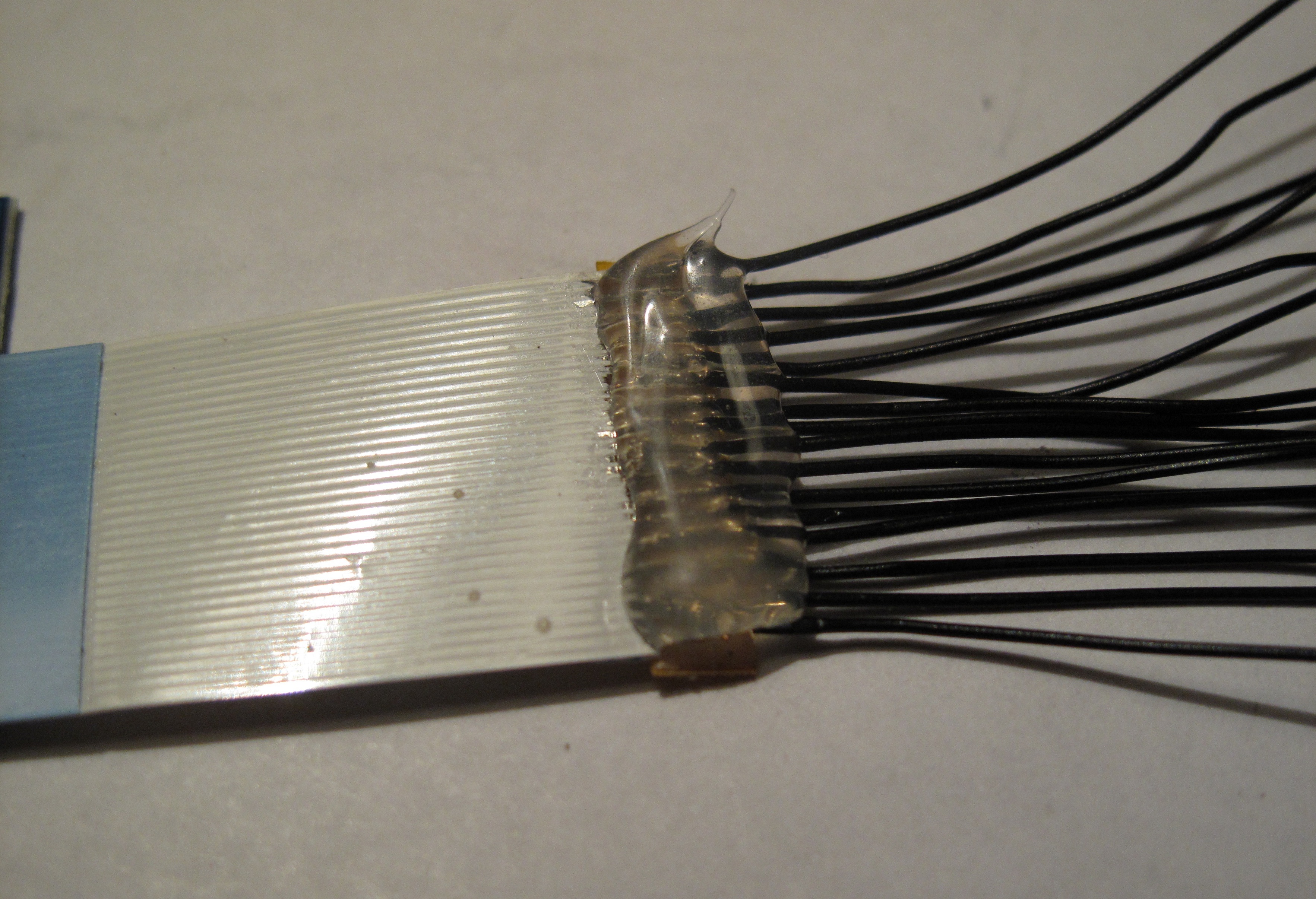

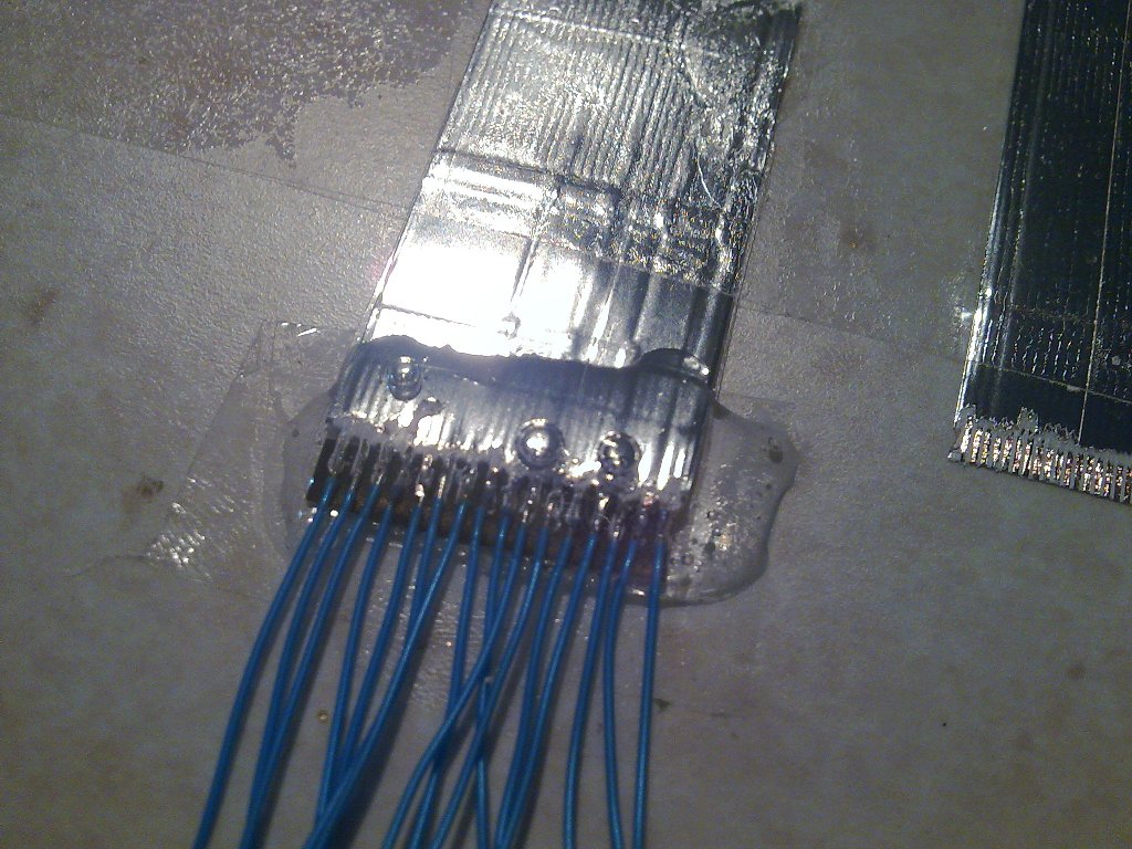

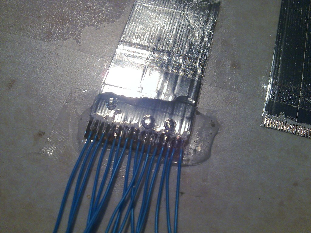

If all is well epoxy/hot glue that side of the FFC:
Rinse and repeat for the opposite side.

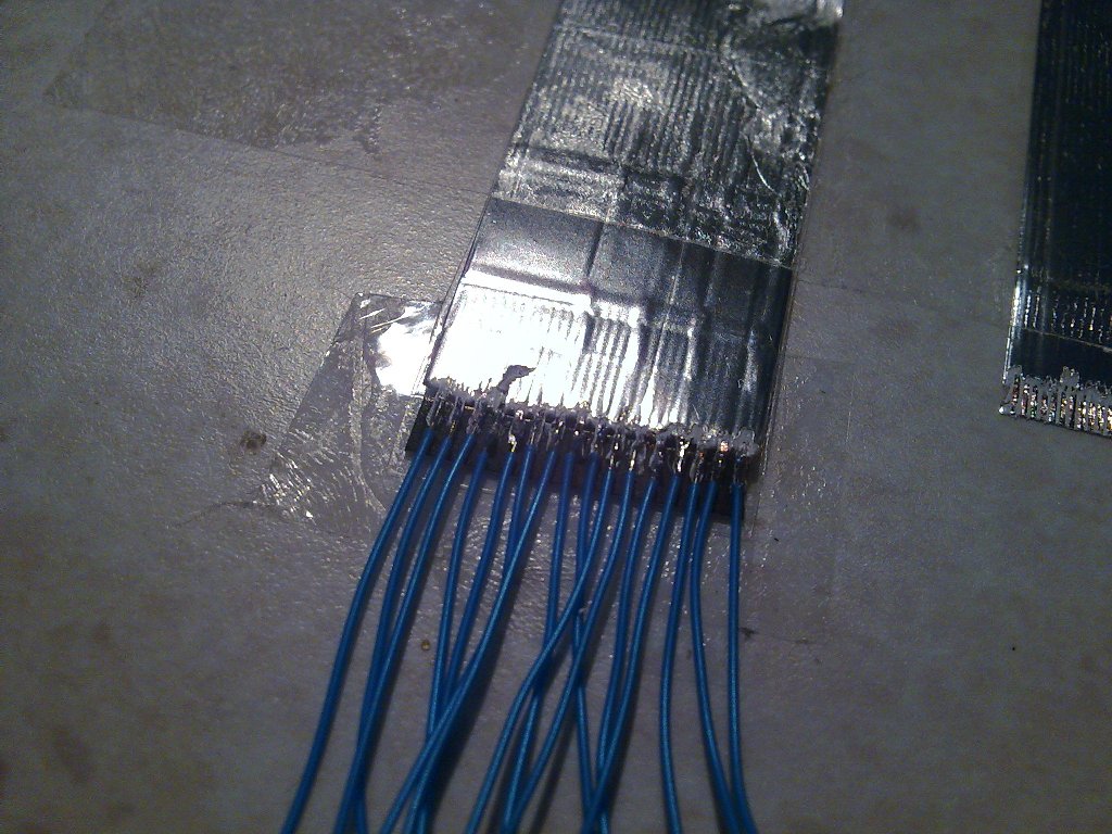

First attempt of wiring, all connections working :D , also tested if there is no connection shorted to a ground pin, so far so good:
(2.17 MiB) Not downloaded yet
DOL-001&DOL-101 <- PAL

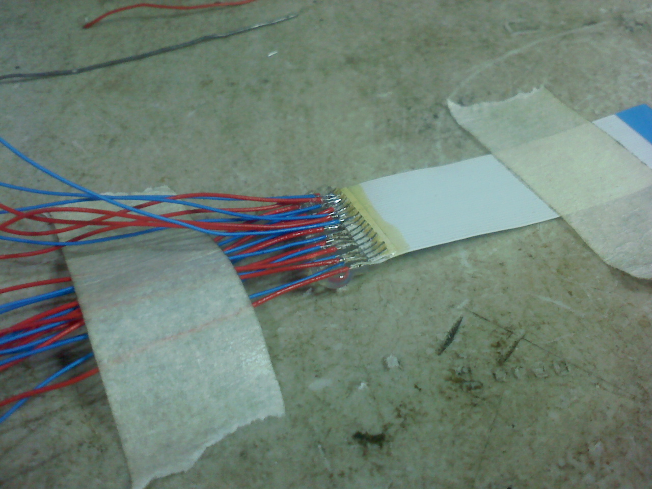

just thought id mention when i did this to a 32 pin ffc. i found it was easier not to split the ffc up witha knife 1st..
Cut it n expose the contacts and so on..
tape the ffc down to a workable surface. put the tape just above the area you exposed your contacts. (I taped cardboard down to a table. then taped the ffc to that)
then flux up the ffc.
Tin your wire (i really reccomend labeling the wires 1st, and using kynar )
then solder to the 1st connection. when it sets gently lift the wire up. the ffc connection comes away from the rest of the ffc because of the previous heat..
you solder 1.. skip 1.. solder 1 skip 1.. untill you have done the 1st 16. glue those down.
then you can do the second set..
I found that easier and faster as it skips the cutting up step entierly. and if you arent to good with a knife, you may find some of the pads you cut up have more than 1 connection on them which means your going to have a bad time.
Just thought id chime in with that.

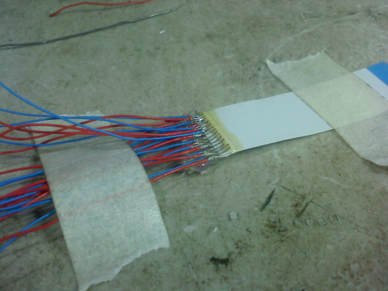

How to "easily" wire to an FFC (Wiikey/WODE)
Post by Modzy » Sat Oct 05, 2013 11:59 pm
Here is mines....work in progress still...couldn't continue cause my heart was fluctuating really bad due to high levels of stress at home :/
(374 KiB) Not downloaded yet
