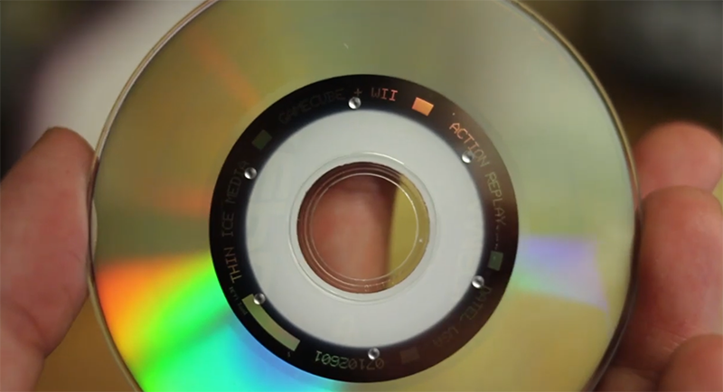

Check for the Security Code of 6 BCA marks on the disc, from the 6 positions stored on the BCA encrypted area
The 6 BCA mark positions corrupt the sector data stored on the disc, the BCA data tells the locations.

GameCube Disc BCA
(402.27 KiB) Not downloaded yet

There are a few arrays with length zero. What's going on there?
Physical Info and Disc Manufacture info structs seem to be DVD standard for the most part.
I know there is key for encrypting the bca 6 mark positions. I looked at decrypted and encrypted bca dumps to compare them trying to figure out what the BCA structure is.
BCA is just 188 Bytes of data can be any thing but at the top is accessible with the Wii Command. but the id, key, 6 mark encrypted positions are not accessible and only can be access by the Panasonic MN102 16 bit Microcontroller.
NSMB Wii case was to use the the bca value of 1 to check if it was a real wii game and not a copy.
