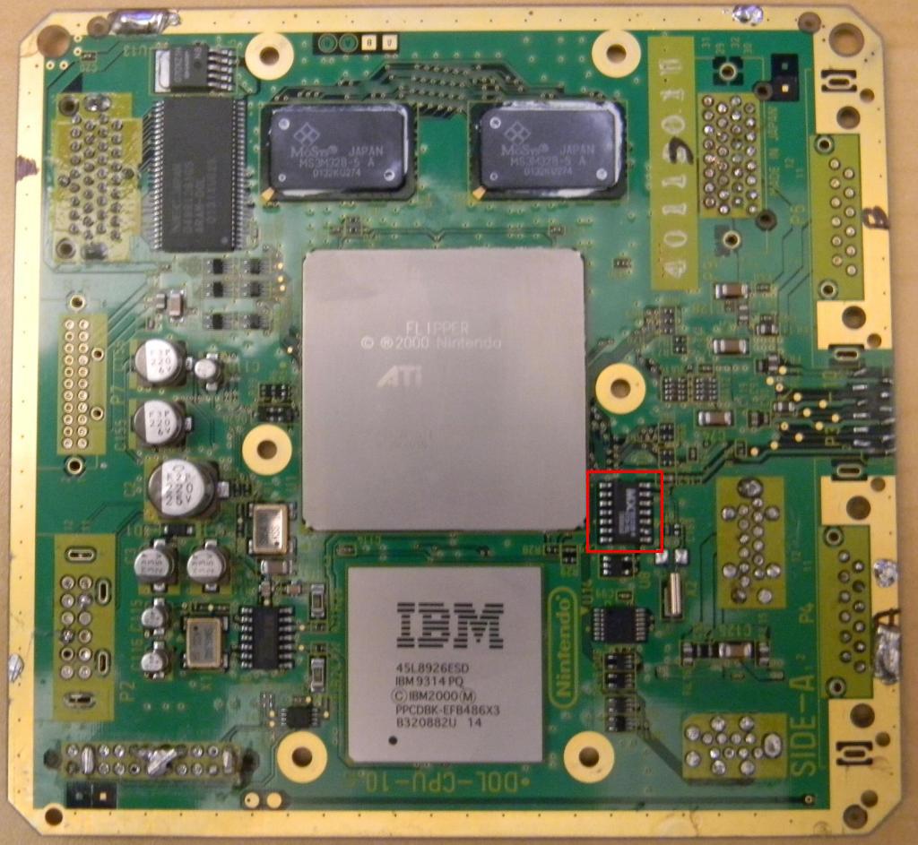

Post by Ashen » Fri May 27, 2011 2:22 pm
Pretty straightforward I guess. What chip on the GC MB is the IPL flashed to? Possible to do a transplant of the chip from a Different cube?

Post by emu_kidid » Fri May 27, 2011 2:51 pm
in the picture I've attached, the red box indicates where the mask rom is which holds the ipl.
(139.44 KiB) Not downloaded yet

a transplant should be relatively easy as long as there are no console specific keys of some sort like in the wii. I don't belive there are but I've been wrong many times. Although I'd think it would be best to use a chip from the same revision board.

We'll find out soon. I'm going to attempt a transplant today.
After all this time I've finally managed to kill my first GC motherboard, kind of on purpose, kind of not... Anyway the board still technically works, it just gets ARAM errors when loading games because of some components I removed. Going to take the IPL v1.1 chip from the "dead" board and try it out on a v1.0 IPL board. might be a good way to make the earlier v1.0 NTSC boards useful again (if you happen to have some dead later version IPL boards around). For Wiikey purposes of course.

I found this thread and tried this out, I couldn't get it to work, tried to transplant a IPL 1.1 to an IPL 1.0, both board revisions were DOL-CPU-11. After putting the original chip back on, the cube booted right back up, and whined about the time so yeah, emu_kidid, confirmed that the rtc is in there.

Today I successfully transformed a IPL v1.0 board into a IPL v1.1 board by transplanting both "MX" chips from a dead v1.1 board to a working IPL v1.0 board. :D
Its now Wiikey compatible. Yay!
These are the chips I swapped:

So I've tested this with another board. A DOL-CPU-10 board that I've transplanted the chips to from a DOL-CPU-30 board. Tested with bios battery hooked up and the system keeps time perfectly. Wiikey and everything else is working perfectly also. I had to do an extra step to get this board working correctly though. Here is what I did:
DOL-CPU-10/11 boards have a different clock crystal than later boards. If you're transplanting from a board with the newer crystal to a board with the older type timing crystal then you have to remove the old crystal and relocate the newer crystal also. If you are doing a transplant from a board that has the same type clock crystals then you only have to swap the two "MX" chips.
Here is what a DOL-CPU-10/11 board looks like stock. Note that some DOL-CPU-10/11 boards have a second clock crystal located to the left of the MX timing chip. You can leave that one alone if the board has it. We are only concerned with the crystal below the MX chip.

As you can see, I removed the old clock chip and wired the new on directly to the IC legs.
