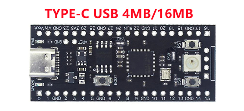

Well I acme across this, this is how a 16MB version looks like.
Do you think it'll work with flashing Swiss?
(200.44 KiB) Not downloaded yet
webhdx
Posts: 115
Re: Some help needed trying to get a working Shuriken Attack
Post by webhdx » Wed Jul 13, 2022 6:57 am
I don't know, as I said I haven't tried it myself. If you feel like experimenting on your own then go for it. I need to fix the code and let Swiss be installed on the standard Pico board. Using 16MB board is hardly a solution to the issue with the code 😅
Undead Sega
Posts: 111
Joined: Sun Jun 14, 2015 7:34 pm
Post by Undead Sega » Wed Jul 13, 2022 11:42 am
Only doing so just in case Swiss expands to sizes we haven't foreseen yet 8-)
Also, do you know if Swiss can be updated via. DVD method?
webhdx
Posts: 115
Post by webhdx » Wed Jul 13, 2022 1:07 pm
I'm not sure why would you want to run Swiss from PicoBoot directly? You still need SD adapter to preserve patches and settings. It's easier to update Swiss file on an SD card instead of having to flash PicoBoot via USB.
Undead Sega
Posts: 111
Post by Undead Sega » Wed Jul 13, 2022 1:49 pm
Wait, I thought you could flash Swiss directly onto the PicaBoot? :shock:
webhdx
Posts: 115
Post by webhdx » Wed Jul 13, 2022 9:23 pm
It's probably possible but I haven't tested it because I only have Pico boards with 2MB flash. You need a different board to try it. Anyway, I simply don't see a point to program PicoBoot with Swiss. Especially because you will need an SD card anyway if you want to persist patches and settings.
