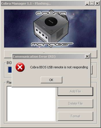

So...finally i got to this again...and got maaad in 20mins :P
So i'm trying to flash the filesystem of my viper extreme. both of the dip switches on OFF, programming cable not plugged in, adapter plugged into the serial port.
cobra manager connects to it, i add a file (ANY file, from the smallest theme to swiss) and it starts flashing and the bar doesn't move anymore. after some time an error pops up: usb adapter wasn't found anymore or something like that, sounds like a timeout
anybody else with problems like this???

Here's a Screenshot of the error

I assume you have the Gamecube turned on too? try another chip if you have it, but I assume you've also tried, another USB cable, triple checked connections/etc?
Can you boot this Viper up on the GC?

yep, Viper boots fine, i can use the cobra bios etc etc, tried 3 usb cables yadda yadda :/

the dip switches are set correctly? only on cobra 2.1 it isnt nesseccary to change the switch position with other bios <cobra 2.1 you need to change the position.

as emu suggested on IRC, that the ribbon cable should be attached, too didn't help either :(
yamaharacer, see my first post: both dip switches OFF, so yeah. set correctly.

doesnt matter. which bios are you using at the moment? the only bios you dont need to change the dip switch is cobra 2.1. for the rest you need to change also for flashing the flash of the viper. i have had the same error on my windows 7 pc with xp mode. after i have used anonter xp pc, chorter usb cable and switched the dip to on everything works for me.
edit: try flasher 1.0 maybe this would solve the problem.

i'm using 2.1 and i'm using the manager, not the flasher.

Yeah, I used to have this problem too. I never worked out what the problem is. I think that there's a problem with the cobra manager program because all the other programs (dumping games, etc) worked properly with the usb adapter after a clean install of cobra 2.1.

yes i do and yes it does :(
guess i'll re-solder everything once i get around to it....

Sorry to bump an old topic, just wanted to share my experience with flashing the Viper.
After soldering again and again, wondering why the viper flasher froze on writing.
I successfully flashed the viper, and it boots wonderfully.
Using the "ViperUSBWin7Driver.zip" resulted in freezing the viper flashing program while writing.
Then I tried another Netbook with the driver and flasher from "ViperFlasherUSB10.zip" with Cobra 1.5,
and it flashed perfectly. :lol:
Have yet to try backups, but I'm happy it finally works, and after all the soldering, I haven't ruined my gamecube. :)
