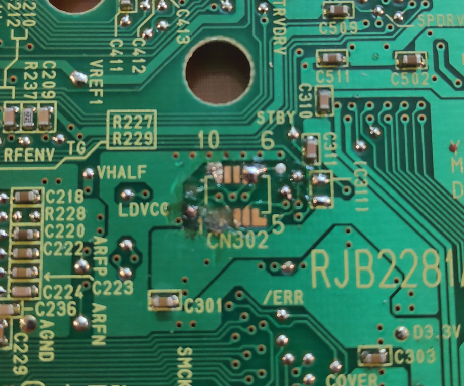

Hello Guys,
I'm new to soldering stuff and I tremendously managed to damage electrical tracks on the optical drive PCB (see pic) :
pic
(163.05 KiB) Not downloaded yet
My question is, what can I do with it, now ? I already ordered another optical drive PCB but I would like to know, whether it could be worth the try to do something, in order to fix.
Thanks in advance for your opinions, guys.

It can definitely be fixed but given you didn't have the expertise to perform the modification in the first place you probably also (currently) lack the skills to repair it.
If you feel like learning/spending some time on it, watch some videos online on how to perform pcb/trace repair and experiment. Otherwise, it's a fairly cheap part, you might as well keep it around in case if you ever need any components from it.

I also messed up quite a few baords trying to solder the chip directly (I never managed actually).

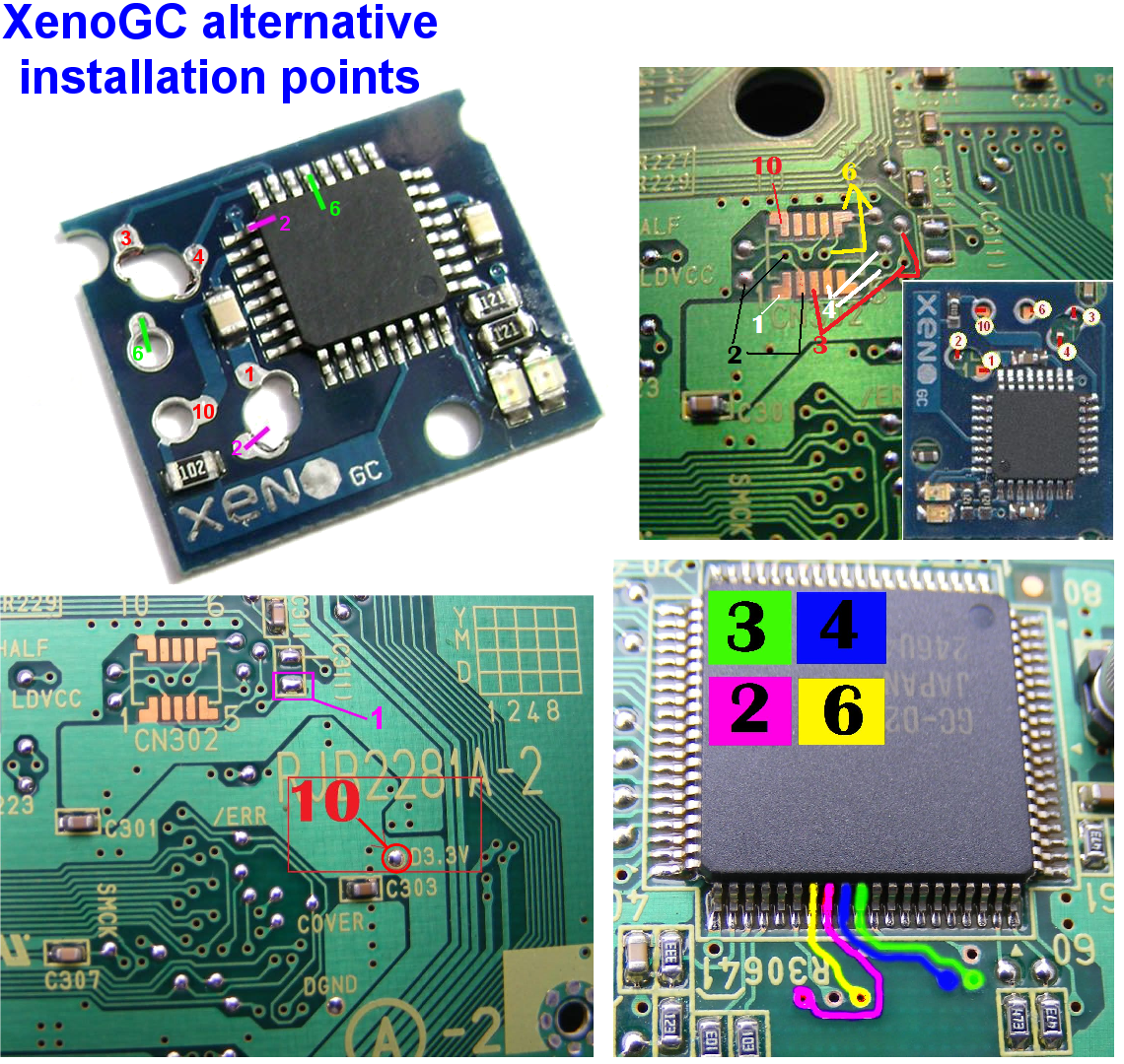

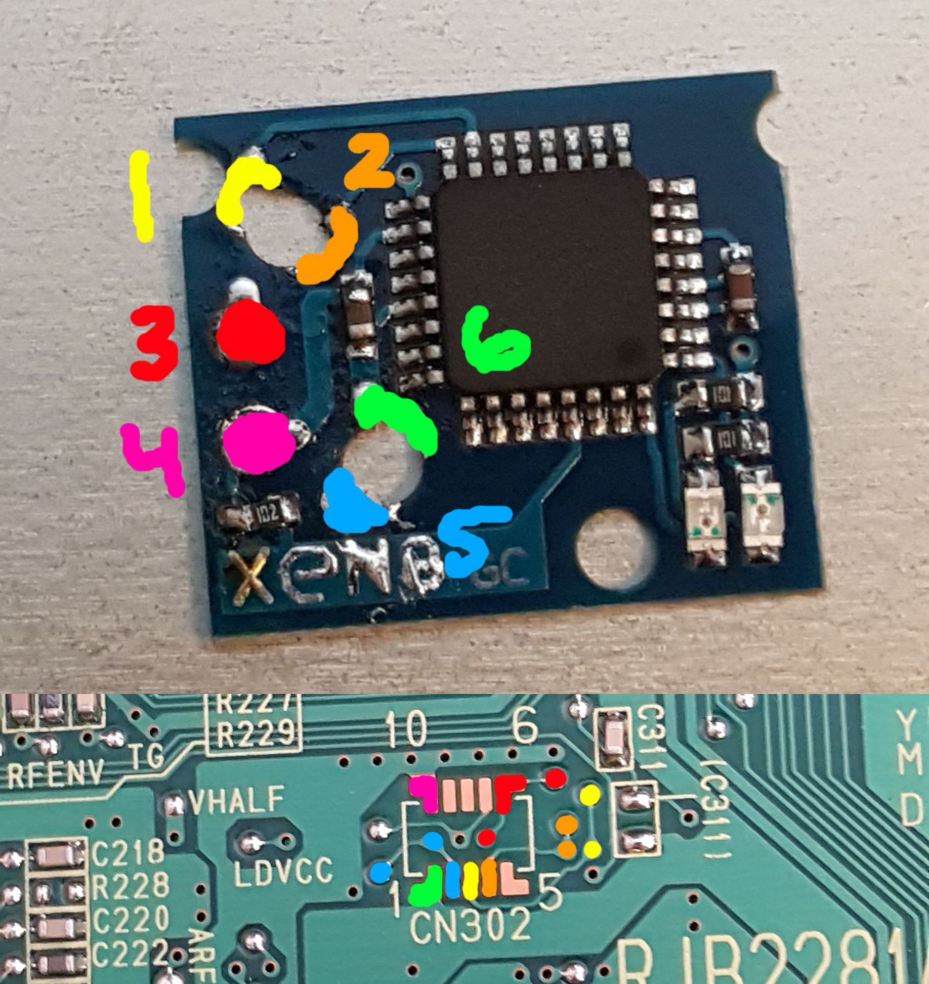

But using wires, I did about 6 successful installation. Your board is still functional but the Xeno most likely wont work on these pins.
Try to google for alternate points on the other side of the board and use wires!
I attach the classic way for the wires but you need to find the alternate points.

Alternate:
(1.64 MiB) Not downloaded yet
