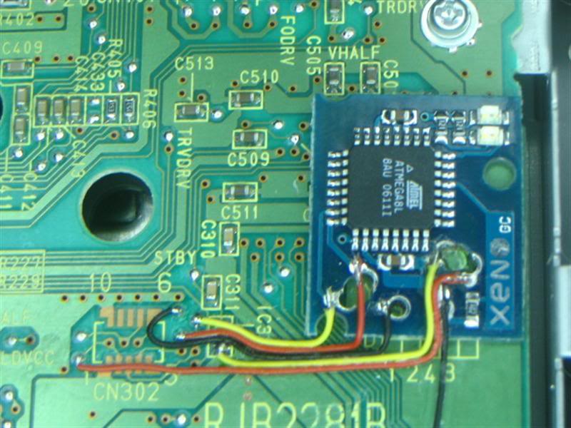

Hi guys, I just tried to mod my gamecube with a XenoGC but a bit of solder got under the board causing it to short and also get stuck, when I used a heat gun to get the xeno off to reapply it with a wired connection, one of the traces came off! Heres an image of my gamecube's board now

"10" is the one you ripped off? just go to the via above it (7 vias in a row)

And don't forget to clean the bridge between 1 and 2! :shock:
