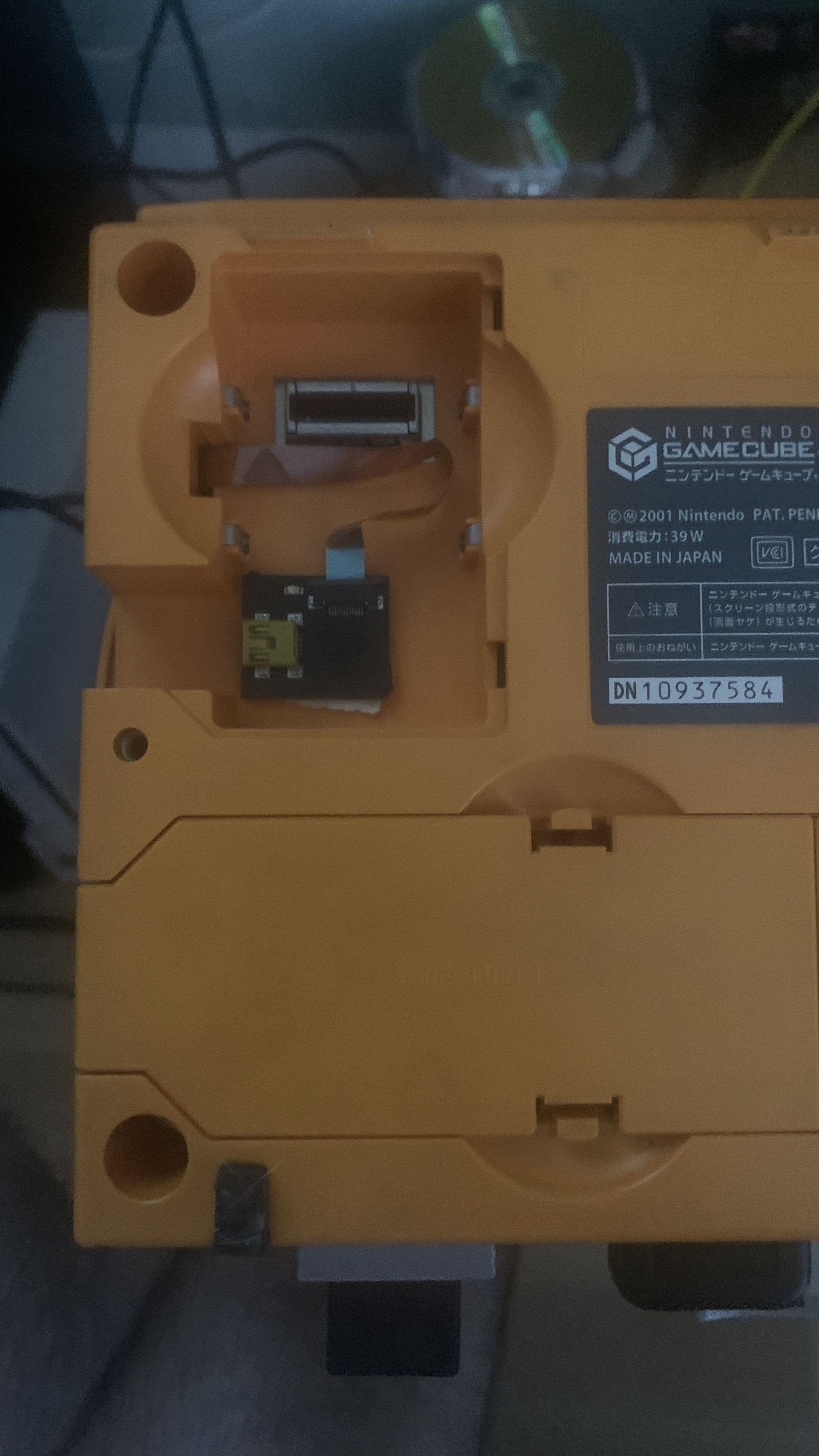

No there is a small breakout board on the bottom of the cube at lease that’s where it should have been installed

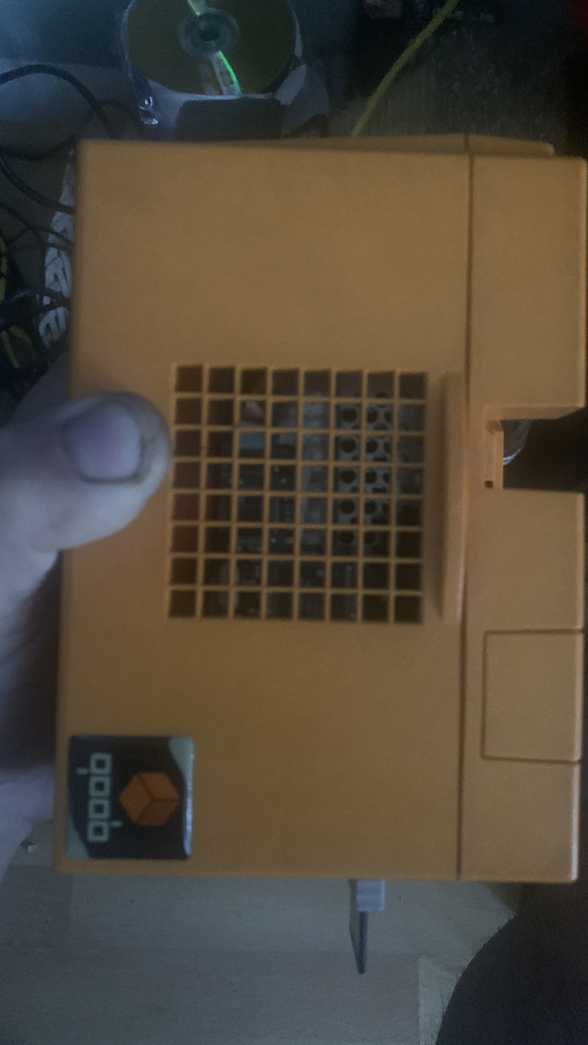

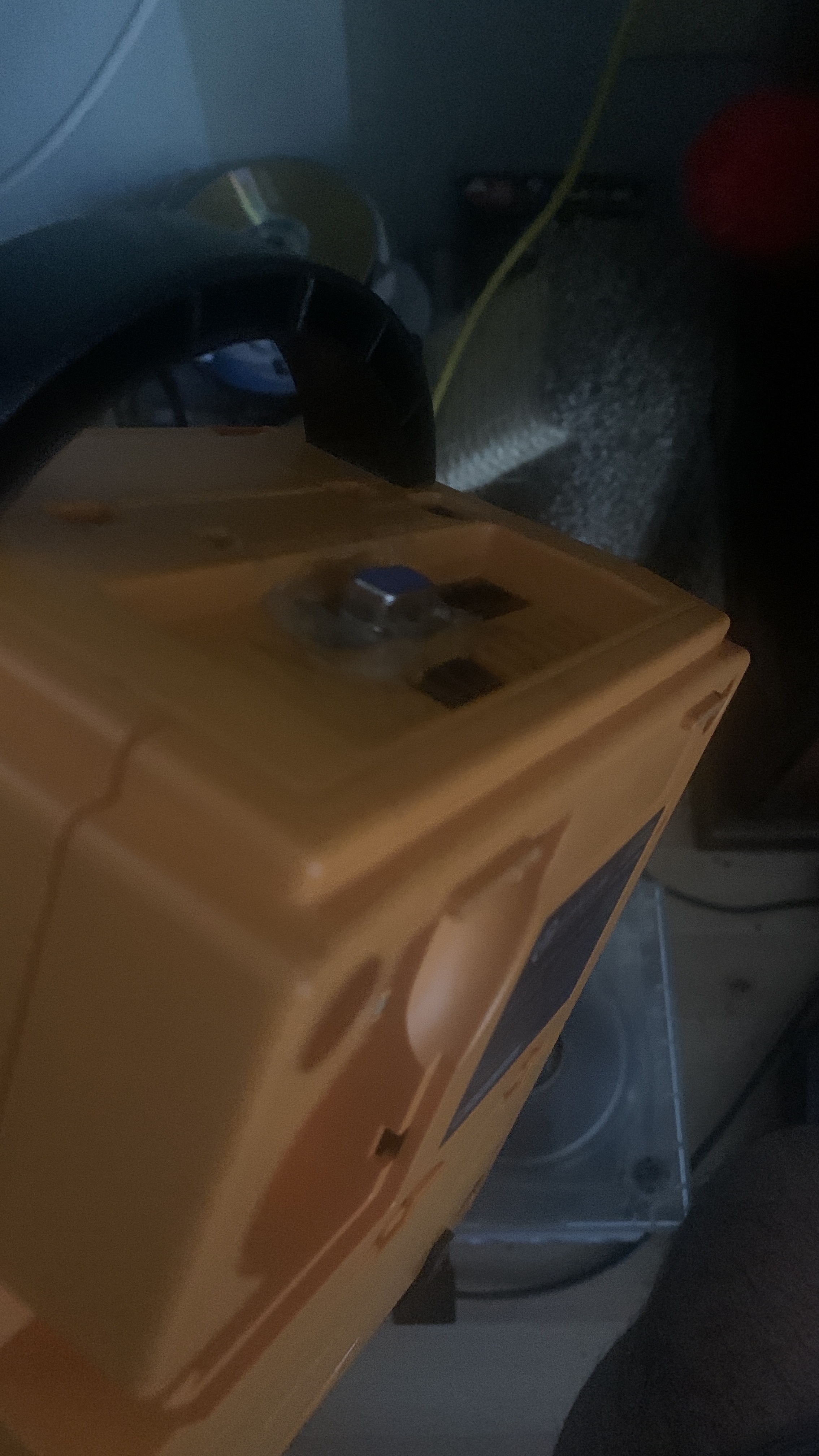

(1.76 MiB) Not downloaded yet
(1.95 MiB) Not downloaded yet
(1.77 MiB) Not downloaded yet

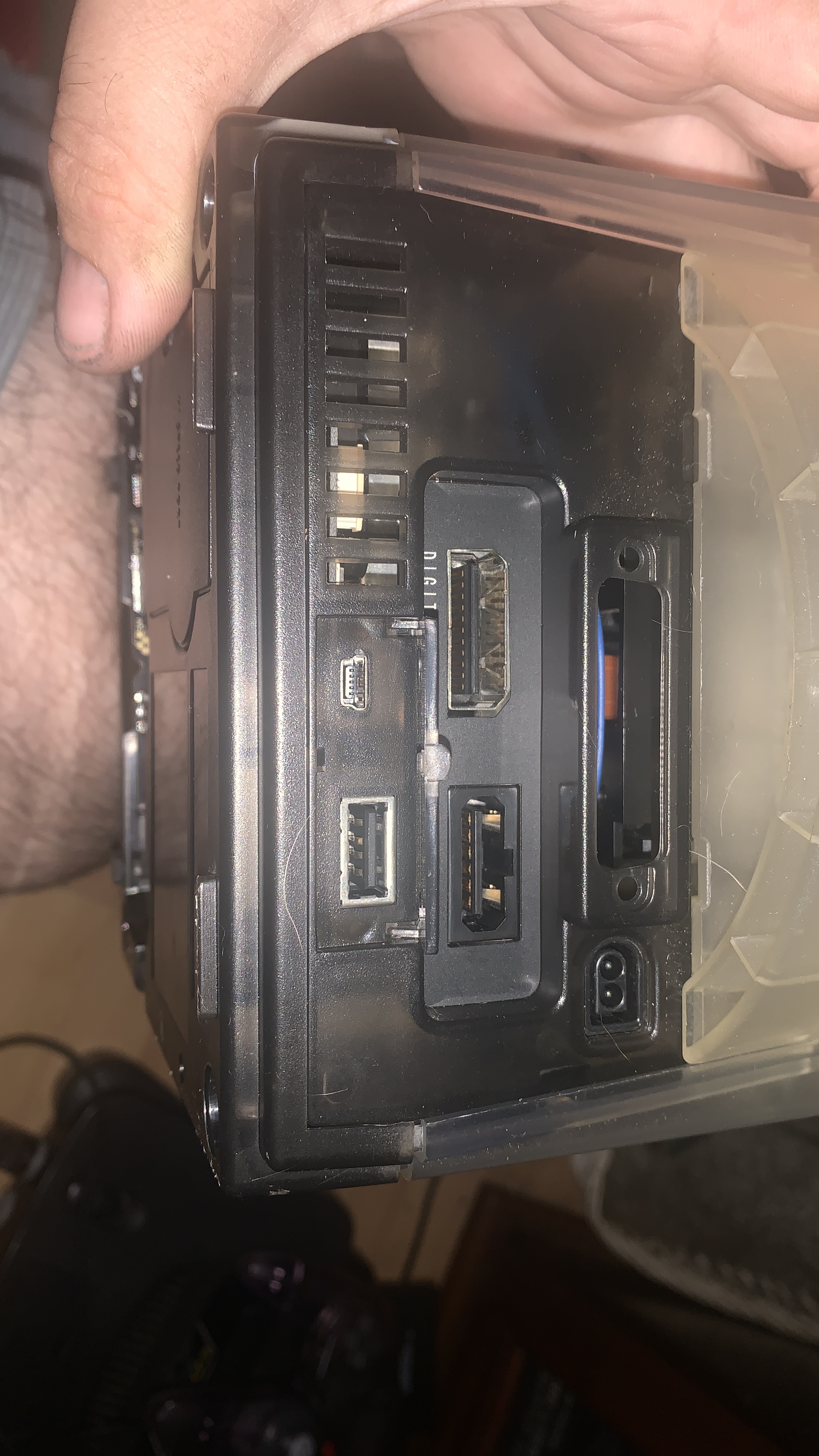

If these is the USB ports your talking about which is part of the viper gc case then no it won’t work as far as I can tell you I’ve never used them because I have a viper programmer so I never saw the point of them since well it’s a viper gc case not a qoob case and also the plug is different then the viper extreme so I figured it was for the viper 1st gen since I never seen one
