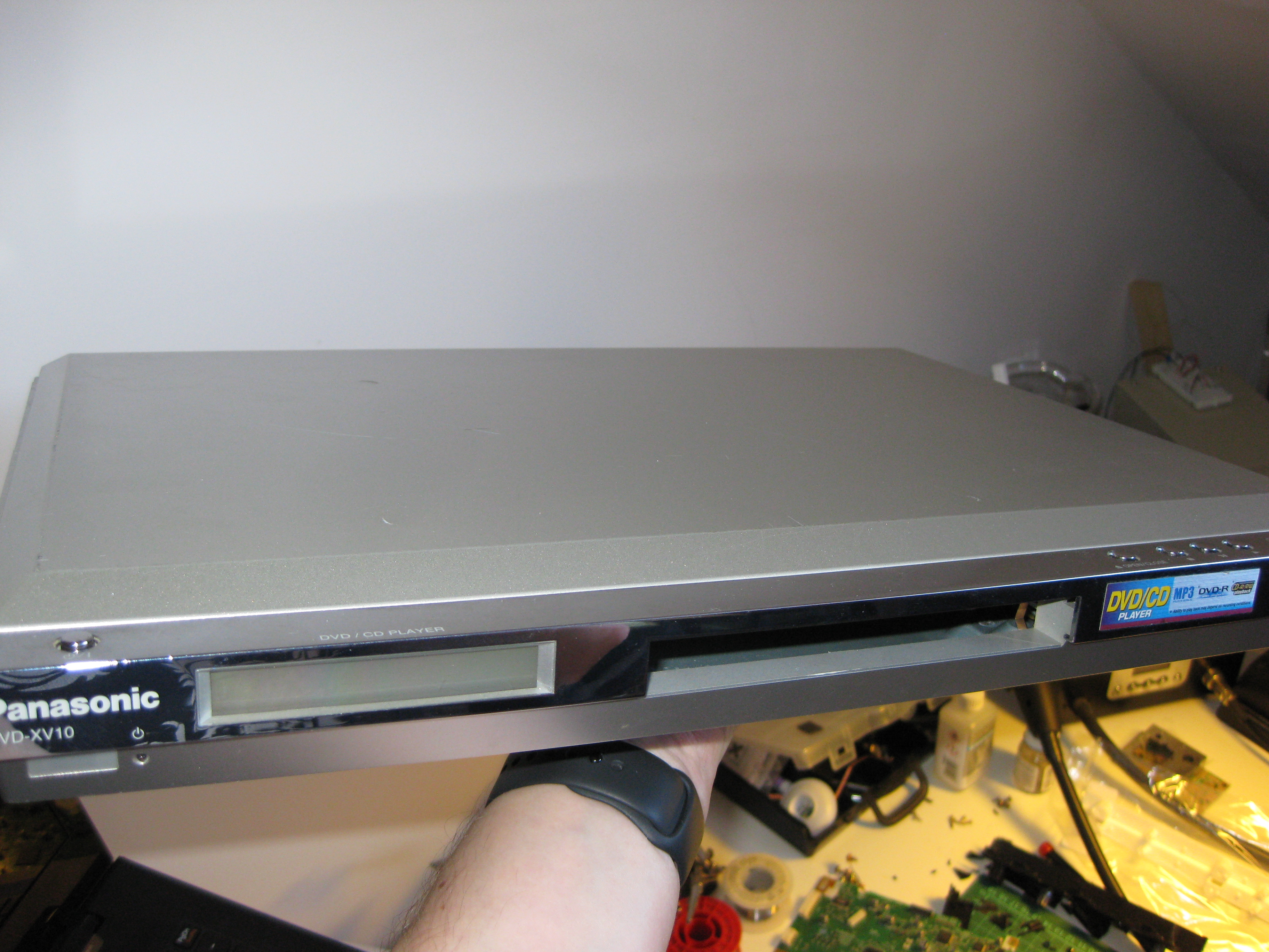

Anyway, whilst I was searching for a new laser assembly I discovered that the entire DVD assembly is shared with a Panasonic DVD player the DVD-XV10 in Europe and the DVD-XP30 DVD-XP50 in Japan and I presume America.

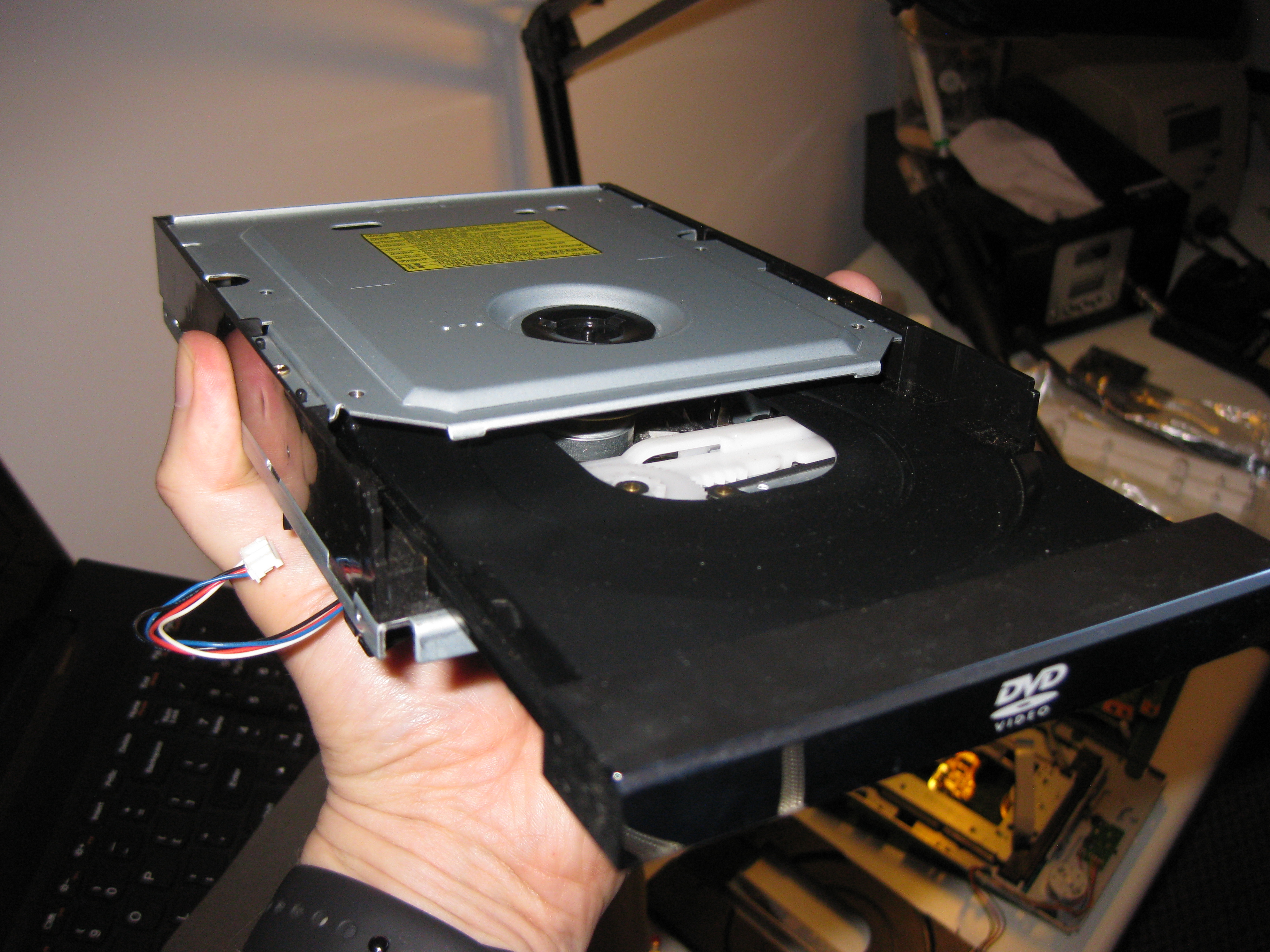

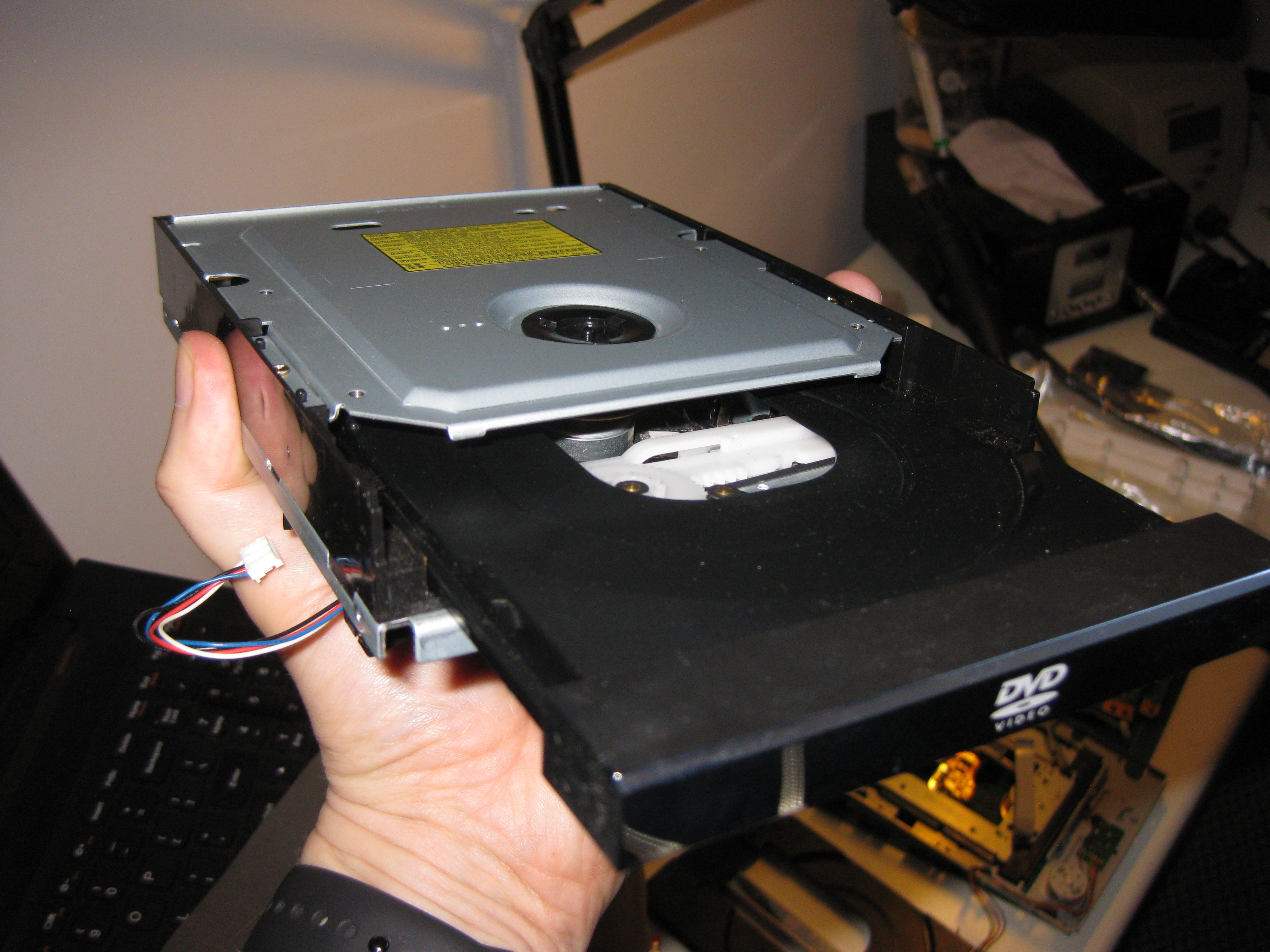

I picked up DVD-XV10 from fleabay and took it out. And YES it is exactly the same drive as the Panasonic Q.

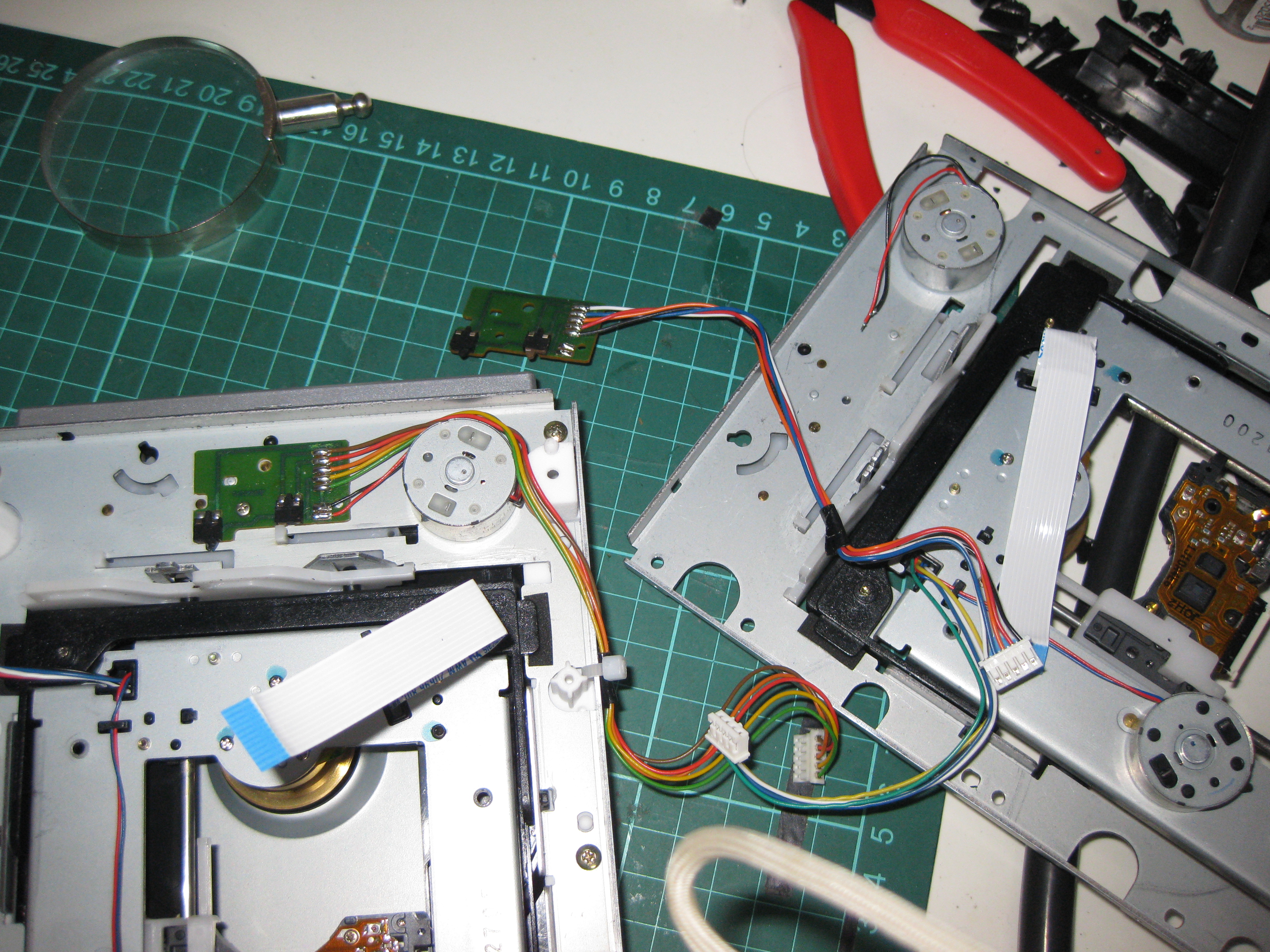

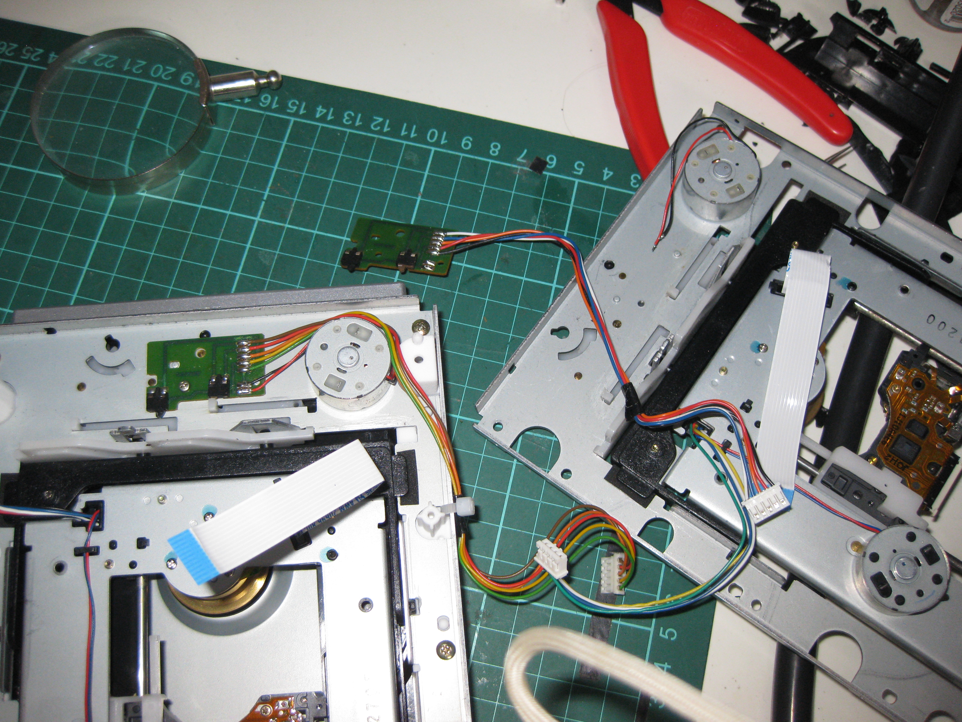

There are other things to take into account if you are doing a drive swap like me. The opening mechanism switch assembly needs to be desoldered and swapped out to accommodate the longer wires from the Q.
Needless to say the swap was a complete success. and After adjusting the laser pots to match the original drive it plays both DVDs and Gamecube games perfectly.
Swap the tray switch
The DVD Drive
The Doner Machine
