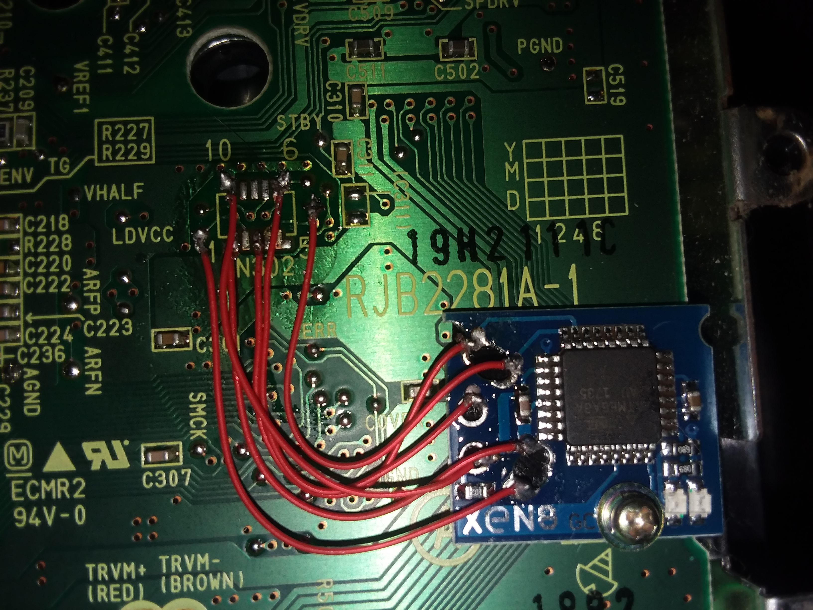

Post by boredomca » Sun Jul 01, 2018 5:45 pm
Check for shorts, even a small amount of unseen solder can cause problems, a cheap mulitmeter can test for this.
Use electrical tape on the under side of the chip 'after soldering' to not cause a short on the board as well.
This is how I do installs for reference
(2.47 MiB) Not downloaded yet
Posts: 4972
Re: GameCube laser keeps clicking and doesn't read the discs
Post by emu_kidid » Wed Jul 04, 2018 8:11 am
boredomca wrote: Sun Jul 01, 2018 5:45 pm even a small amount of unseen solder can cause problems
Look at the CN302 pin 6 wire you've put, it has some solder on the shielding of the wire which looks like it could come loose at any time.
Post by boredomca » Fri Jul 06, 2018 9:24 pm
My point exactly. It's all cleaned up though and flux removed also so don't worry
