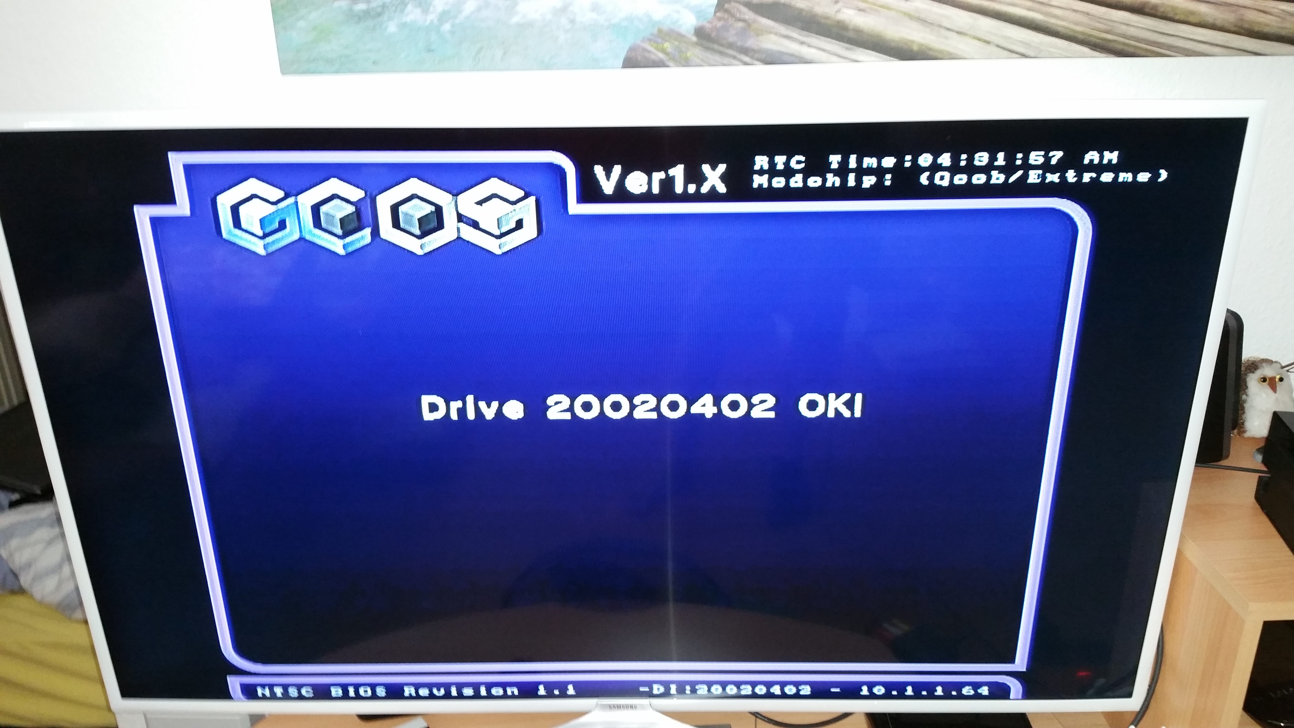

I just did want to load a backup of Mario Sunshine on my gamecube via DVD-R. If I load the game with swiss the screen goes black. If I load it with gcos the following text message appears. (Look at the pictures!)

You've burnt the ISO as a file on the disk, that's not going to work with GCOS or Swiss. Burn the ISO as an image using ImgBurn or something.
