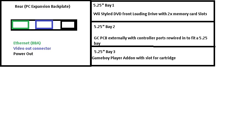

First time poster here, long time lurker. Out of the off chance this is even possible (time commitment and difficulty not be an issue, unless this is literally impossible without knowledge of something difficult to access such as direct knowledge of the GC pcb design or the like); I was wondering to do this mod, and was wondering if anyone has any links to articles, information, critique/constructive criticism on the idea (Not practical at all but something i have been wanting to do).
Essentially what I wish to do is to put a Gamecube, with the BBA, GB Player, a Qoob Pro Mod-chip, and if possible (replace the traditional GC top disc drive, with a Wii styled front loading drive); and shove the entire mess into a custom build pc case's (already sorta conceptually designed) 5.25" bays (if this is probable it would most likely be 2 or 3 5.25" bays.
The case is designed with traditional PC expansion slots in the rear in mind, so what I am intending to do is:
-Place a Wii front loading disc drive, 2x memory card slots, and game boy player adapter, and place them in their own enclosed 2-3 5.25" bays (possibly shove (if WII styled disc drive) and memory cards in one 5.25" , main board in another, and GC Player/bottom connectors in the lower 5.25" bay.
-rewire power and video out to a PC back-plate expansion style port to plug directly into wall/monitor
-rewire GC expansion port with BBA plugged in to port to the same slot back-plate as video/power
-Have the Qoob pro setup as standard, BUT have the chip's USB connector to be directly plugged into a mini USB-USB bridge, which would lead a single wire to a motherboard internal USB port.
Anyways, the entire project seems like a rewiring train wreck, but would save some space than having my GC be on my table near my monitor (I know they're pretty small, but I have bad OCD :P )
download/file.php?mode=view&id=2248
,Please add any inputs or criticism, thank you :D
(46.49 KiB) Not downloaded yet

Wouldn't this make the whole thing bigger than the actual gamecube is? Don't get me wrong, the idea of a custom gamecube pc case sounds nice, but can't see how it will save space over just using a gamecube itself...

You could probably do it in 2x5.25 bays with a Wii drive...
Top 5.25 layer:
Use something like a Megadrive v3/5/6 and use a Wii DVD Drive instead of a WASP
Bottom 5.25 layer:
Upside down GC mainboard so that the BBA and GBP can plug in without modification and so you can mount a huge 120mm (but low rpm) fan on the heatsink to cool the thing.

emu_kidid wrote:You could probably do it in 2x5.25 bays with a Wii drive...
... and so you can mount a huge 120mm (but low rpm) fan on the heatsink to cool the thing.
Low rpm = less than 2000. An 80 or 92mm fan should work perfectly fine, just don't skimp on it and get a quality brand like Noctua.

It will essentially be a glorified version (hopefully) of : http://assemblergames.com/l/threads/my- ... ion.54889/
However, with my own personal modifications and whatnot. Completely forgot MegaDrive existed, so thank you for that! :)
