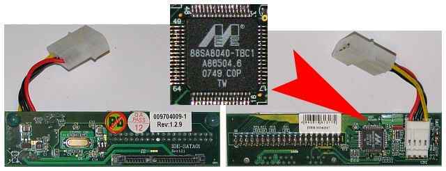

I've seen people recommend Delock converters
http://www.delock.com/produkte/gruppen/ ... 61702.html
http://www.amazon.co.uk/Delock-Konverte ... 121&sr=8-1
or others with the same Marvell 88SA8040 chip for the ps2 NAD so it should work fine with the IDE EXI too.
http://www.newegg.com/Product/Product.a ... 6812200156
http://www.system-talks.co.jp/product/sata-tr150vh.htm
http://www.system-talks.co.jp/product/sata-tr2535.htm

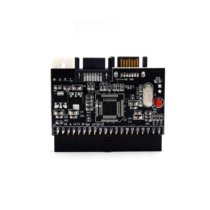

I have just made an order from china, and this IDE-SATA adapter is included:
Very cheap price so, not expecting it to be perfect. I will post with how well it is, when my order arrives.
https://www.dealextreme.com/p/40-pin-id ... card-29745
- (64 KiB) Not downloaded yet
Re: Recommended SATA -> IDE Adapters
i have one from ebay that looks reeeeally similar, and that doesnt even power on the harddiskJaecus wrote:I have just made an order from china, and this IDE-SATA adapter is included:
[img]
haha ok, i'll be expecting the worste then.

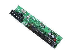

I'm using these one: Kingwin ADP-06 SATA to IDE Bridge Board Adapter
it cost usd 10 plus other usd 10 for shipping in eBay

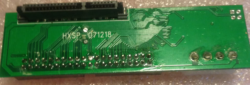

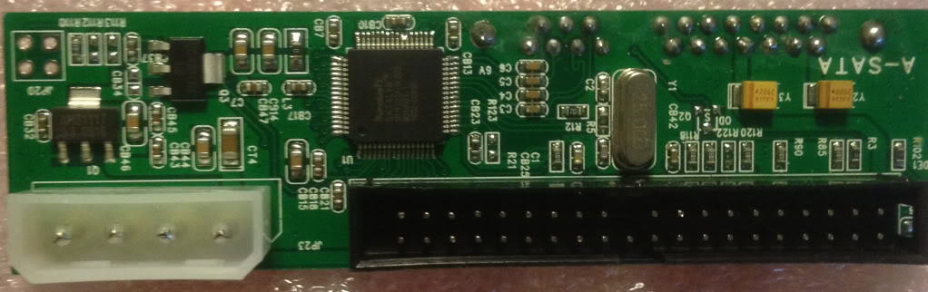

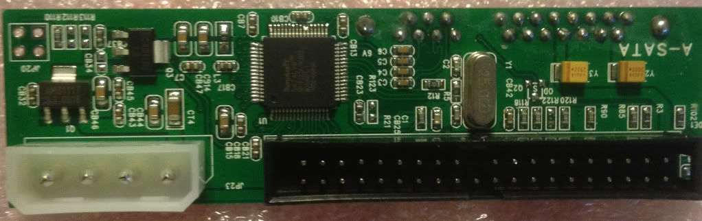

I have tested a few adapters from eBay with SunPlus SPIF223A bridge chips and they work without a problem.
Edit: Here is a picture of one of the working adapter.
