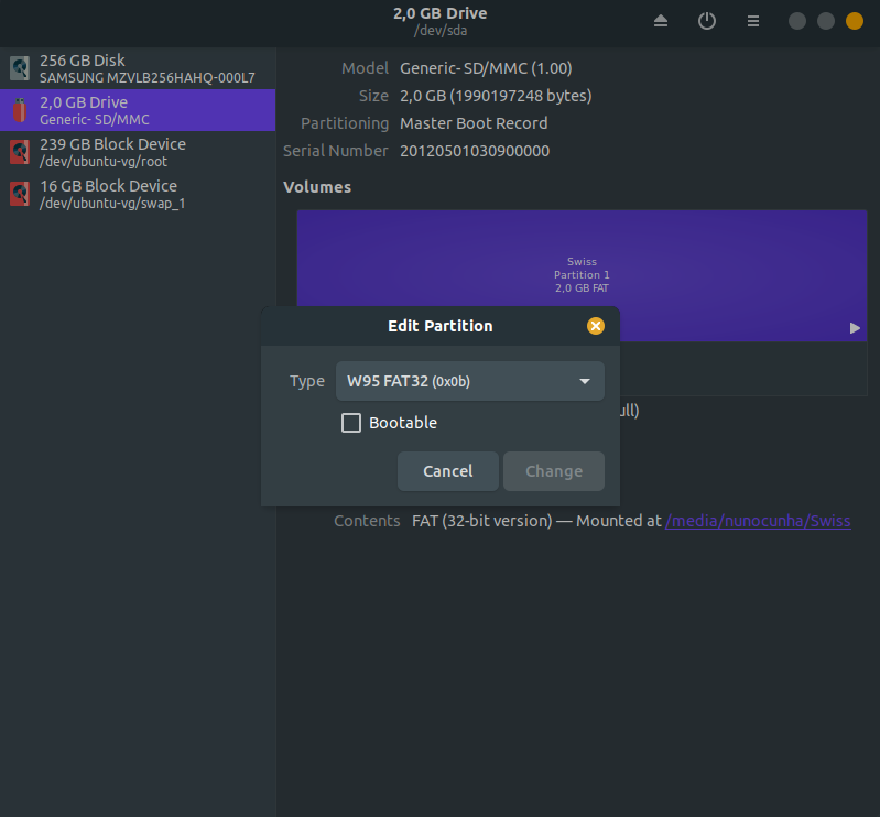

tox1k
Joined: Mon Jun 29, 2020 2:16 pm
Re: SD MEDIA LAUNCHER won't start
Post by tox1k » Mon Jun 29, 2020 2:24 pm
Hello, i formatted with default FAT32 but it didn't work. Later I changed for this configuration W95 FAT32 (0x0b). As seen in the screenshot.
(70.17 KiB) Not downloaded yet
