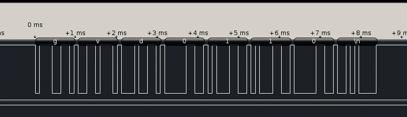

Hrmm, I think the chips I received are FT232RLs disguised as FT245RLs (as that is stated on the package). I had a look at the datasheet from the FT232RLs. The FT232RL is a USB to serial converter, meaning it will output the data you send to it over a single pin with the well known serial protocol. The FT245RL will just place the data you send parallel on 8 pins and you need to provide read signals yourself to retrieve the next data.
Pin 1 of the FT232RL is the TXD pin. I probed this pin on the "FT245RL" with my logic analyzer and what I get seems to be serial data and also exactly what I sent:
I tried FT Prog with Windows and when I read the FT245RL it says the device type is 'FT232R'. Does it say that for you as well, Streetwalker? Because if it says it is a FT245R for you, then I guess that will settle the matter.
Still, I do not get how someone would think it is a good idea to package FT232RLs as FT245RLs. :?

Post by novenary » Sun Nov 01, 2015 12:18 pm
Sure enough :
Looks like you got scammed by the chinese. :/
