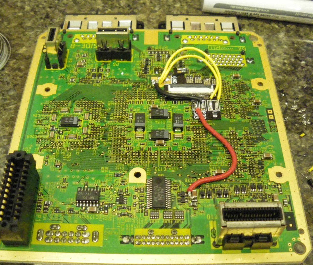

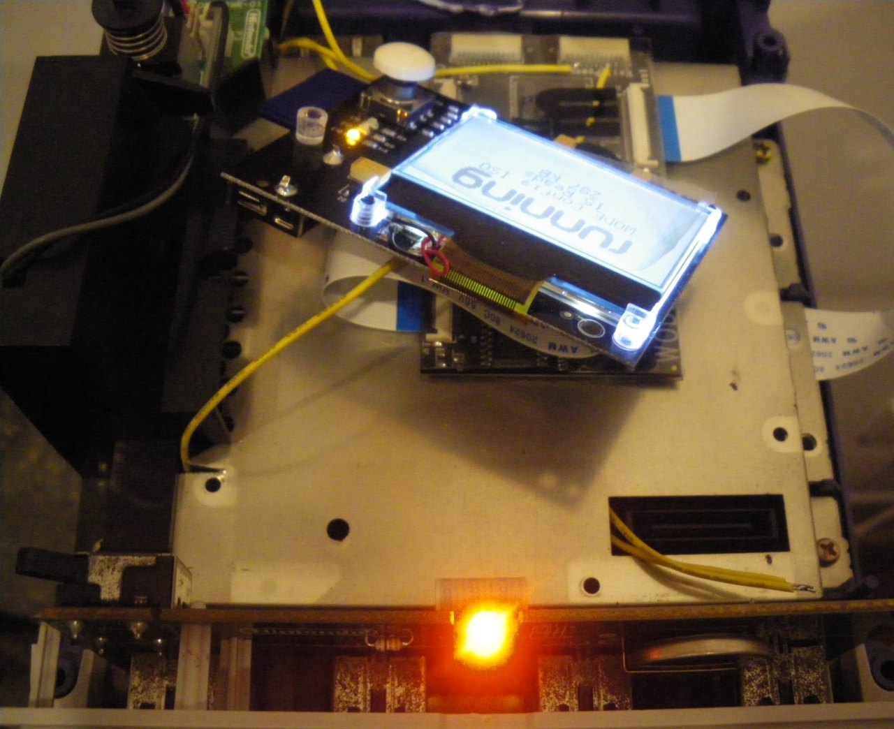

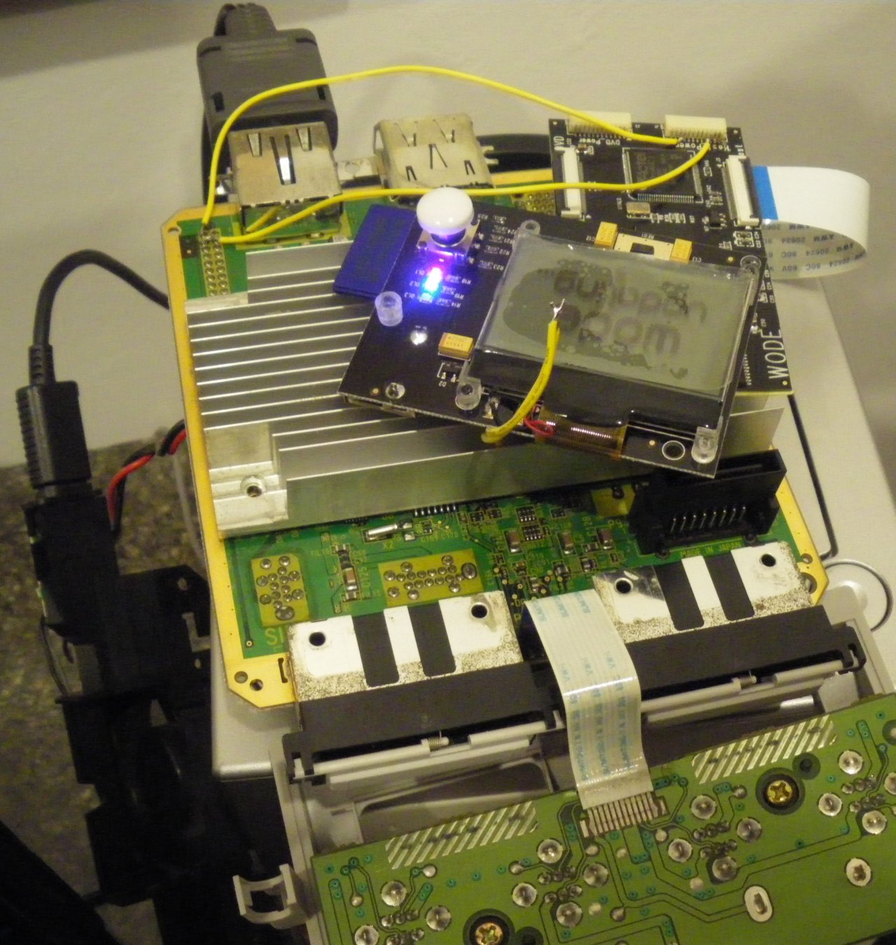

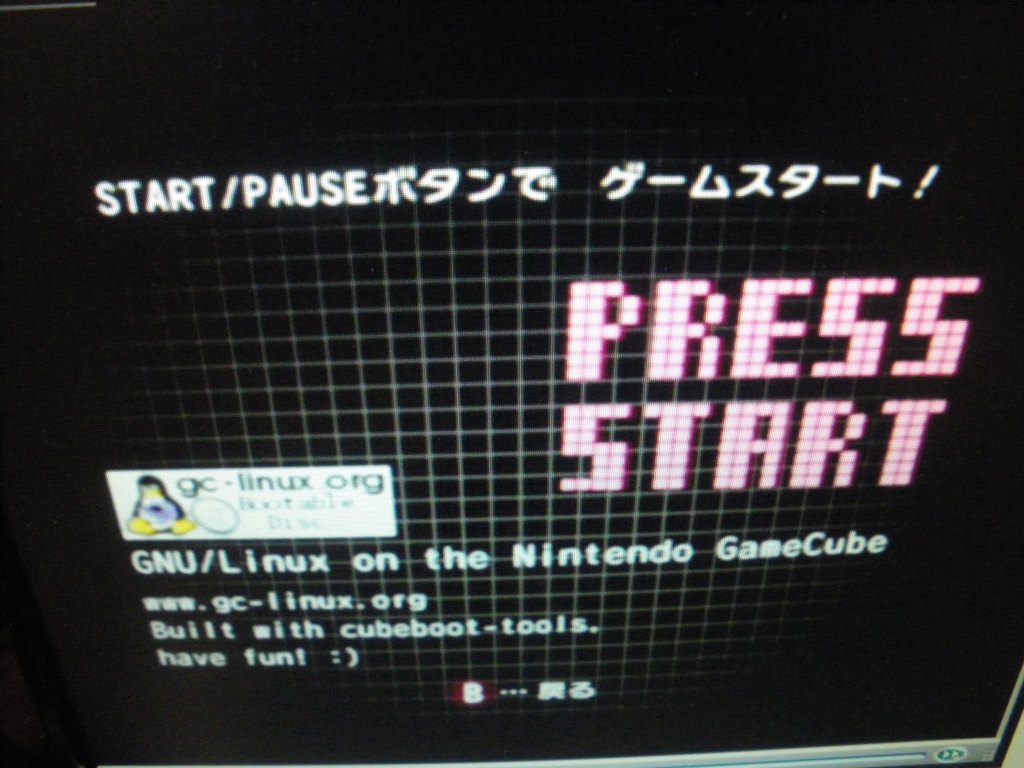

Here's some pictures I took of my WODE + V6 I put into a NTSC-J 1.0 recently. The V6 is a pain without proper tools
Pictures:
Wired up, with lid wires pointlessly going to the top (through the hole) in case I decide to use a switch
It works!
Config loaded, case re-assembled mostly...
Config in the IPL

i performed some mods to my setup...
here is the current status:
i think i now have WASP 100% functional with the DVD drive still connected...
DVD drive appears mostly functional with WASP connected but still a bit buggy at times...
im not sure a new custom PCB can provide any simple solution for this mod...i need to keep playing with this setup and see what options are available to make this easier or maybe less confusing...
hopefully this can be a mod anyone willing to try should be able to perform...
of course still the most tricky part will be connecting a WKF/WASP to the GC, there is no way to make this any easier than it already is with MEGAdrive...but it looks like V6 might have to be used since V5 will not work in this setup...
