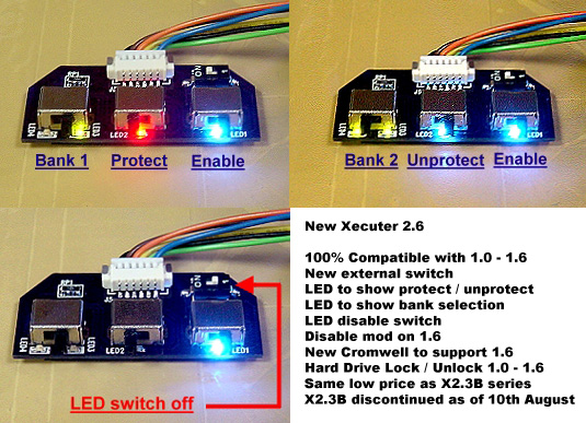

It should have the option for 2x 512k BIOS, dip switch selectable, if I'm not mistaken, are they both blank?
Madowax
Posts: 9
Joined: Thu Jun 11, 2015 2:09 am
Location: Italy
Re: how to flash Xecuter 2.6 CE without programmer
Post by Madowax » Wed Jul 01, 2015 1:48 am
(122.83 KiB) Not downloaded yet
