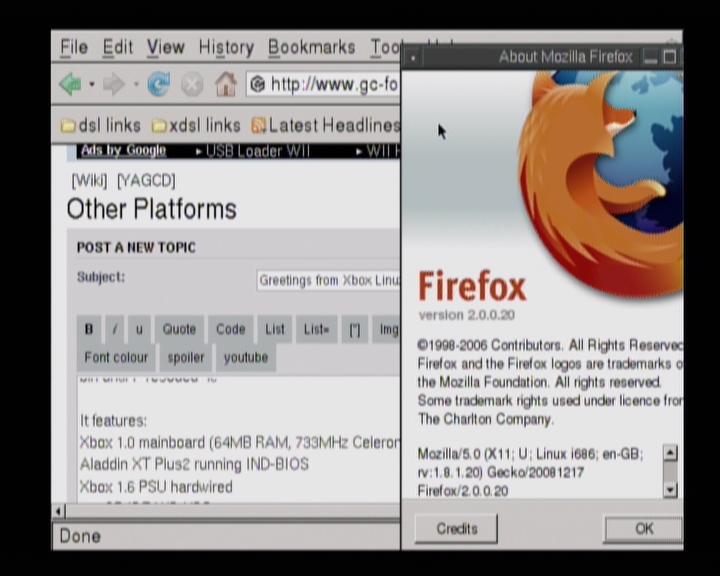

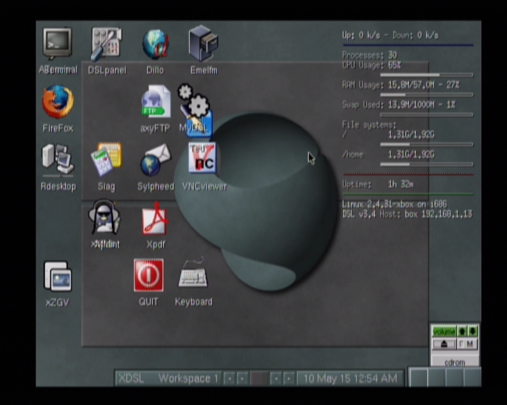

Hi all,
I'm just writing to you from a original xbox that was headed for the bin until I "rescued" it.
It features:
Xbox 1.0 mainboard (64MB RAM, 733MHz Celeron powah!)
Aladdin XT Plus2 running IND-BIOS
Xbox 1.6 PSU hardwired
120GB IDE WD HDD
2008 DVD RW IDE Drive (with custom split molex cable for power and external eject switch)
X-DSL aka Xbox Damn Small Linux
Upgraded linux as far as it'll allow me, but next time I might try the 2009 release of GentooX to see if it lets me do anything more than I currently can :)
Screenshots: (attached later from screen capture)
(462.85 KiB) Not downloaded yet

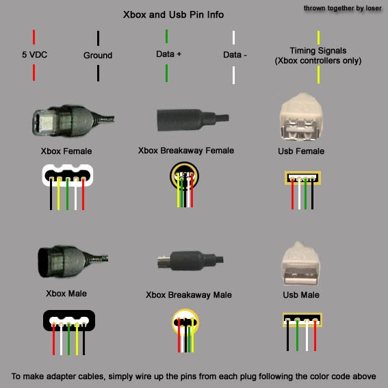

I wanted to ask you (since the xbox scene is dead) instead of buying one of those china made Xbox controller input to female USB connector for a USB stick can I just buy this:http://www.showmecables.com/product/USB ... Avcd8P8HAQ and solder it to say the wires going to port 3 of the xbox?

andre104623 wrote:I wanted to ask you (since the xbox scene is dead) instead of buying one of those china made Xbox controller input to female USB connector for a USB stick can I just buy this:http://www.showmecables.com/product/USB ... Avcd8P8HAQ and solder it to say the wires going to port 3 of the xbox?
Yes, google search for 'xbox usb mod -360' and you should see some info on it.

Thank you I found a very old diagram

Could you share this diagram please ?

Sure

Thank you !
