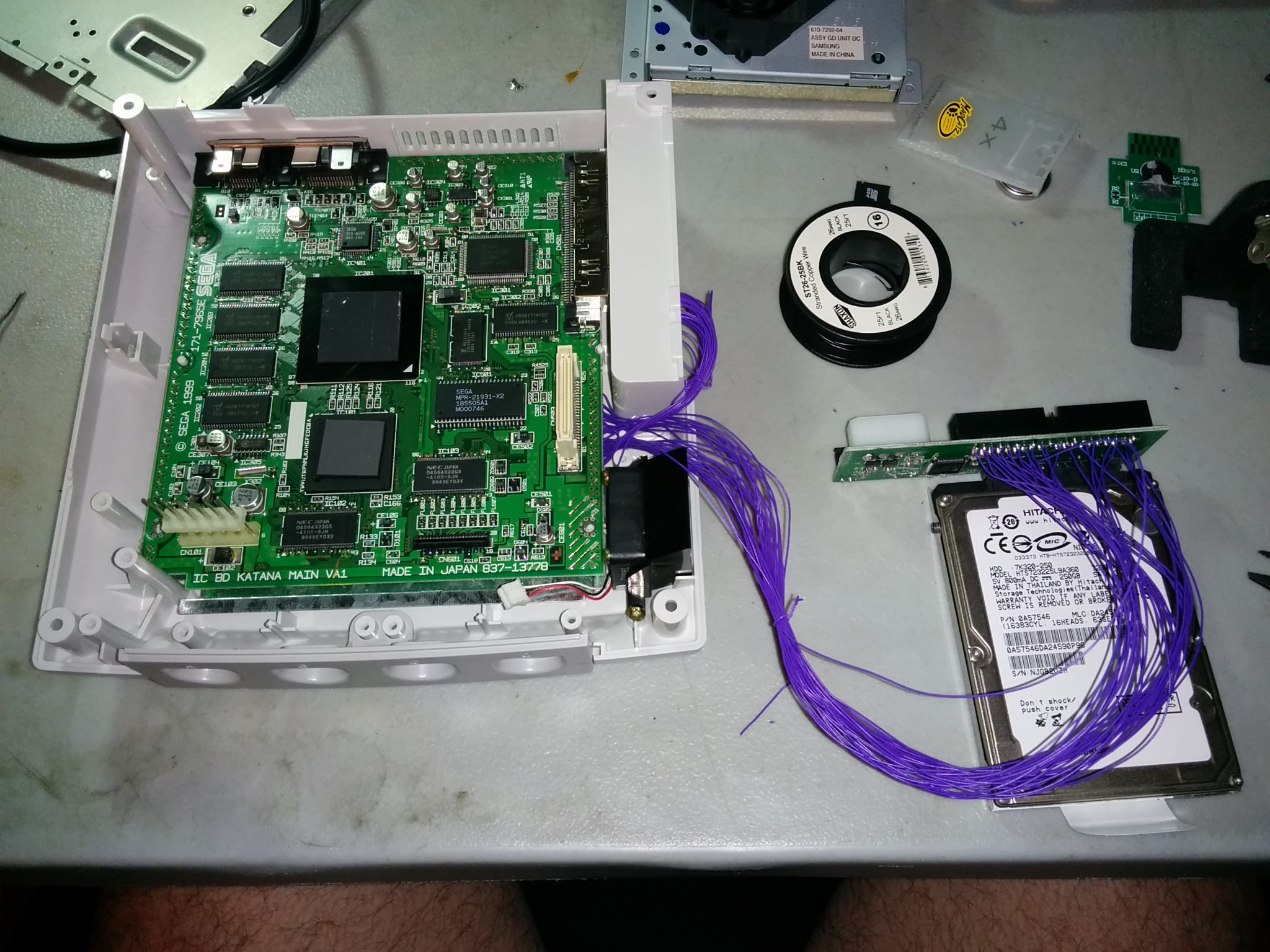

Working on a Dreamcast IDE connector.

please update on your progress, I've seen this interesting hack but noone I know actually built it yet... I am tempted to do it if it really works
Re: Dreamcast
Post by emu_kidid » Sun Jul 13, 2014 7:49 am
Yeah, is this the G1-ATA? I've thought about building one too, let us know how it goes. Will you still be able to use the drive?

Yeah from the little I've found the hard drive will be the slave and I will still need to boot the machine from the gdrom using the new release of dream Shell. I'm not sure about everything. I'm just following a pin out from a Russian page with the g1 ata I kept waiting for more info or a tutorial but I've got 4 Dreamcasts so I figured I'd wing it. But man it would be awesome if emu_kidd and megalomaniac got interested in this. I could see the "megadream" series of boards selling like crazy!

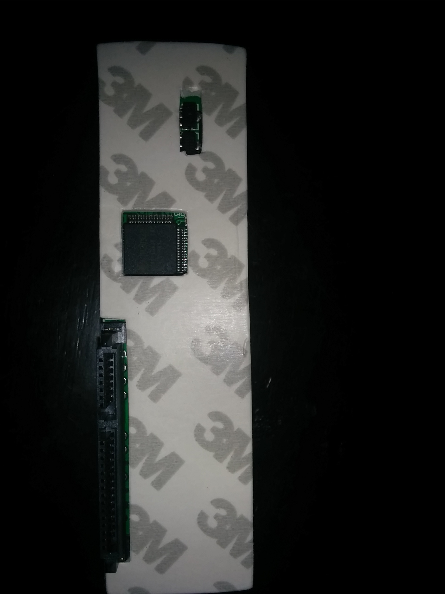

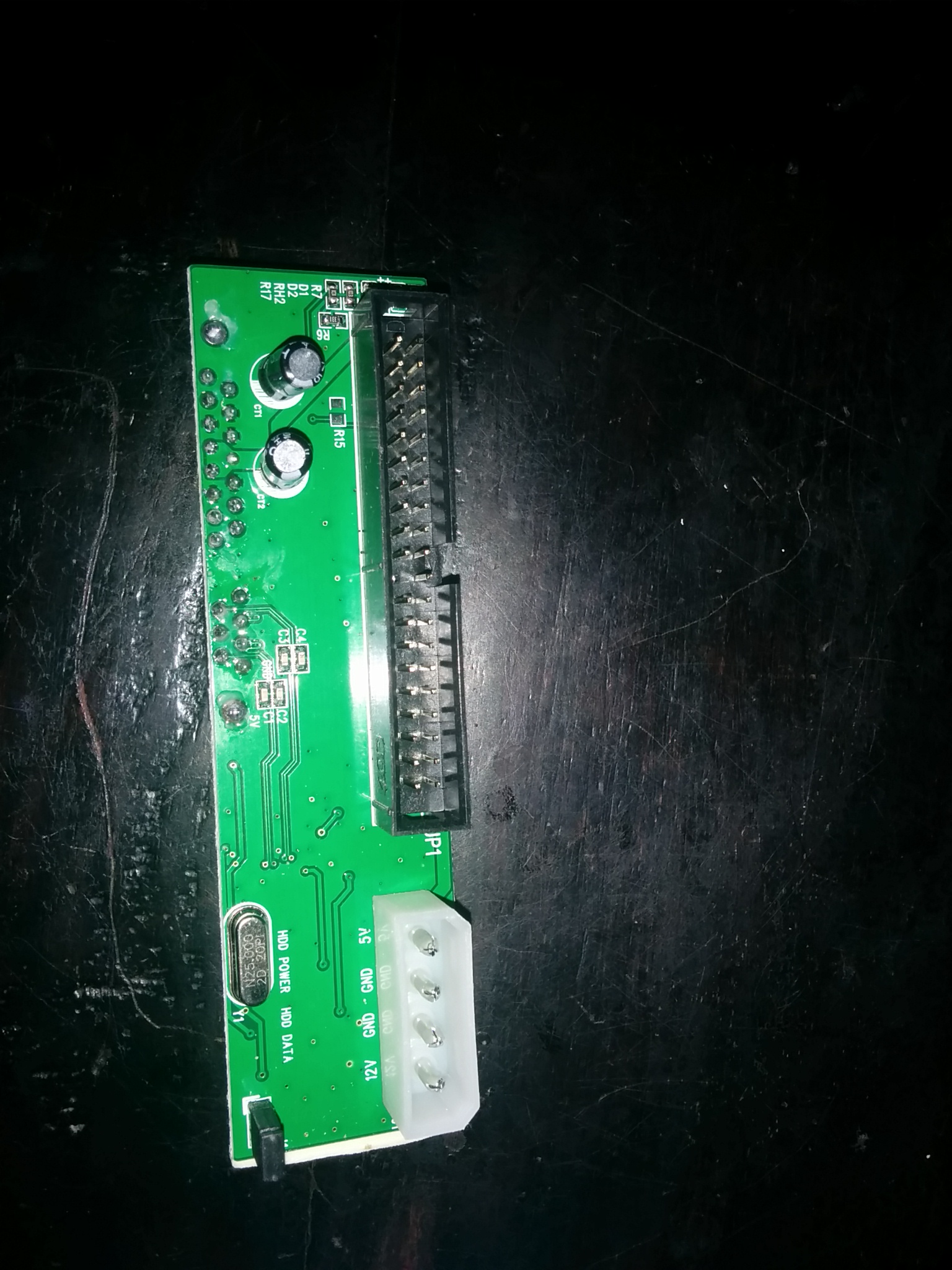

Okay so I'm back home and I got some parts in. I don't know if it will work but I figured I might as well go straight for something that will be sure to frustrate me. Got a cheap sata to ide adapter. Wish me luck.

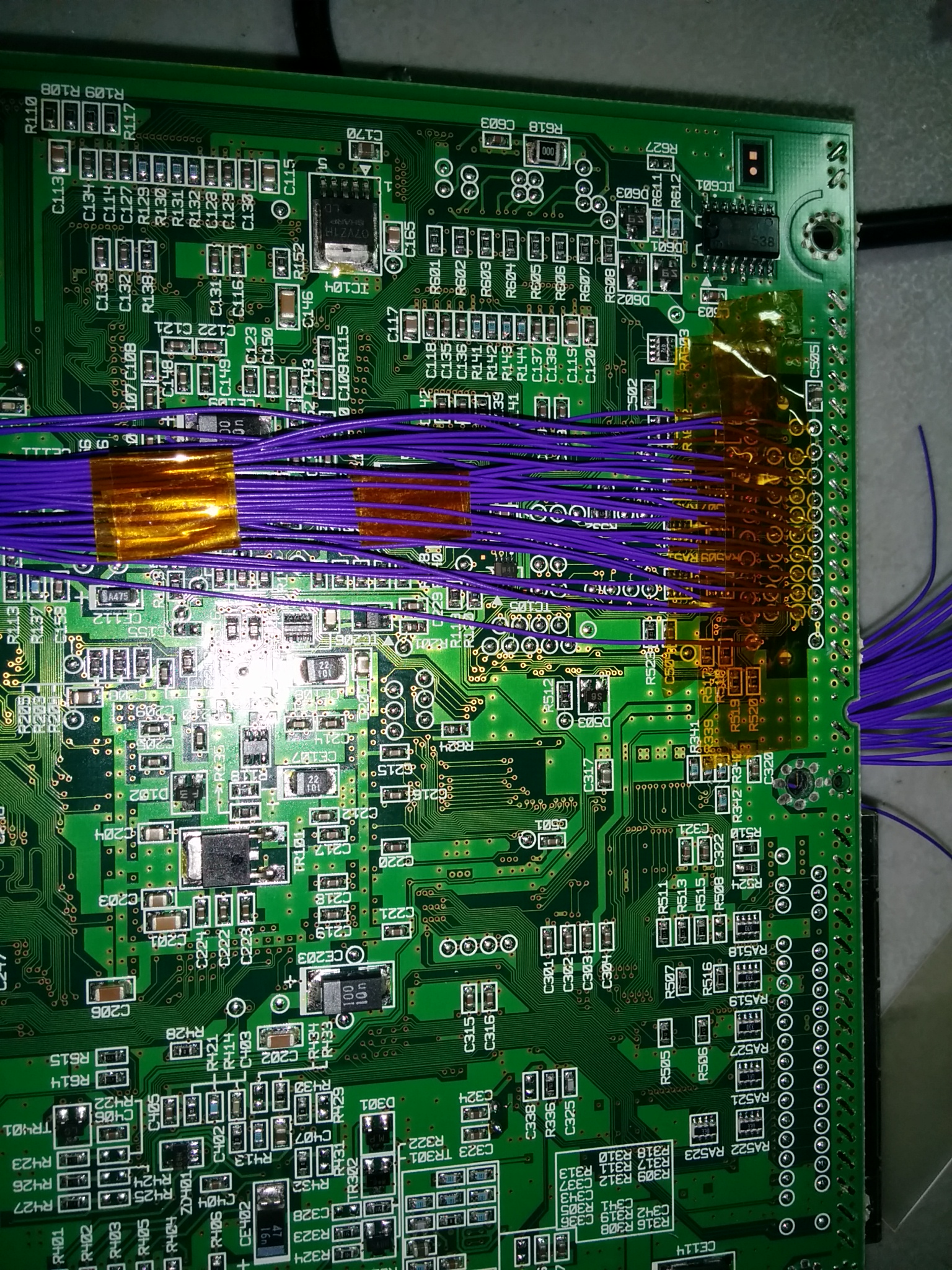

Okay so a little progress being made. I need to run power Tomorrow. And put it together and see what happens.

nice spaghetti monster :D can't wait to see if you get it working, it looks such a promising mod!

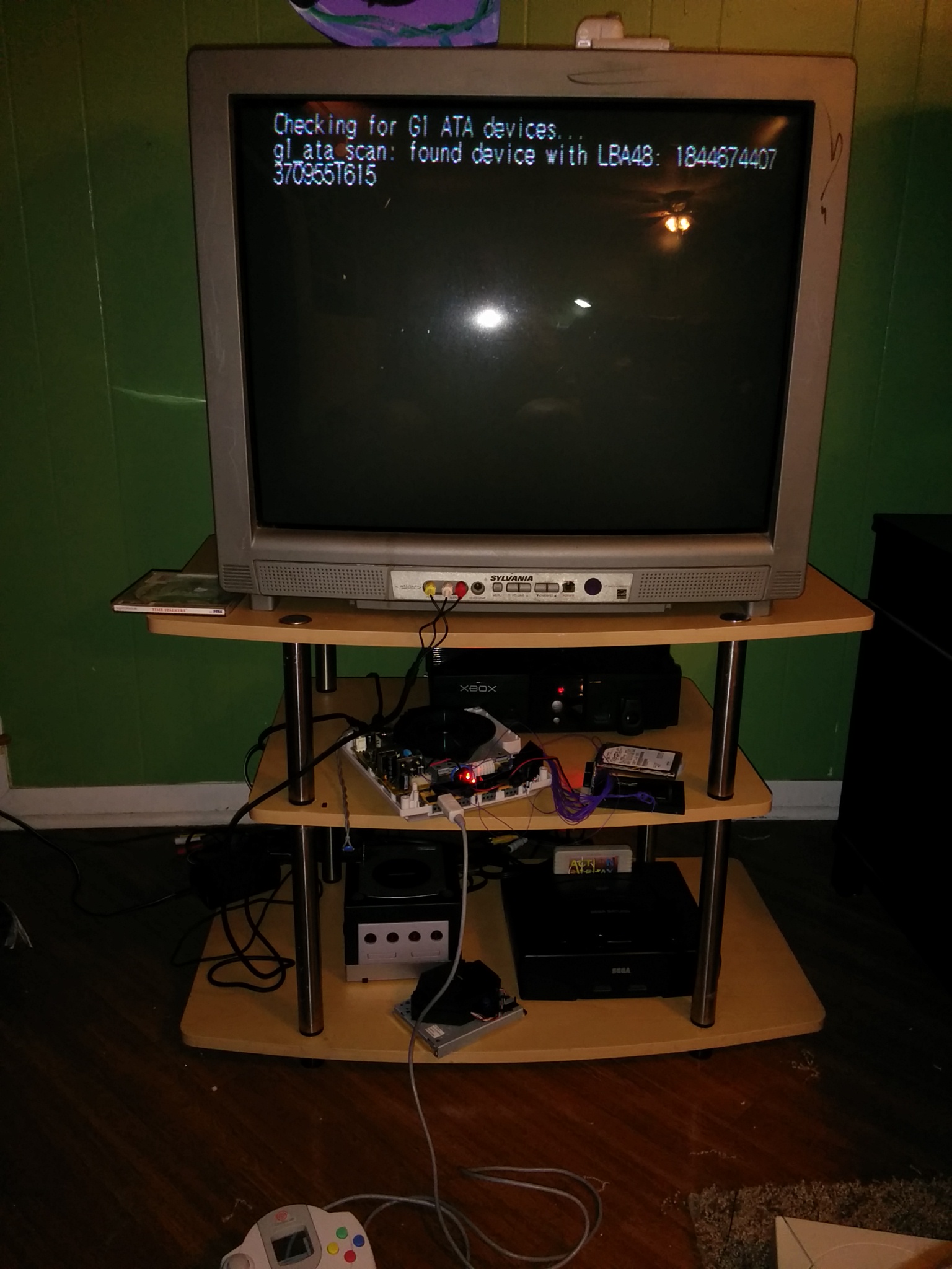

Okay so I specifically purchased a sata to ide that says it's capable of putting drive in slave mode. But now that I read reviews they all say the same thing. No slave mode! But when plugged in I do get a conflict. So something is happening. Tomorrow I'm going to switch to just and ide drive and cable.

are you sure you bought the right type of adapter?
SATA HDD > IDE adapter
not
IDE HDD > SATA adapter
here are links to the ones ive successfully tried:
http://www.ebay.com/itm/291162463308
http://www.ebay.com/itm/121385588661

yeah it is SATA HDD > IDE adapter and does work on my computer it's just that it can only be run as master I tried it with a dvd rom on the same cable and it only works when dvd rom is set to slave. But it was the cheapest one I could find so I wasn't expecting much.

You're going to have to pay a bit more for one that can do slave mode, only one I found that can do it was $20

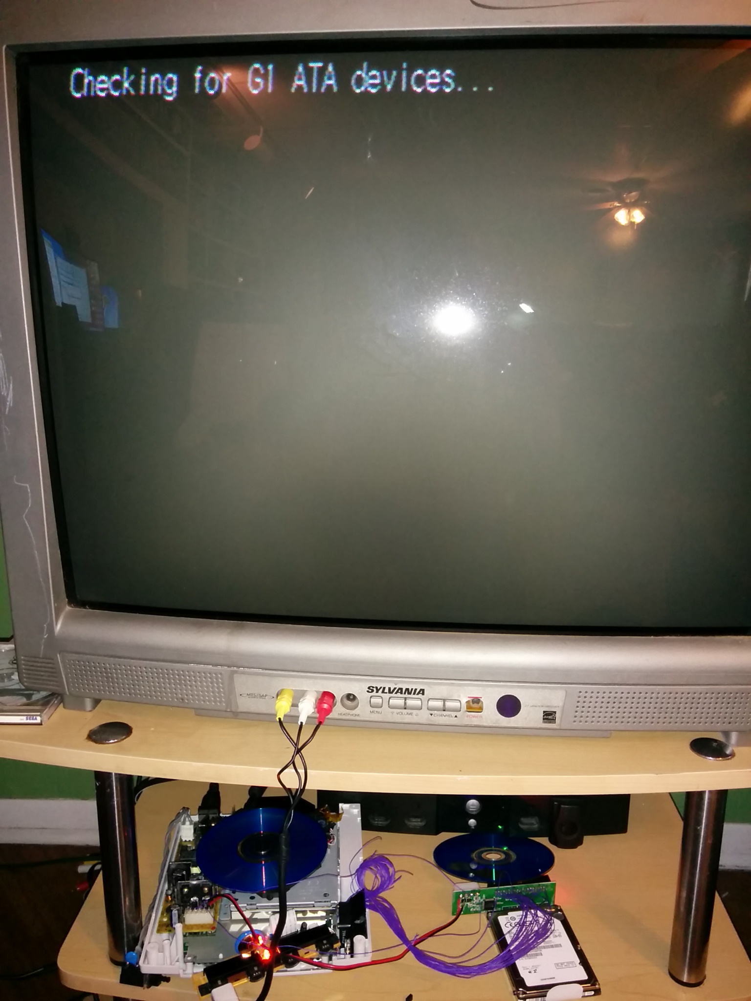

Well I got something at least. I finally found some docs on my adapter. I jumpered two pins and now dreamshell finds a drive! But it also locks up. I think for now I will go with an old ide drive and cable just to make sure it works before I spend money on another adapter.

Benni
Posts: 259
Re: Dreamcast
Post by Benni » Sun Jul 20, 2014 2:53 pm
There are a few more things...
First what happens if you remove the jumper???
is ist a master/slave Jumper or a master/CS Jumper?
Next:
The Chipset is also something to get your eyes on.
I tested a lot of those adapters on a XBOX CLASSIC.
the best is with marvell chipset - they are the fastest i found.
SOMETIMES the HDD is detected but tooo sloooowww.
The Box won´t but up.
MAYBE you have the same Prob - adapter to slow.

Thanks Benni for the advice, I didn't think about it maybe being cable select. If I change the jumper it does nothing. Since you brought it up in going to try it in my Xbox and see how it works. Do you have a specific adapter you can recommend that had worked well on Xbox?

Benni
Posts: 259
Re: Dreamcast
Post by Benni » Sun Jul 20, 2014 6:52 pm
Sorry, i´m from Germany, i think we have different kind of adapters (manufacturers)
So this is why i can´t give you an advice.
Mine all have a "MARVELL" Chipset, and of course JUMPERS!
SOMETIMES on a PIC you can see a Jumper BUT this is for a LED - so MAYBE your Jumper is also for an LED...
You must look if you can get a good pic to see if the jumpers are labeled, to see ich they can Master/Slave/CS!
