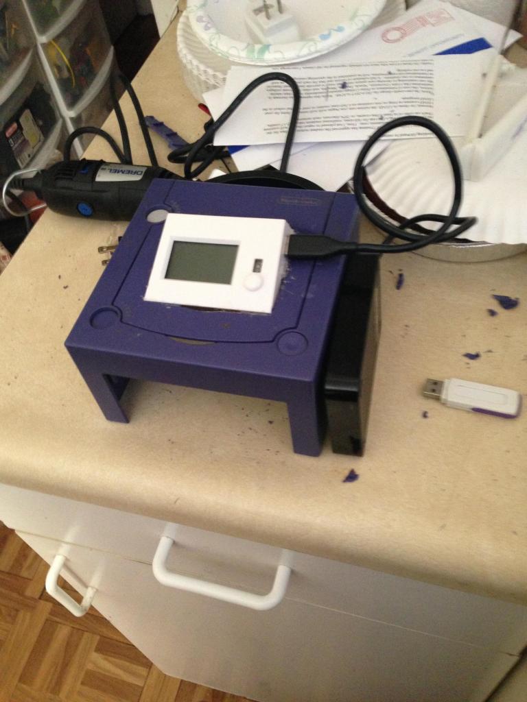

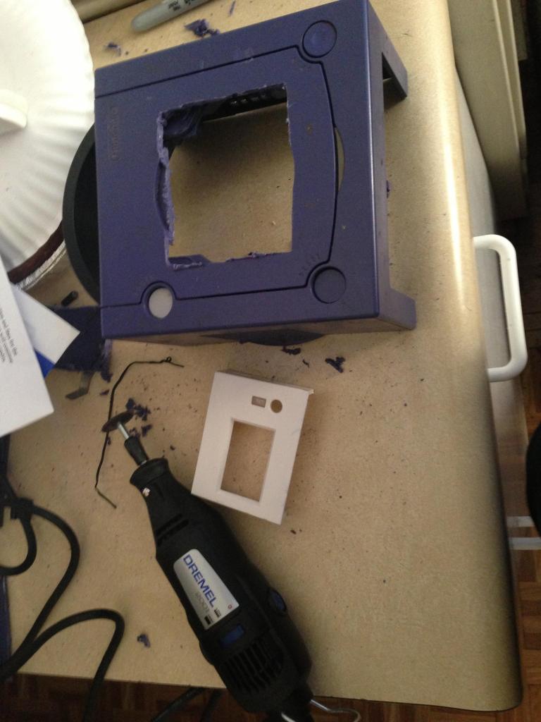

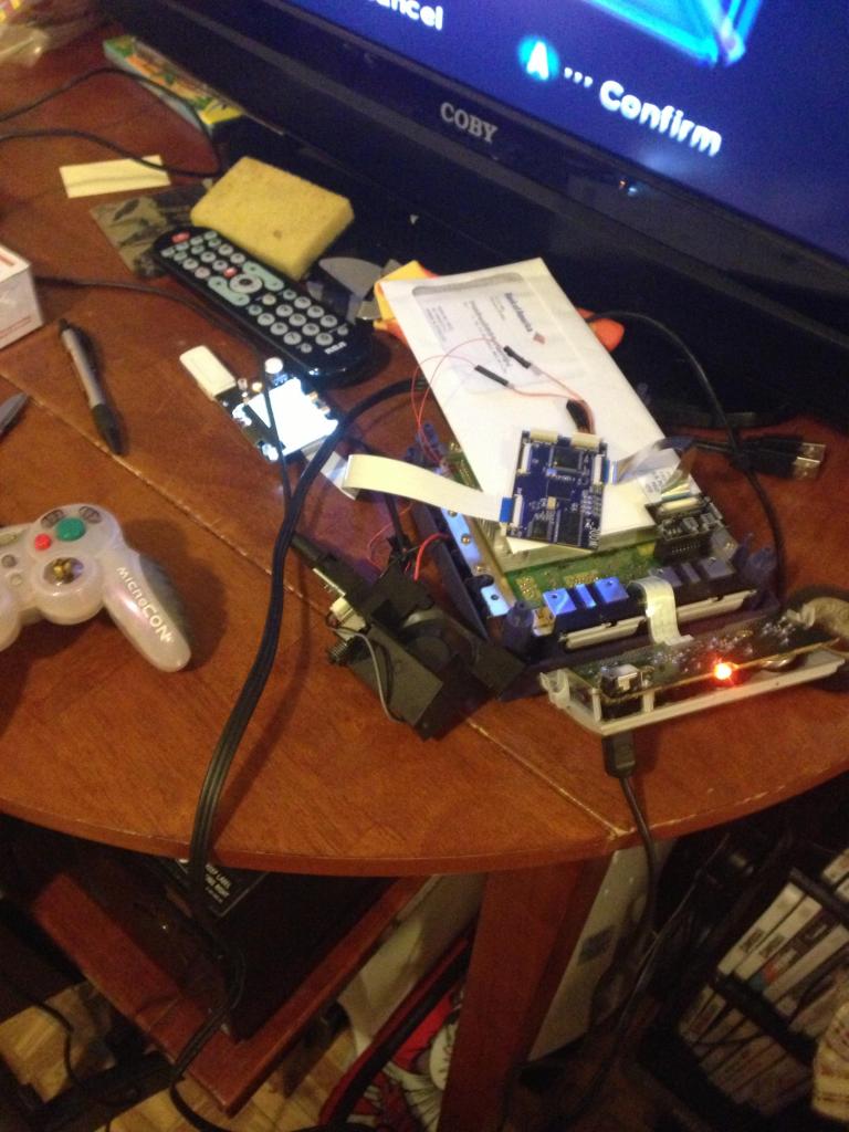

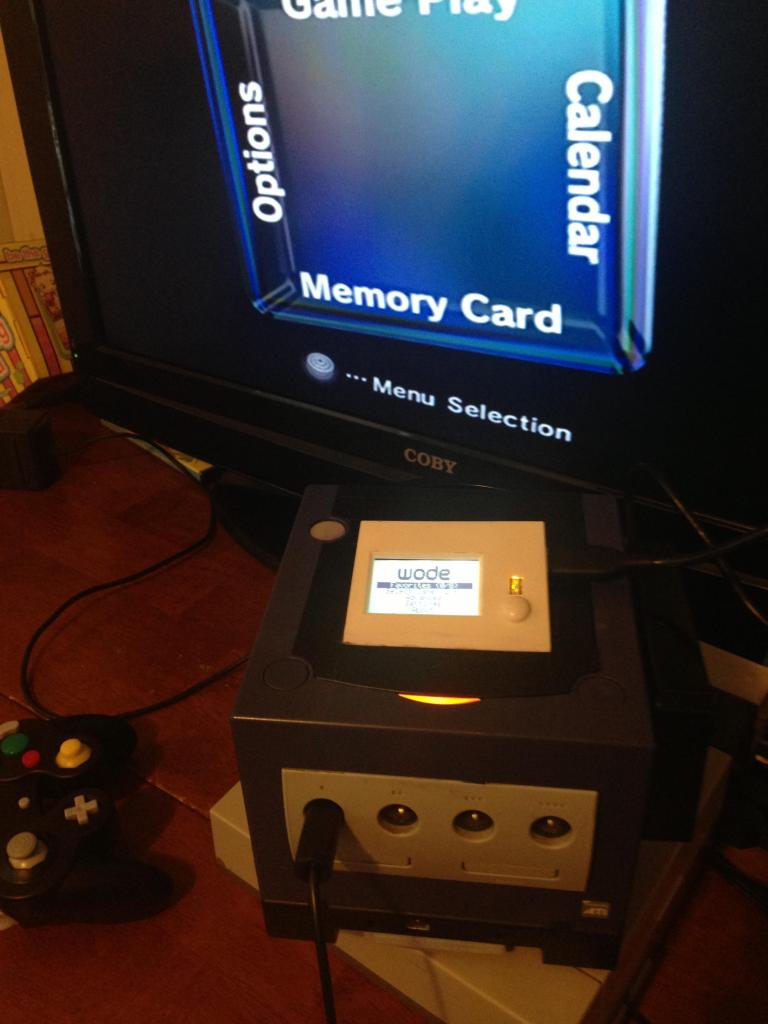

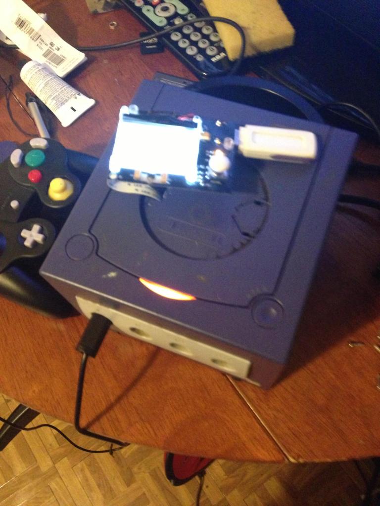

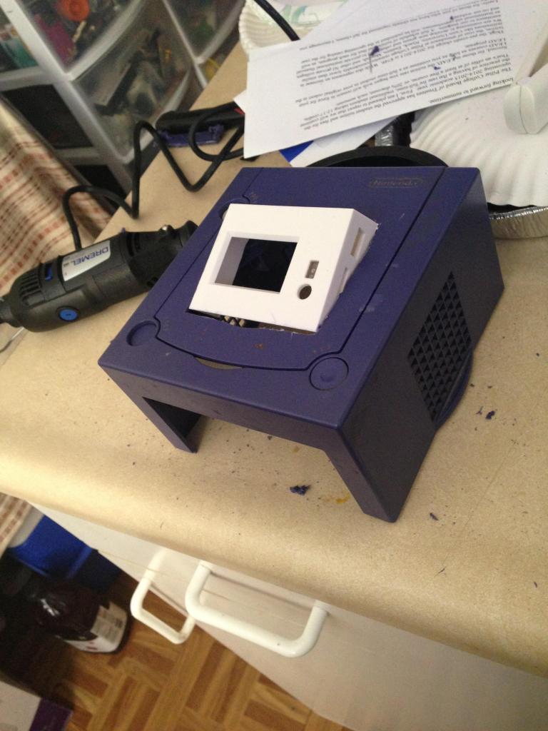

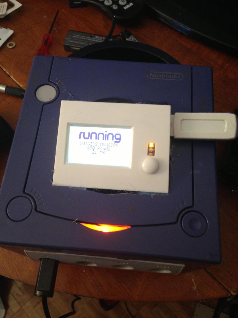

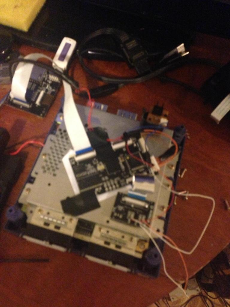

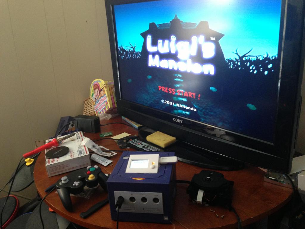

I have been following this forum for over a year and I am really amazed on what you guys have done. I bought a WODE. I wanted to do the same thing, but it did not work out has well. I mean I have completely destroyed 3 gamecube. Luckily, I have been finding them at thrifts stores for under 10$. I basically gave up until I saw the news for badassconsoles. I bought a mega v3 and I have to report, that it is too easy with that. it only took me 3 days from start to finish! It is my first completely finished one, so it is still a bit messy.
The beginning of the Dream.
A Big pile of mess

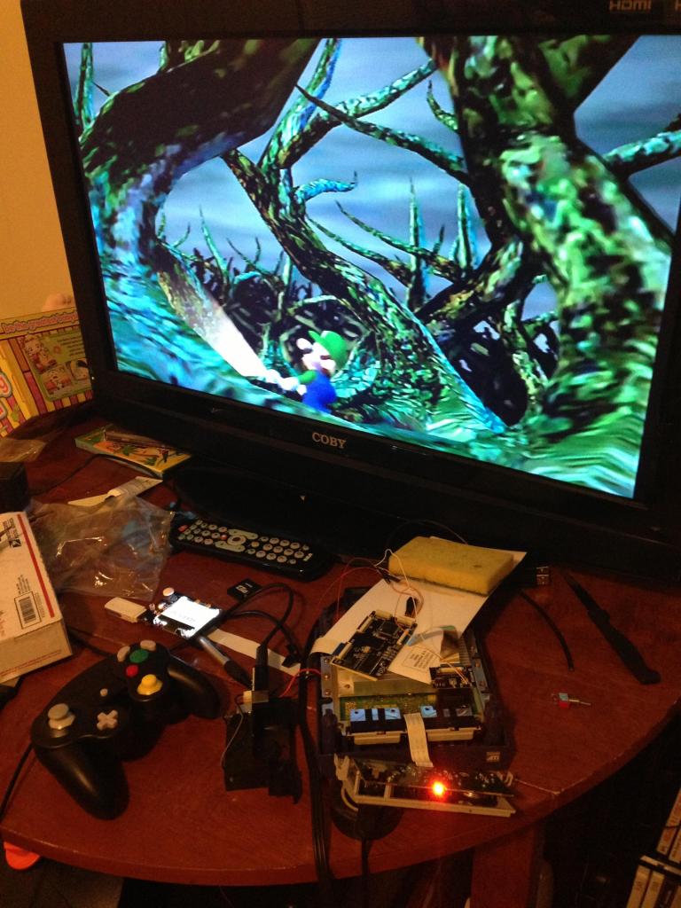

At least it runing

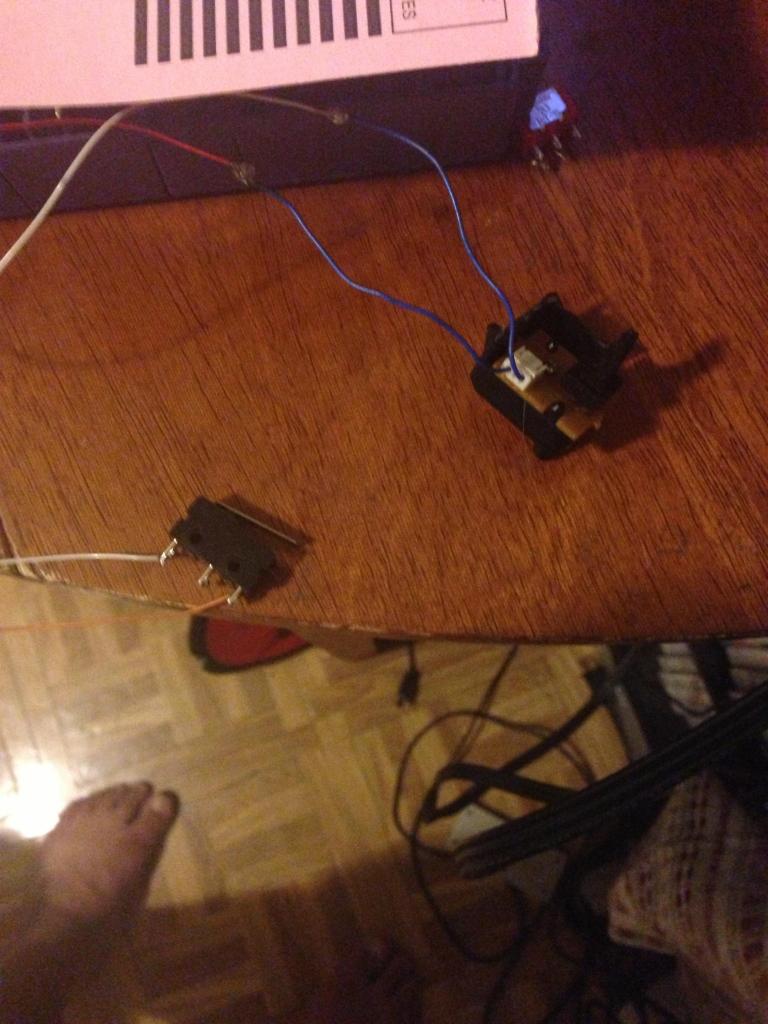

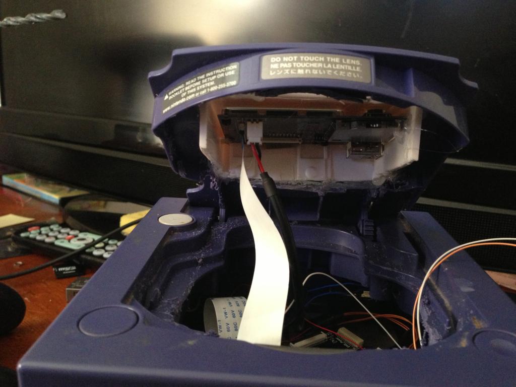

I used the GC lid switch and momentary tact switch

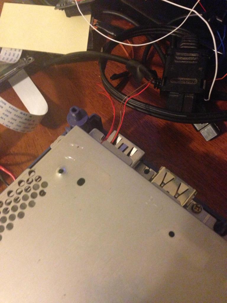

routed the wires from the back
Finishing it up
I have a idea
I love my dremel.
A Glue Gun and some hope
Wires being attached
YAY, still works
Close up
Filled the holes and used black decals
I used a momentary tact switch but I used it as always open and attached it so that when the lid closed the switch is pressed.
I decided to not use the SD and only the usb HHD attached on the side with velco.

3 days for a full build is pretty good....and wode too, the most challenging install
that last pic looks like a HDD to the right covering the vent???

megalomaniac wrote: that last pic looks like a HDD to the right covering the vent???
Yea the hdd was coving about Half of the vent. I was playing for about 3 hours
without any heat issue but still going to move it out of the vent.
It only took 3 days but that is because I spent 4 months doing the wiring in my head and paper
I mainly picked wode because I could attach a harddrive instead of swapping sd cards.
