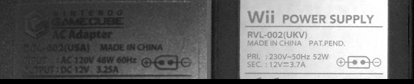

Looking at both the GC and Wii Power bricks right now and I would like to point out on the GC cord the pin closest to the flat or straight edge is negative, and the pin for the curved side is Positive. On the Wii, this is reversed! The flat side is positive, and the angled side is negative.
So in addition to trimming the key around the connector the positive and negative wires need to be switched.
Also, HOLY COW!!! that is an expensive power adapter!

Yea when I said you had to trim the key and make sure you had the proper polarity, I meant the entire outer plastic where the pins are so only the 2 inner pins were left that you could then plug into the jack. But thanks for posting the extra info and pics so people can understand better what we are talking about.
