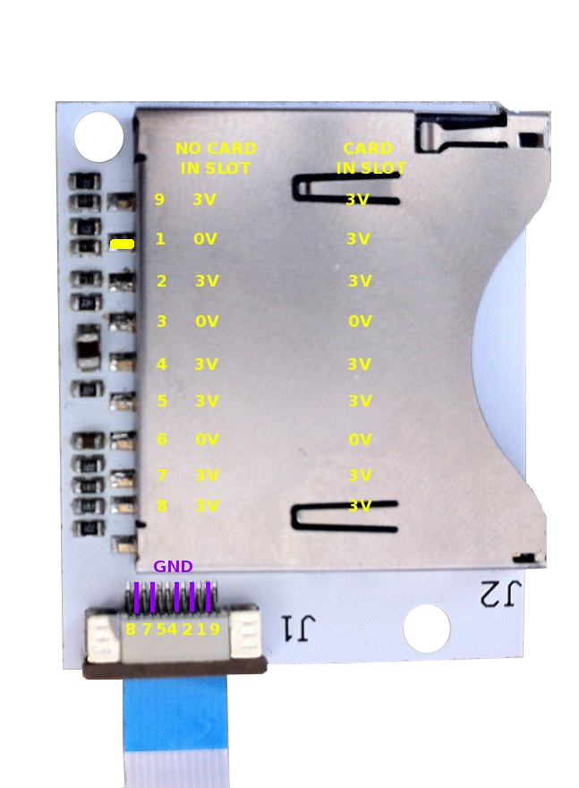

VOLTAGE MONITORING: is measured by a single wire between Atmega8 and the WKF SD card slot.
   WKF SD CARD PINOUT = 9, 1, 2, 3, 4, 5, 6, 7, 8
   WKF SD CARD Slot pin #1 = 0v when no card inserted.
   WKF SD CARD Slot pin #1 = 3v when card is inserted.
   Atmega8 pin PC2 is set up to monitor presence of voltage.
   Atmega8 pin PD5 is set up to provide pin29 GND function.

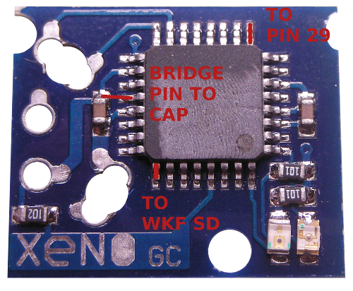

installation
2 wires
one solder bridge
two corner pins were strategically chosen as the soldering points for xeno to make for a much easier soldering install with plenty of accessibility for even the novice modder. Using the corners will provide less chance to short any pins.
It also happens to be the bottom left corner pin can be dedicated for voltage monitoring...luck!!
this bottom left corner pin is soldered to the WKF SD card slot pin #1 as indicated in the pic below.
the top right pin goes to WKF pin 29 or a normally closed switch (for backup purpose).
ELECTRICAL SAFETY NOTE: If you already have a pin29 switch, you must disconnect the lead from GND and solder it to Xeno instead.
DO NOT leave the switch soldered to GND and Xeno at the same time.
also, as shown in the pic, a solder bridge must be created between the "AREF" pin and the capacitor. This AREF pin is used as voltage reference for internal baseline voltage monitoring.
