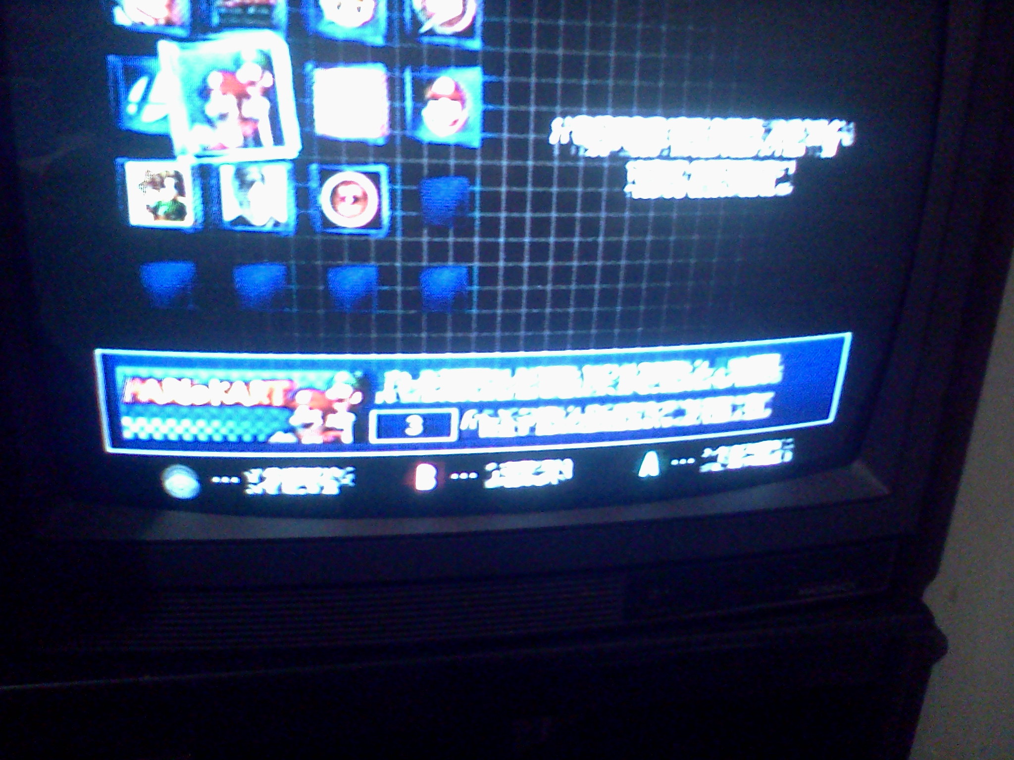

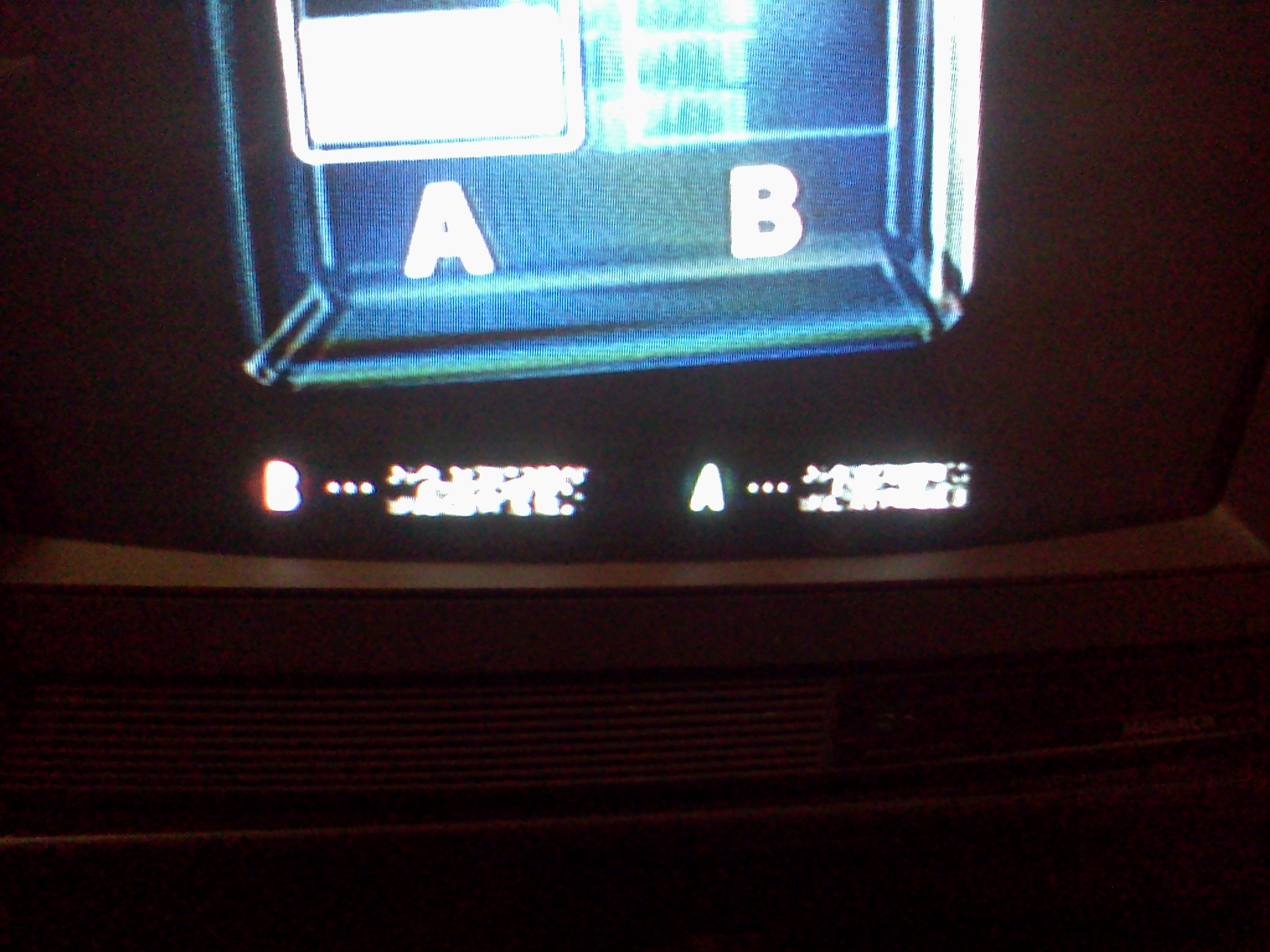

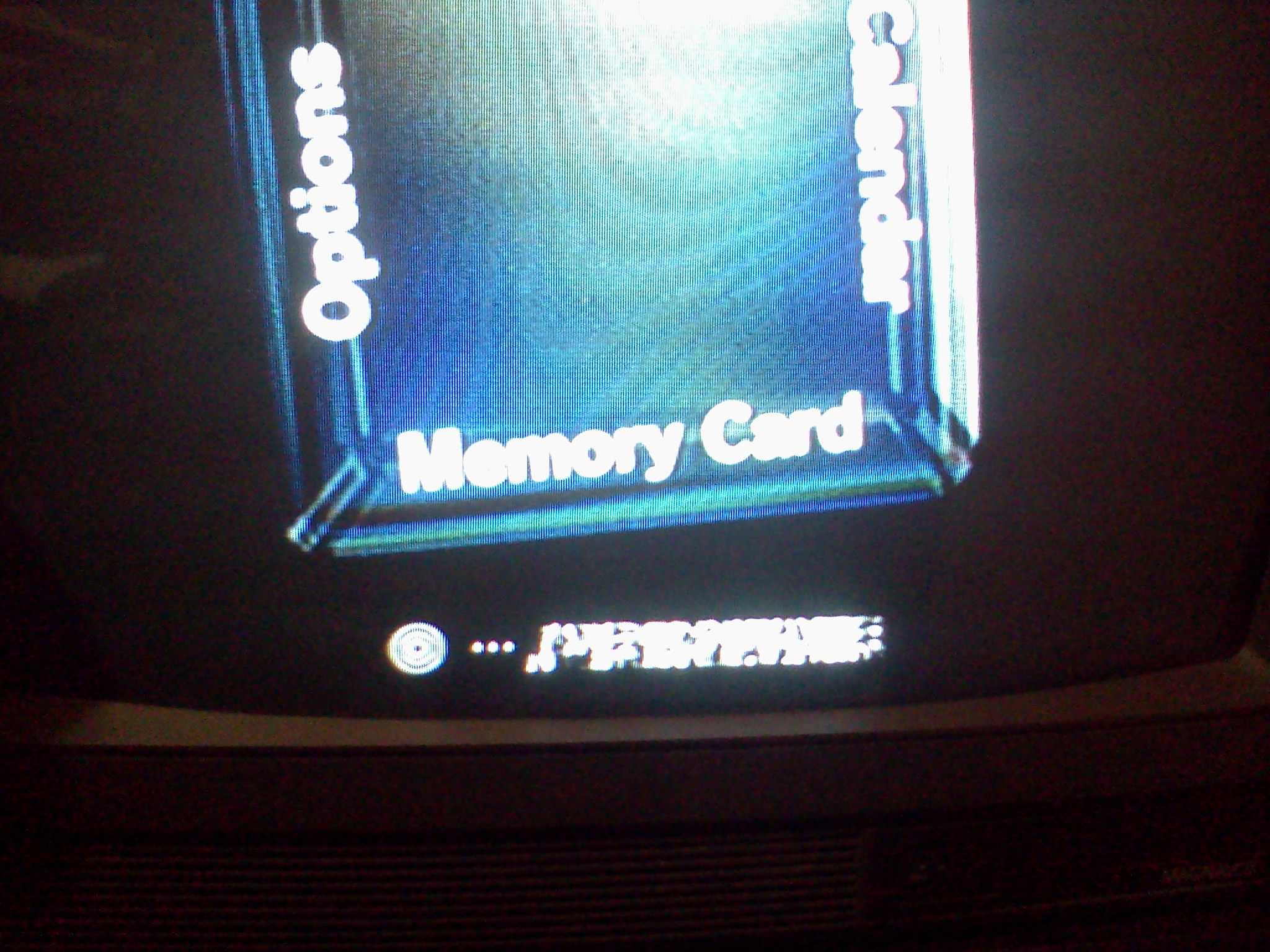

I purchased a Gamecube on ebay last year because I needed an indigo DOL-001. Anyway, I didn't read the sellers description very well and it turned out to have an issue displaying text. I'm positive it is a software related issue because it plays games like a charm and reads every in-game text normally UNLESS the game uses default Gamecube font to display text. The cubes audio doesn't work anymore but that's my fault because I had bad luck trying to installing the optical audio board I made; but this text problem was there before that.
Has anybody ever scene anything like this? Any help or troubleshooting suggestions would be appreciated.

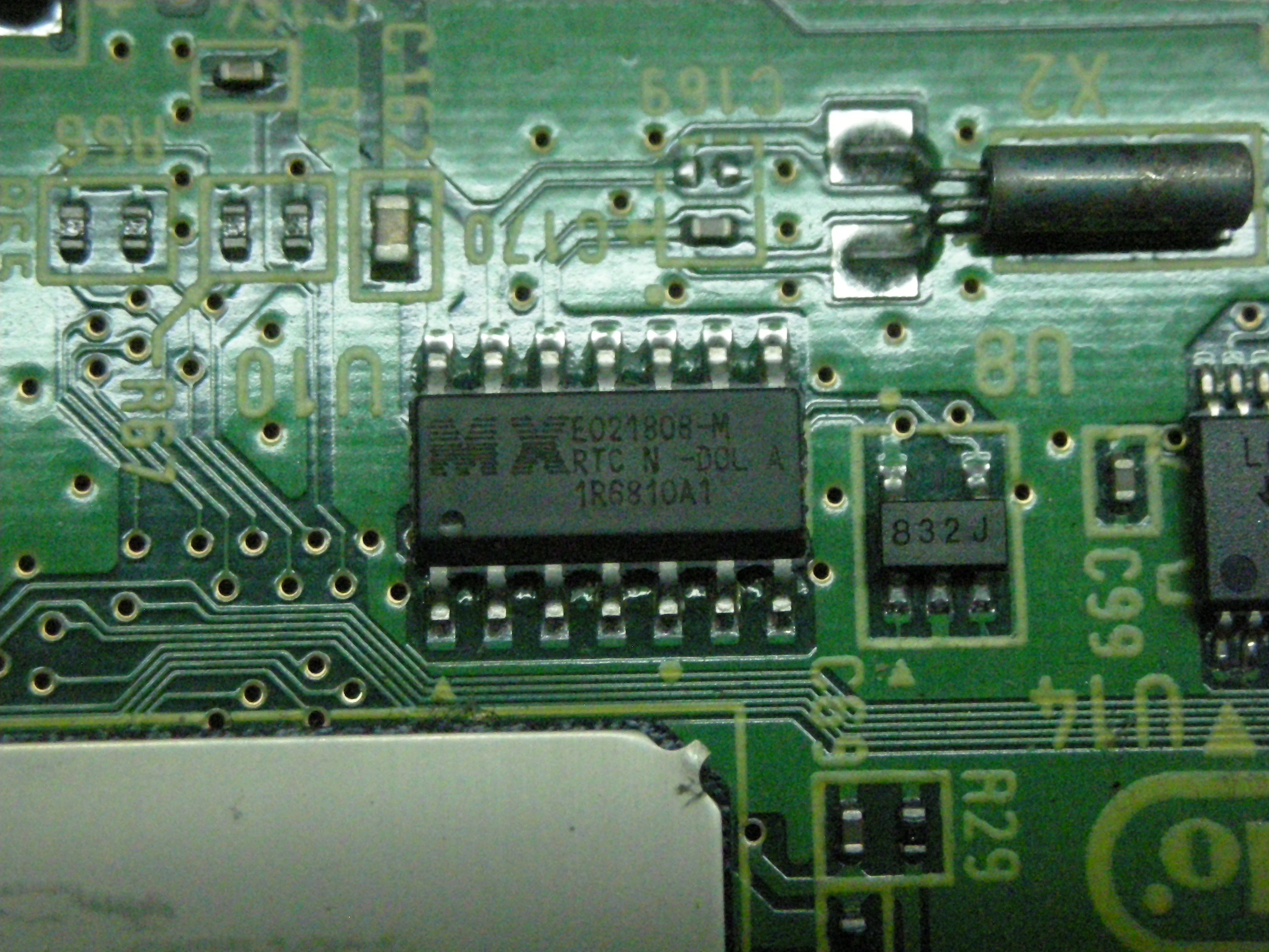

have you inspected the mainboard yet?
its possible there was an issue during a previous modchip installation or removal...or maybe even a failed attempt at region mod...
i posted some large close up shots in the wiki for the region mod...
i have also attached a large close up shot of the RTC
as for blown audio, try wiring audio using ashen's board cut pinouts to trace back and see if there is a defective component somewhere along the way...hopefully you just blew a cap. i killed audio once by exposing a cap to 1200* hot air...oops...

IPL font is used on the cube itself I thought. Maybe try toggle languages. I'd say it's definitely IPL hardware related
