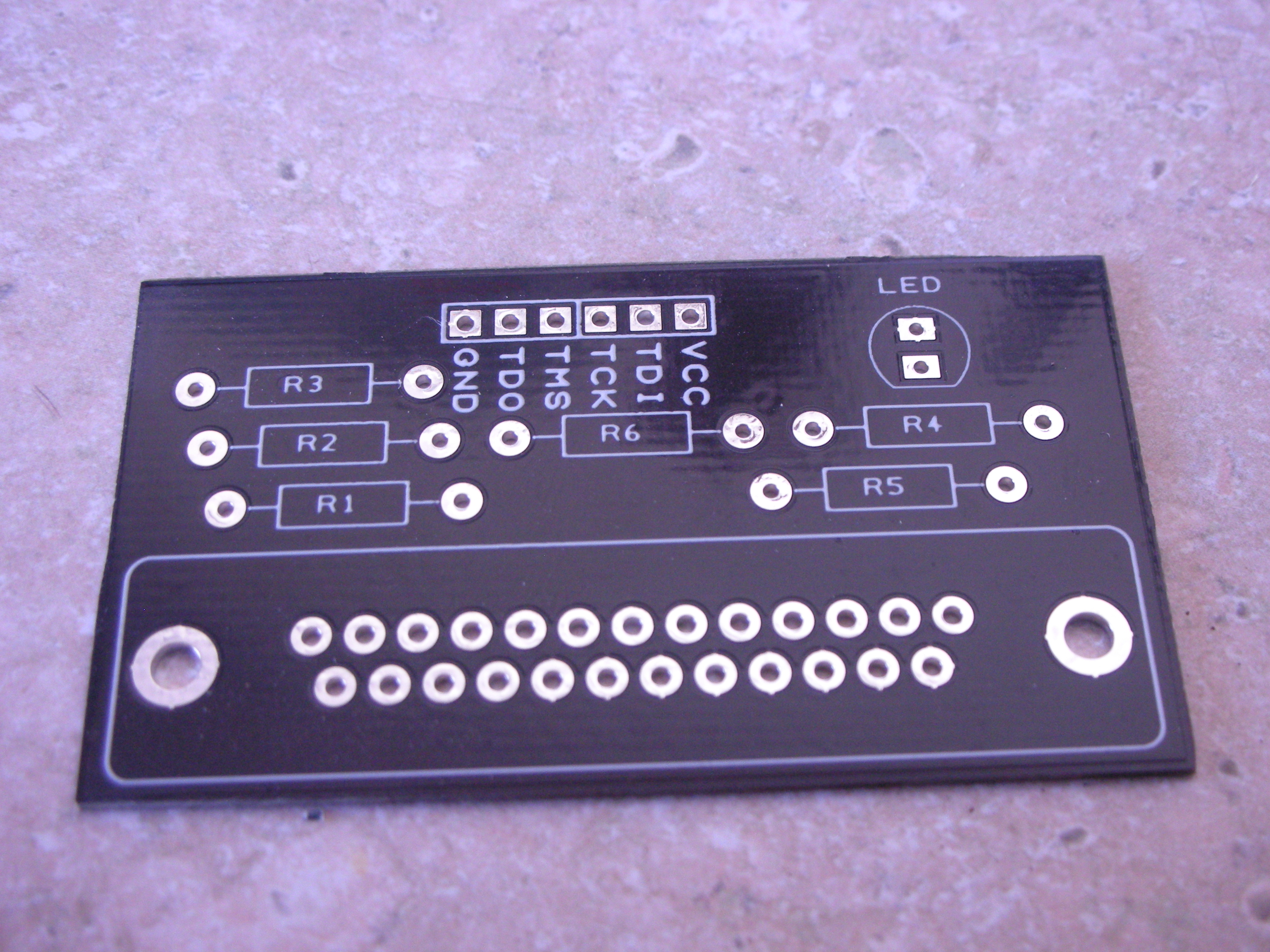

Post by megalomaniac » Tue Dec 18, 2012 8:32 pm
i guess if someone was gonna build this programmer it would look something similar to this
...or smaller if someone was using smd components...

Posts: 1817
Re: Alternative programmer design for DIY IDE-EXI
Post by liquitt » Tue Dec 18, 2012 8:56 pm
nice! did you order anything else from them? ;)
Post by megalomaniac » Wed Jan 30, 2013 7:51 pm
to my surprise, the programmer design posted above has been tested and verified for use with a cable length of approx. 1 meter (3ft 3in)
my physical cable length measured 105cm (3ft 9in)
120cm cable would error...so keep it at 1m or less...
disclaimer: 1m cable is not recommended. cable length test performed only to determine maximum possible length
