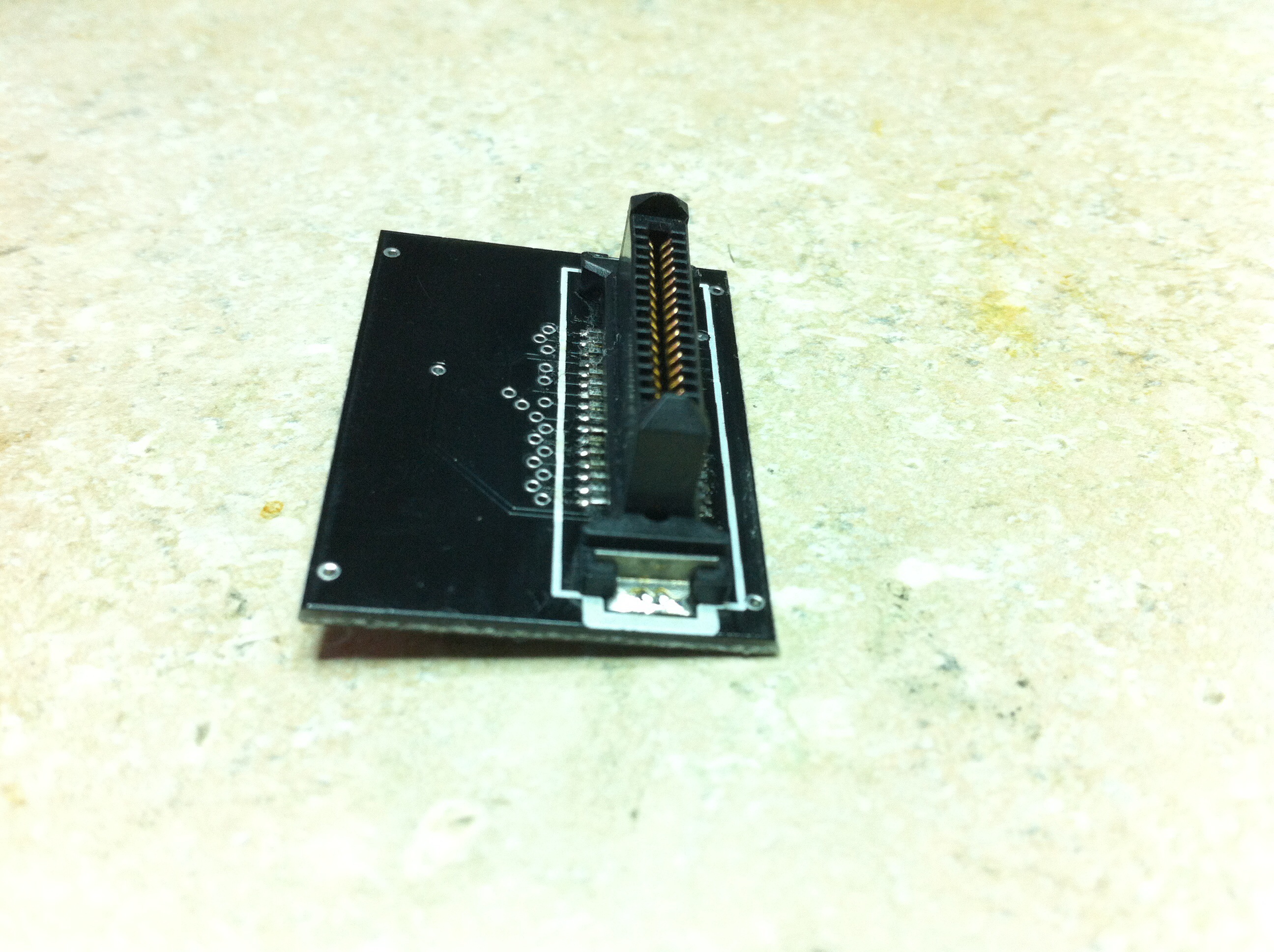

Post by novenary » Fri Apr 18, 2014 9:53 pm
Oh wow indeed, the board is barely thicker than the cable but the contacts are damn thick. O.O
Post by megalomaniac » Fri Apr 18, 2014 10:09 pm
yup..suppose to nice and thick...
thickness + the gold plating will help dissipate heat during the soldering process allowing the board to survive a bit of abuse / rework...
soldering abuse and rework is something an FFC cable cannot handle

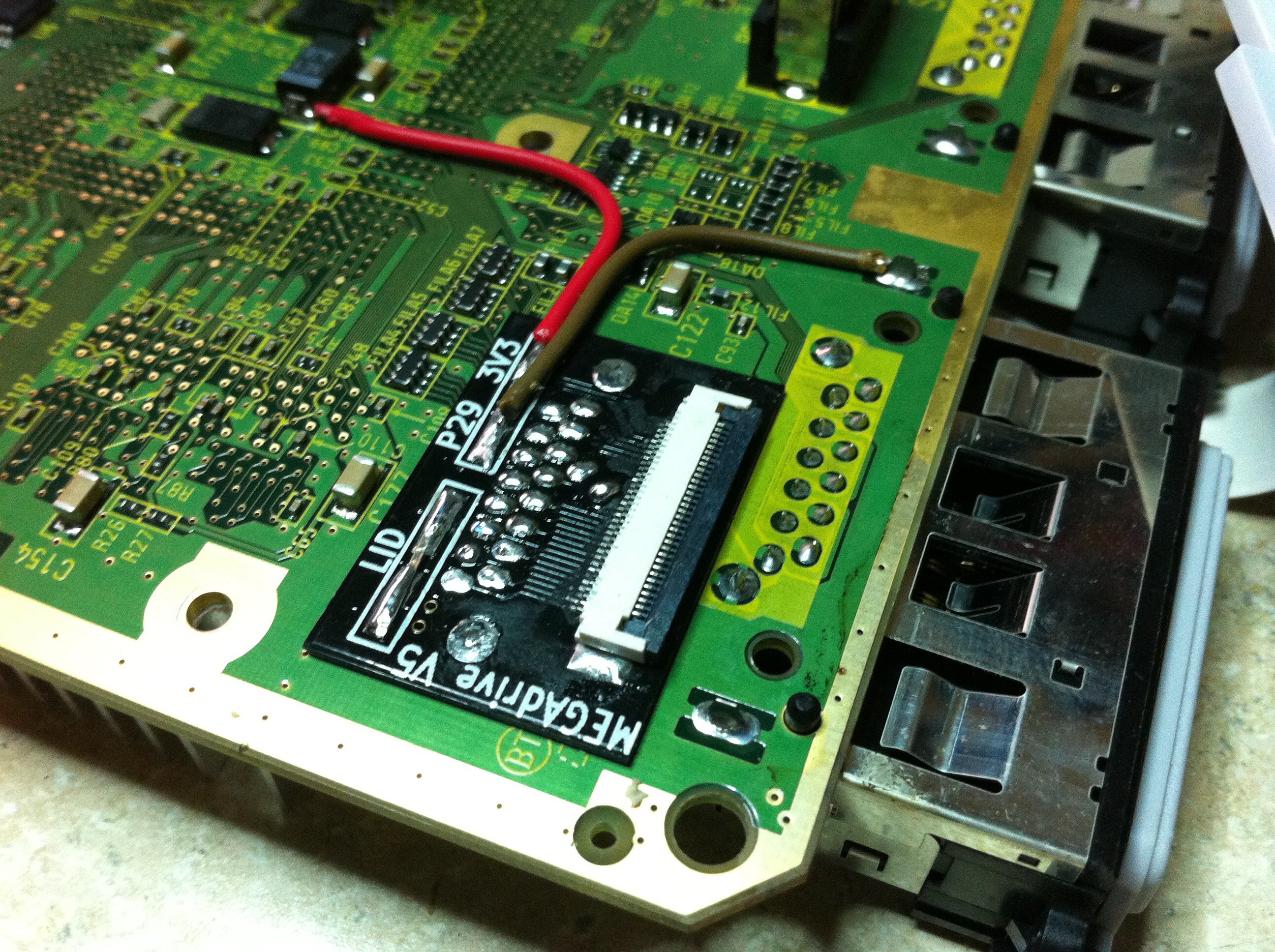

Post by megalomaniac » Sat Apr 26, 2014 5:20 am
V5 install
by far the easiest installation...
i spend about a good minute to make sure it was positioned correctly and to solder on the first point to hold the board in place...
after that it was like 1 or 2 minutes to solder the rest of the contacts...
...super simple...
word of advice: use caution on the pad closest to the FFC connector so you dont melt the connector or bridge the connection...just hold the iron away from the connector and everything will by fine...
YES, YOU MUST REMOVE THE DVD PORT CONNECTOR!!!
if you try to install V5 with the DVD port connector still attached then you are an idiot and will run into problems because the board will be floating above the pins instead of laying flat on the mainboard making it harder to create good solder joints and run the risk of the pins slowly piercing the soldermask to GND which will short your GC making it catch on fire or explode...
...you have been warned
(1.88 MiB) Not downloaded yet

Post by siphoned » Sat Apr 26, 2014 4:06 pm
Are the pads for the 'Lid' bridged together? (in the v5 install video)
and does that give function to the original lid switch on a cube?
Post by megalomaniac » Sat Apr 26, 2014 5:02 pm
LID pads are bridged
and
P29 is soldered to GND
NOTE: this was only done for purposes of functionality testing to mimic the exact connectivity requirements for a NC switch...

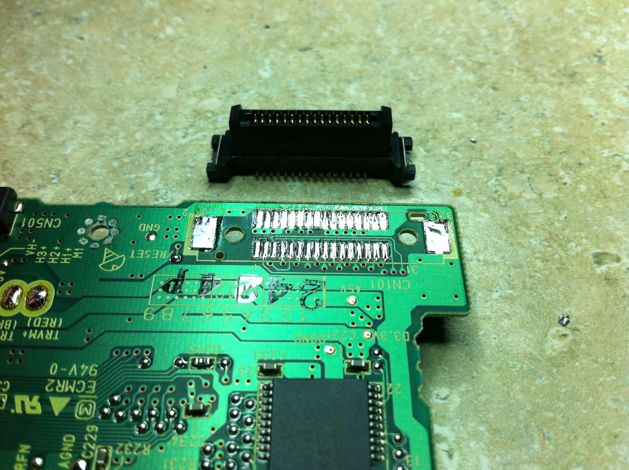

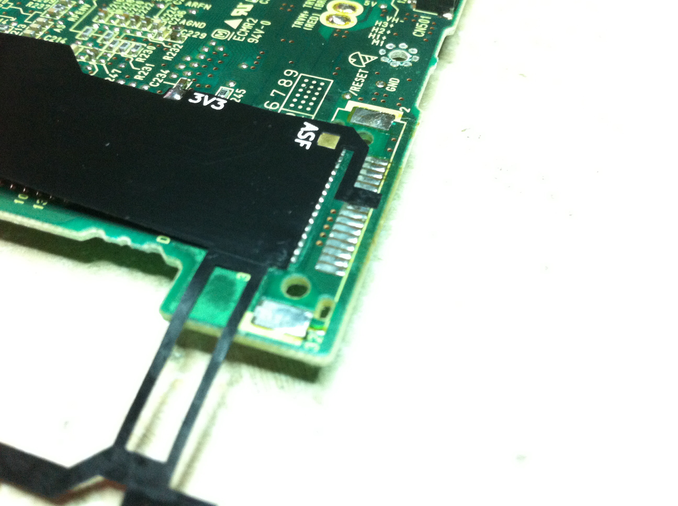

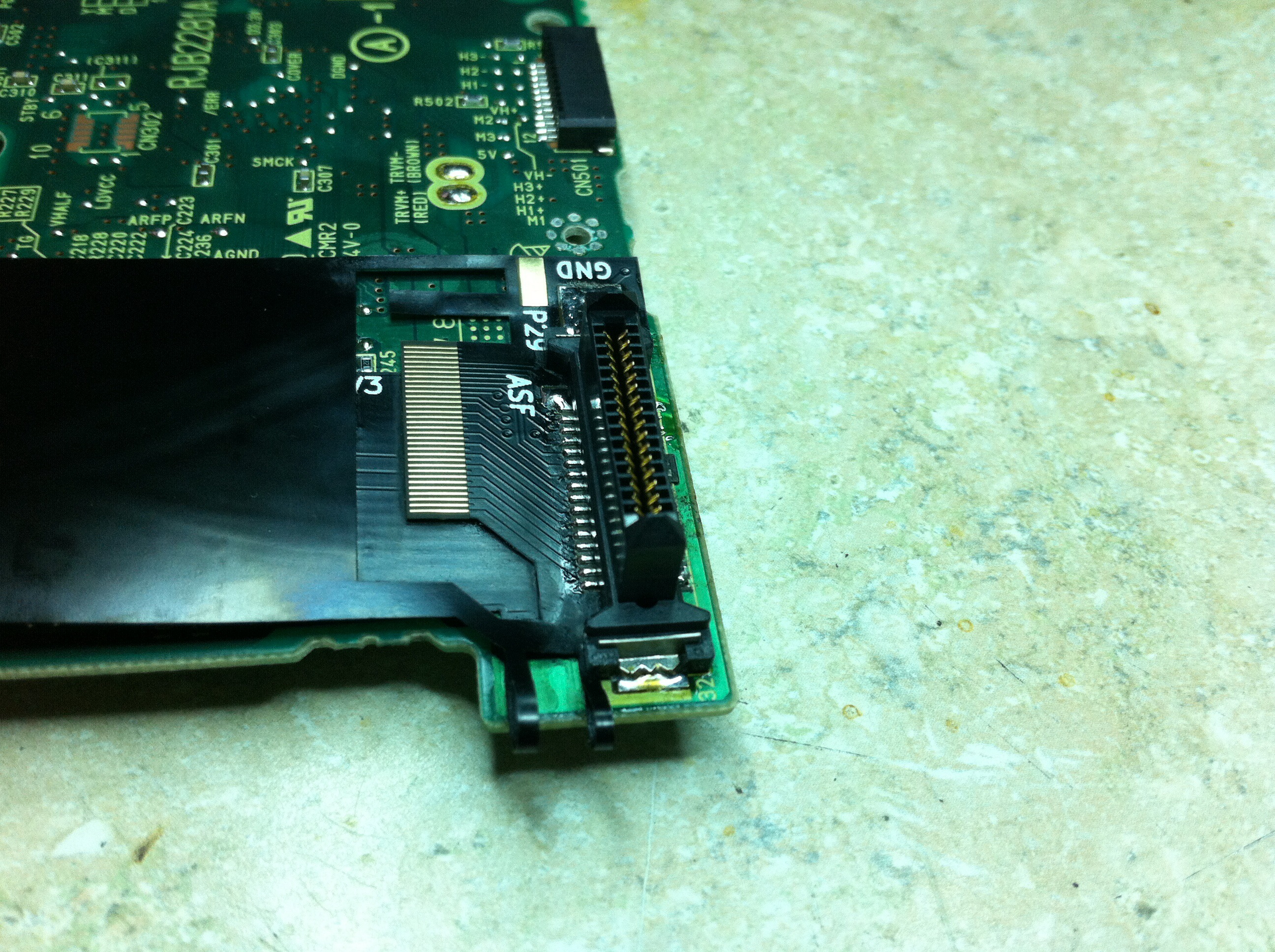

Post by megalomaniac » Sun Apr 27, 2014 9:50 pm
V4 install
one hell of an install process...
very complex integration with satisfying ease of use results...
high res shots
Step 1
(1.92 MiB) Not downloaded yet
Step 2
(1.69 MiB) Not downloaded yet
Step 3
(849.88 KiB) Not downloaded yet
Step 4
(1.9 MiB) Not downloaded yet
Step 5
(1.62 MiB) Not downloaded yet
(2.42 MiB) Not downloaded yet

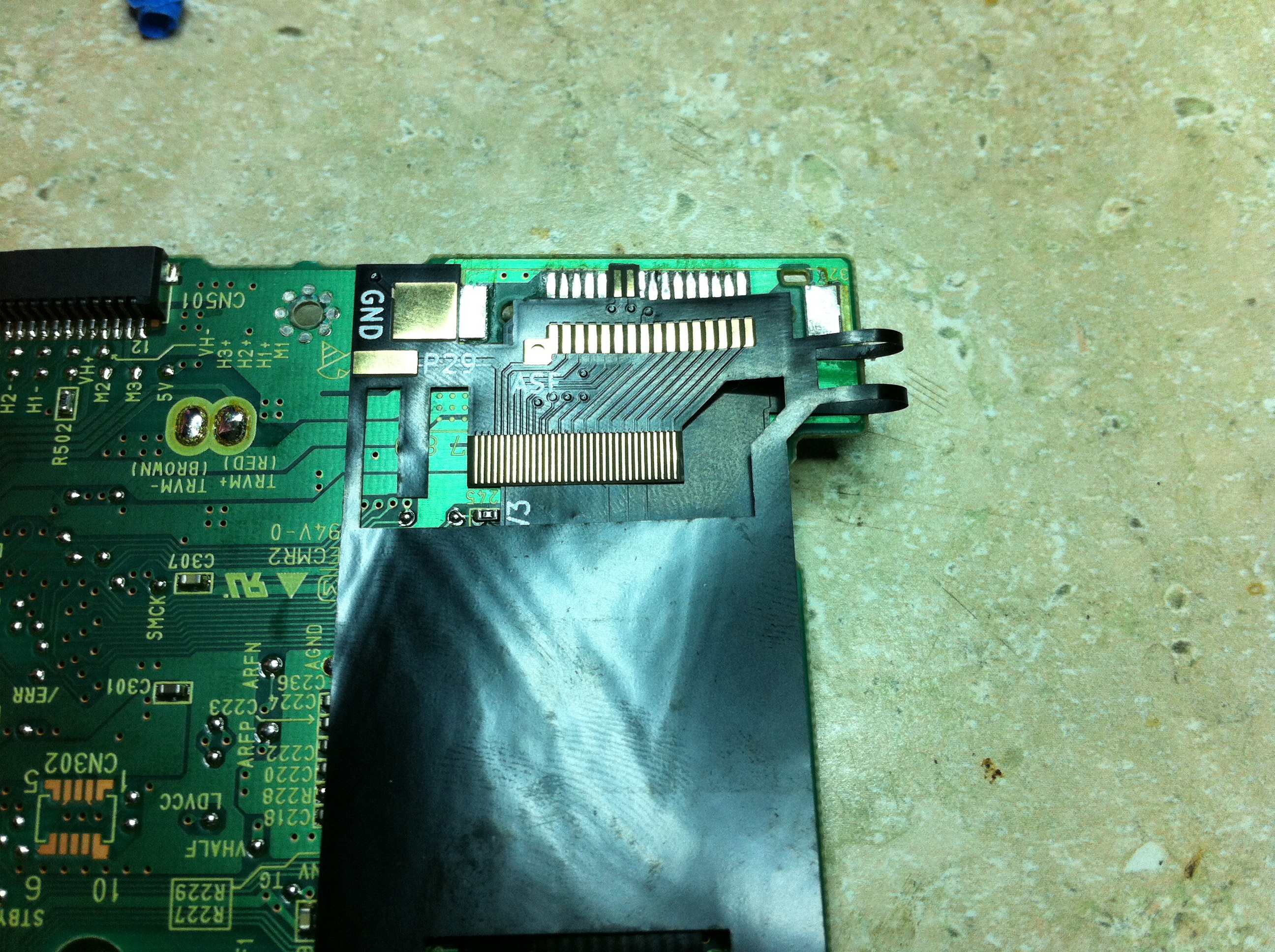

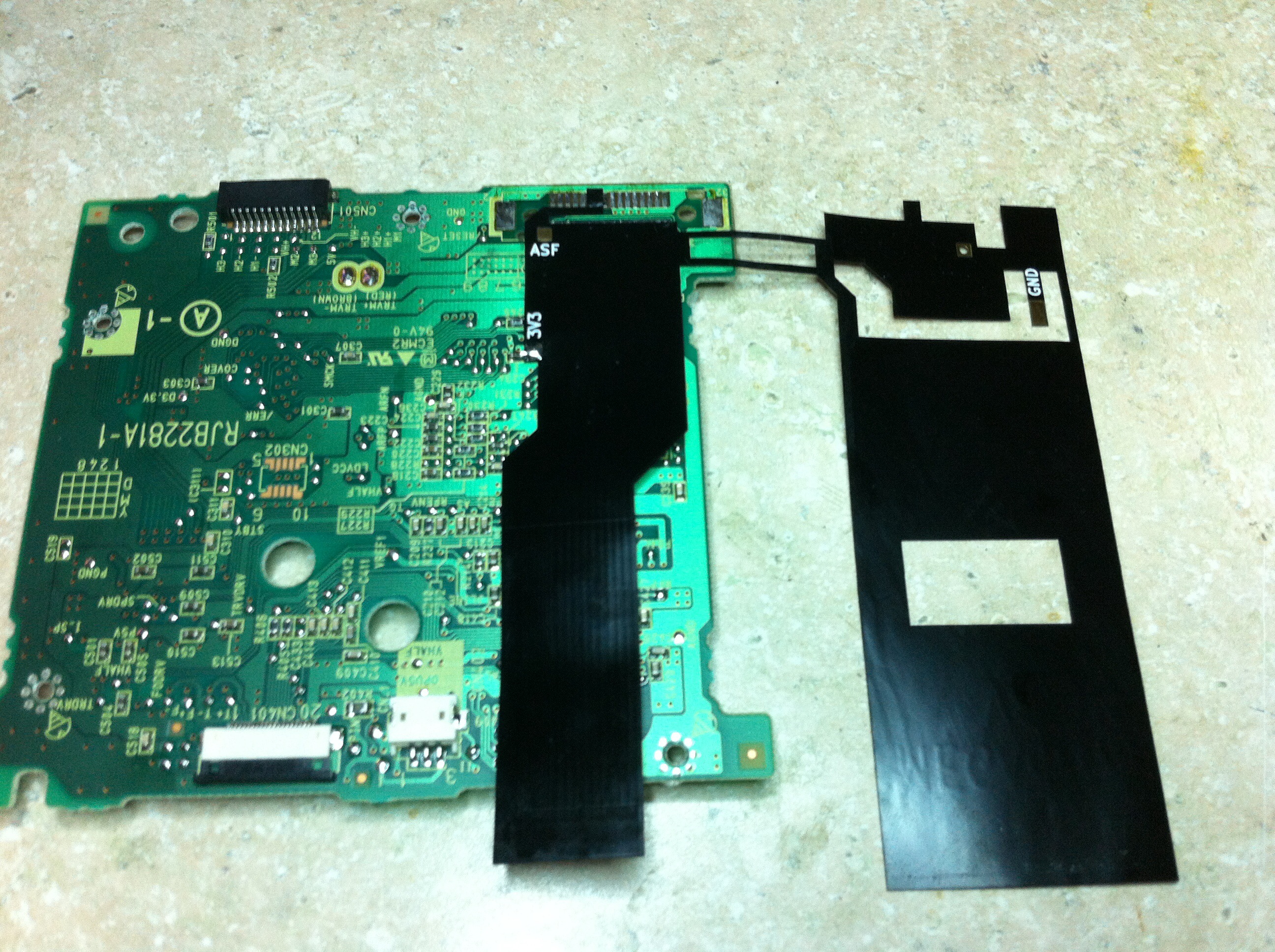

Post by megalomaniac » Sun Apr 27, 2014 10:16 pm
some quick technical notes about v4:
- Pot Adjustment
original laser resistance was read at ~275 ohm, this one was adjusted to ~100 ohm. Only reason to adjust was to ensure the buyer would not have to come back later and attempt to set the impedance for DVDr
- No Xeno required
Swiss will patch the DVD drive to read backups, so booting into swiss menu and then reading a DVD from within swiss will allow all DVDr backups to be playable with audio streaming functionality.
- no 3.3v regulator
since the DVD drive board has its own 3.3v regulation i have placed a pad ( seen in "step 2" ) which solders onto a capacitor on the drive board to provide 3v power to the WASP.
- 5v & GND passthru
the design does not cover the drive board pads for 5v or GND. This allows POWER and GND to pass thru from the mainboard to the drive board on the connector as originally designed by Nintendo. This also allows for a more solid connection of the drive connector.
- FFC blue backing
The flex design does not come from the factory with the FFC cable type blue backing. I removed these tabs from an actual FFC cable and applied onto my design with superglue.
- Design untested before production
HA...thats right..
I designed this version and send it off for production not knowing (and hoping) everything was designed properly. Until this first installation, i had no idea if the design was accurate or if everything was spaced and aligned properly or is the drive connector would attach back onto the drive board as i "visioned"
- inverted surface mounting
WTF is inverted surface mounting? ( Step 3)
I searched the web for days to see if anyone had done anything like this before in hopes of finding some design notes or tech documentation. I could not find anything. I had no idea if this type of soldering would even work as ive never done or seen anything like it before. I wonder if the soldering industry would consider naming this soldering method "MEGA mount"
- Very complex design
I had to go back several times and look at my original design schematics to remember how i was suppose to put this together. This sucker is so complicated i cannot imagine anyone trying to install one.
- not tested for WKF
since WASP has a smaller footprint it actually fits better into the target area. i tried to get a WKF to fit in to the same area and it did not seem to sit well..so this is WASP only

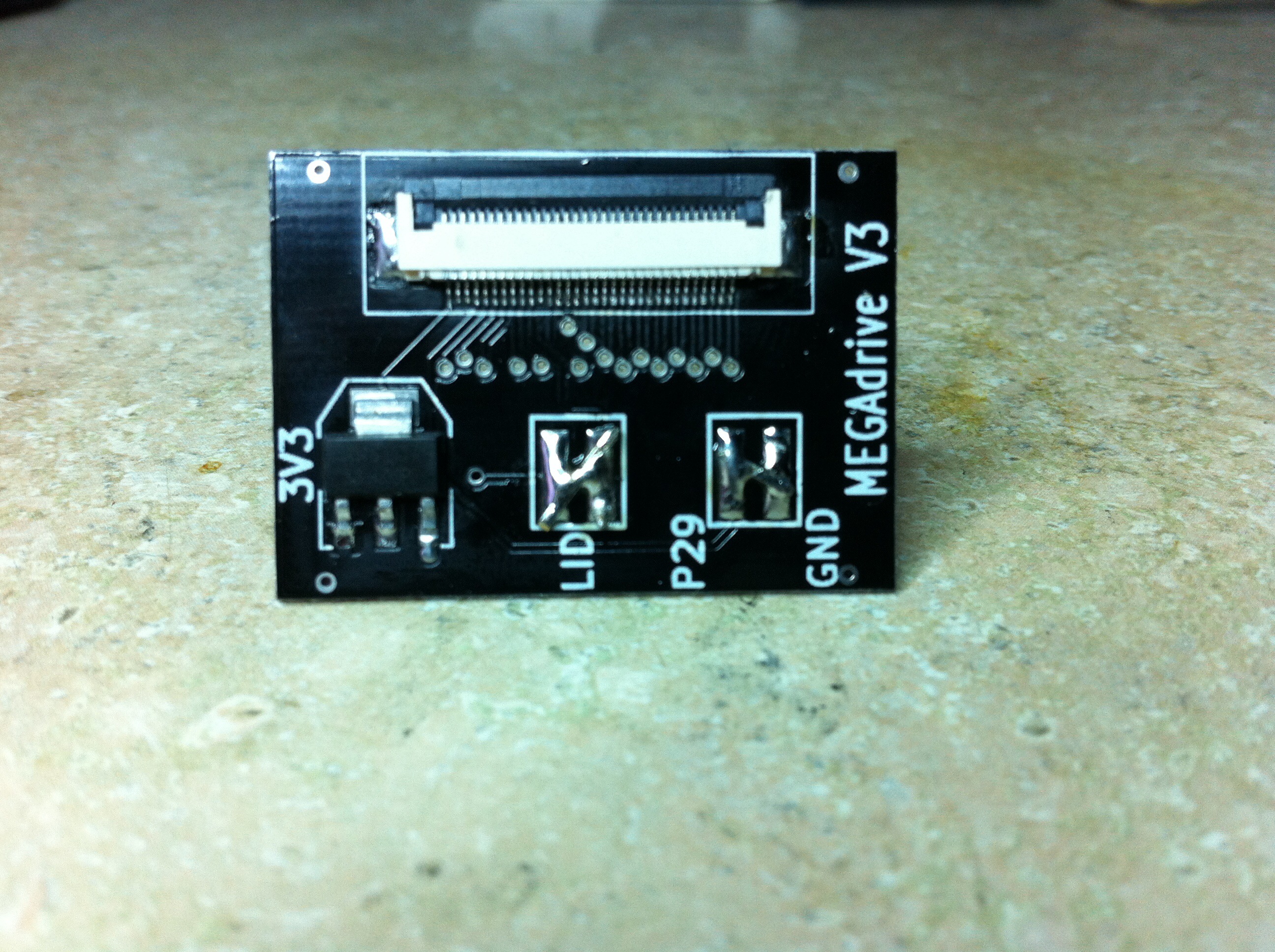

Post by megalomaniac » Mon Apr 28, 2014 1:40 am
V3 install
simple
so damn simple...
its a complete plug n play solution to replace using a DVD drive..
connect pin29 switch and lid switch or just jumper the pads together and plug it into the GC...
it cant get any easier than this...
(1.1 MiB) Not downloaded yet
