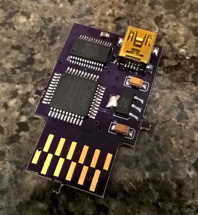

Post by emu_kidid » Mon Dec 21, 2015 1:28 pm
Just put my first one together and programmed it, yet to test it out or file down the edges :)
(91.21 KiB) Not downloaded yet
Re: Yet another USB Gecko clone
Post by novenary » Mon Dec 21, 2015 5:16 pm
Looks a lot nicer than mine (I still need a proper soldering iron).

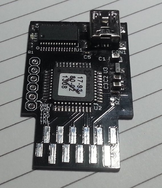

Post by meneerbeer » Tue Dec 22, 2015 7:00 pm
I never showed mine:
The mark on the CPLD is to indicate that it works, because it does not have a fake FT245RL. ;) I went with a smaller voltage regulator, so there would be place for the JTAG connector. By shorting R2 you can choose to use the 3.3 V from the GameCube EXI connector. I swapped the 100 nf caps for 0402 size, since that is what I use and have plenty of lying around.
I think I will test one more board using a real FT245RL and if that works, I guess I can put the design on github or something. With the fake FT245RLs some had trouble setting up a USB connection, so it could be that something is wrong with my design there. The board with the real FT245RL worked luckily.
The FT245RL has a built in 3.3V regulator, but unfortunately it seems to be just too light to power the CPLD. :evil:
I believe the I programmed the LED to flash when there is communication with the GC, but I already forgot, I have not really used it a lot yet. The raphnet N64 to GC adapter can now be updated through the N64's controller port with new firmware. I was planning on creating something similar for a GC to N64 adapter of mine. I was at the point that I could send my own data over the controller port. Right now I am too busy graduating and I want to do some other stuff.
Your soldering looks really good emu_kidid!
(74.65 KiB) Not downloaded yet

Post by emu_kidid » Tue Dec 22, 2015 10:27 pm
Thanks, I like the JTAG location on yours, less troublesome without a jig of sorts :)
