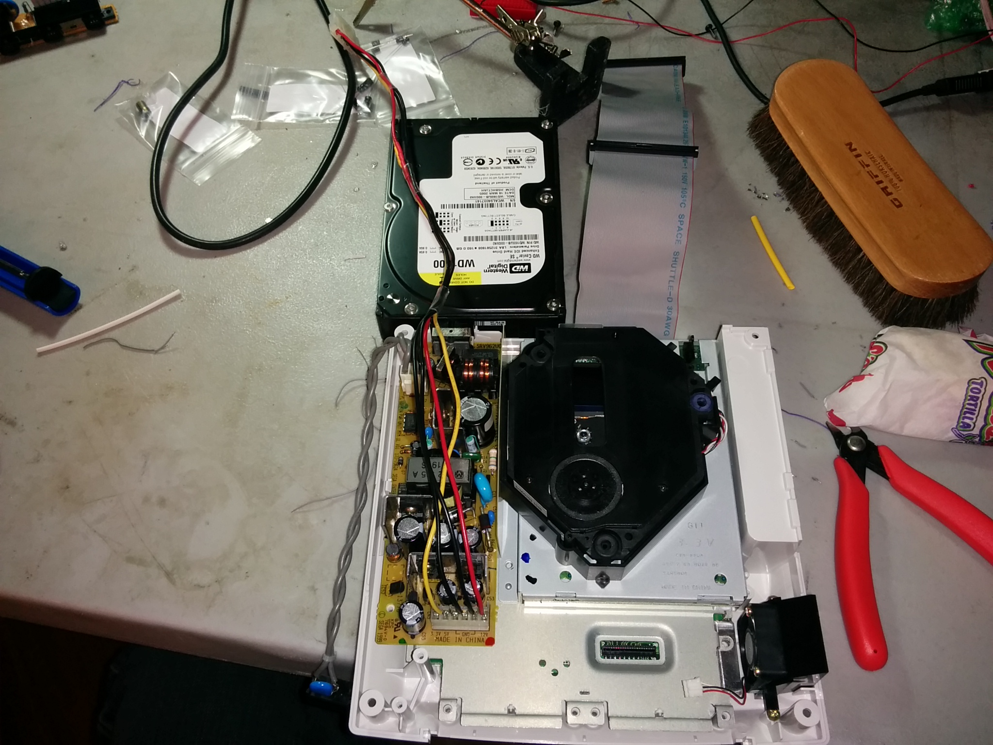

I was I little bit worried about the cable length. So I figured I would try the ide route just to start from ground zero. I have the cable hooked up now. Just need power and I'll be ready to try again.

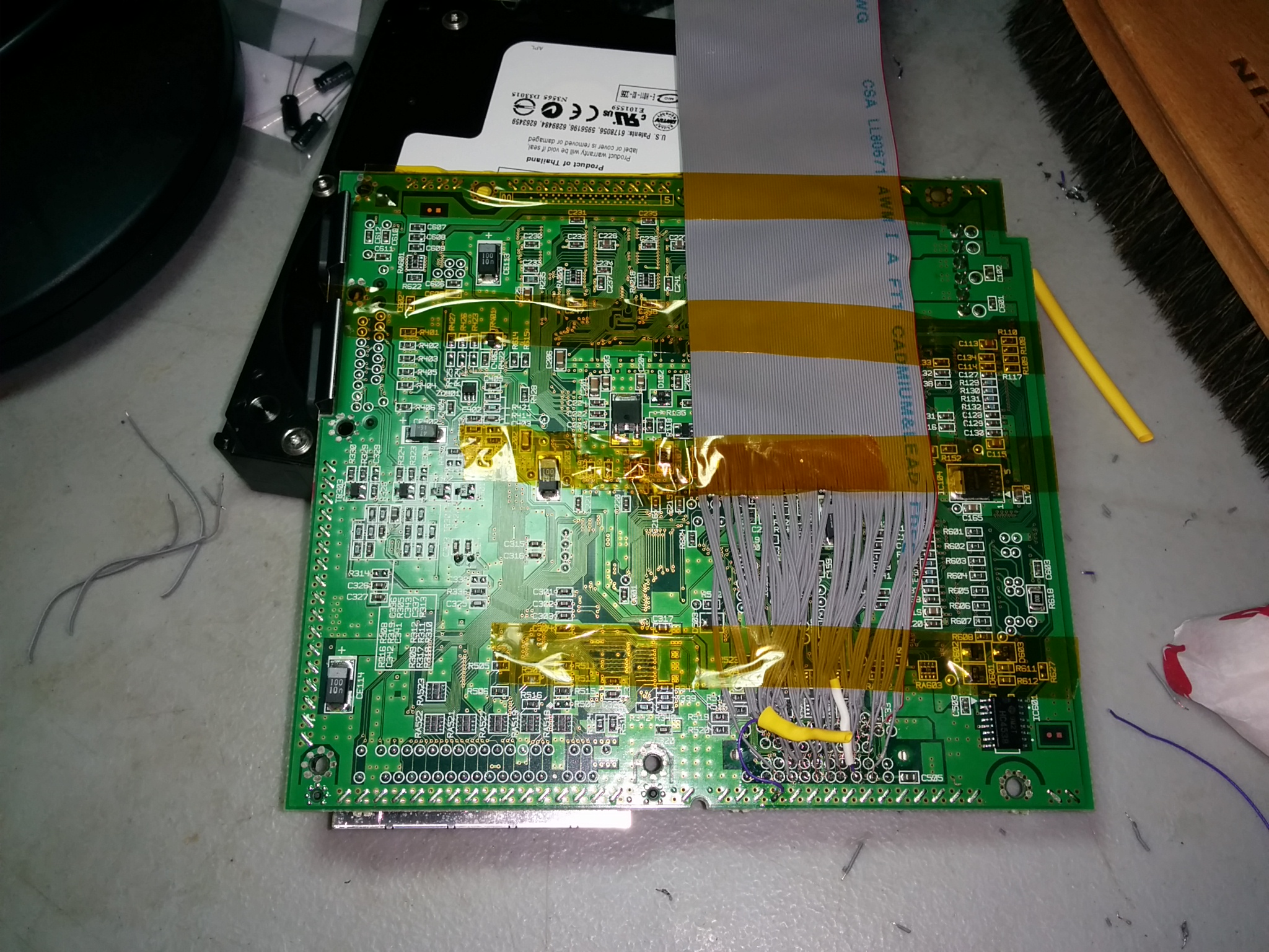

Post by marcus9199 » Mon Jul 21, 2014 12:53 am
Time to cross my fingers. :| :|

Post by marcus9199 » Mon Jul 21, 2014 2:09 am
Well I got another snag. I used an 80 pin ide so I just used the odd number cables since even are ground. Bad thing is I may have that backwards because the Dreamcast did nothing. But I'm not giving up I'll try again tomorrow. At least by the time I make this work maybe I can tell everybody what not to do.

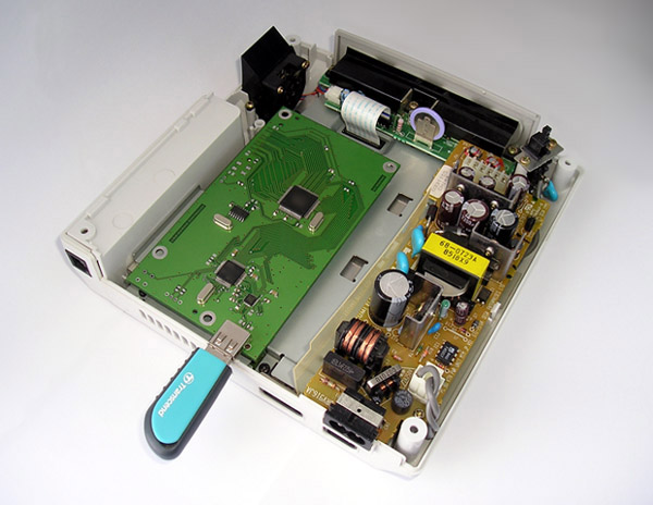

keropi
Posts: 167
Re: Dreamcast
Post by keropi » Fri Sep 05, 2014 12:02 pm
(71.65 KiB) Not downloaded yet
Benni
Posts: 259
Re: Dreamcast
Post by Benni » Fri Sep 05, 2014 6:52 pm
Nice...
BUT:
Where to plug in HDD?
only USB HDD?
Can the DC Drive also be used?
keropi
Posts: 167
Re: Dreamcast
Post by keropi » Fri Sep 05, 2014 7:21 pm
no dc drive, this replaces it
you can use whatever usb device you want externaly: usb stick, usb hdd... I have a 2.5" 500GB drive to use with it
