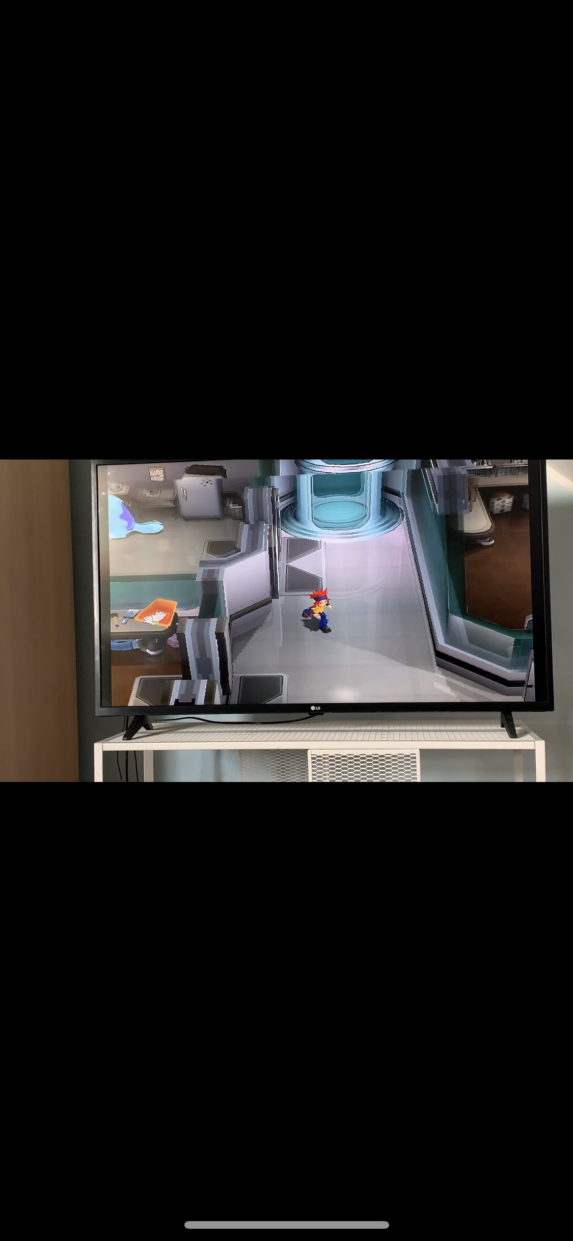

Hello guys,
I have a dol-001 GameCube and an adapter of kaico to connect my gamecube with the tv. I have installed the picoboot with sd2sp adapter on my console and everything works fine so far. Everytime when I start a game neither pal nor ntsc, I get a strange picture on the tv. The top bar of the screen is "slower" than the rest of the screen, so the picture of the top bar will be delayed than the rest of the screen. I don’t know how to describe this problem, since I haven’t found anything similar on the internet. I will put a picture on the attachment. My GameCube is a PAL console, I use 576p for pal and 480p for ntsc.
I would appreciate any help from you guys. This problem is so frustrating since I cannot find anything I’m the web.

What's the version of GCVideo in the Kaico adapter?
Do you have another display to test on?
