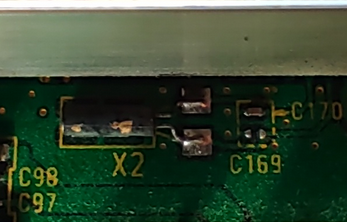

Something was definitely up on the motherboard it seems. I attached an image of the X2 capacitor (RTC Crystal from what I have researched: https://www.gc-forever.com/forums/viewtopic.php?t=4400) on the motherboard and it seems to have completely burnt out...
I ended up ordering a replacement motherboard and just swapped the entire thing in for my old one. Not 100% sure that the RTC Crystal was the reason for the issue, but it seems to have been, since after swapping the motherboard, the RTC is working as expected with the same replacement battery. Will check periodically to see if it gets burnt out again, since in that case, the battery might have possibly caused it to burn out.

I don't know how the GC works, but it is very unlikely that the time would have run while the unit was on, as this crystal makes it autonomous for the time count.
Anyways, this kind of crystal is probably a 32KHz one that you may find for cheap or easily rip off any electronic stuff, wristwatch…
But it may have burnt for another reason, and the replacement can burn as well unless the original issue is adressed first.
