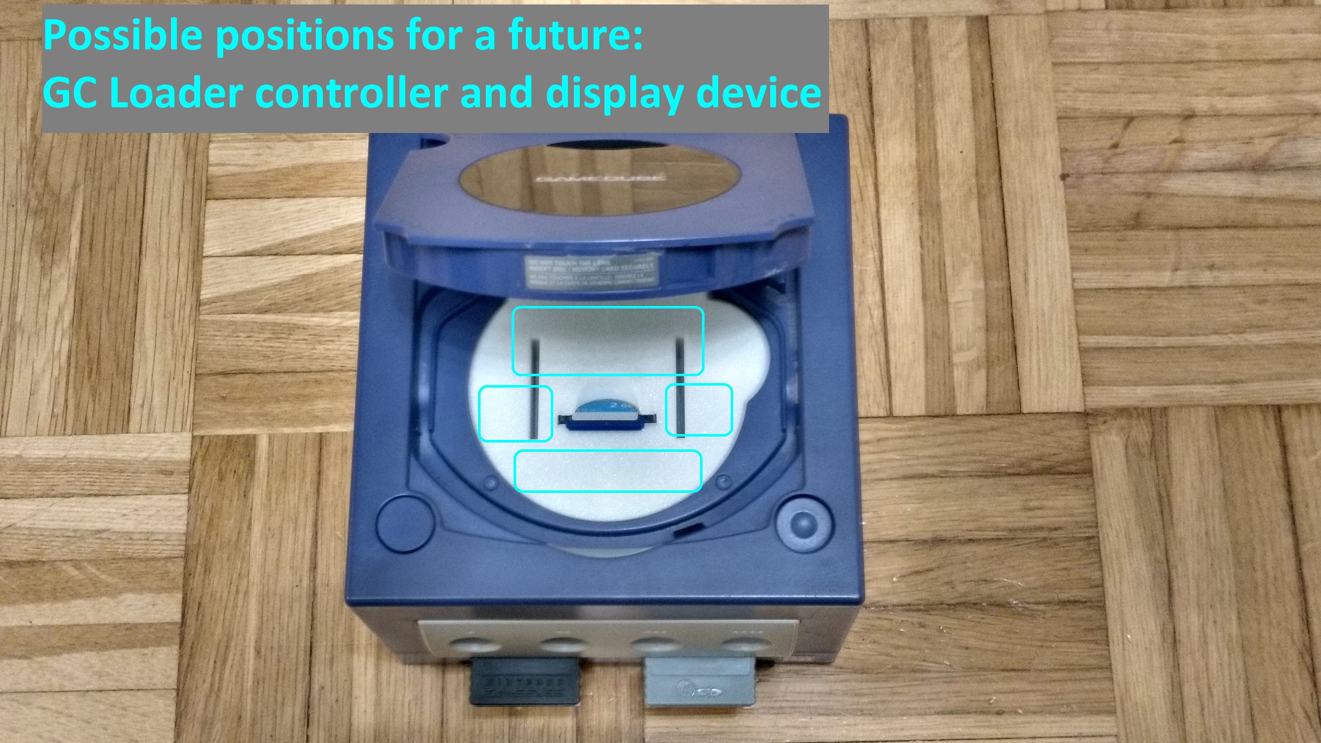

A solution with:
  • placeholder for the GC Loader controller device and display
would also be great:
(969.57 KiB) Not downloaded yet
I will definetly buy such a GC Loader controller device extension.
Thank you very much.
