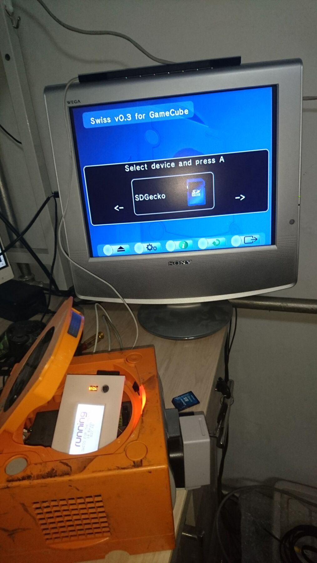

3 after GC succeed to go to swiss 241 ,Press "B" and see Down-Left on Tv, then pree "A ", a "Device-Window" will appear, then Choose "Sd Gecko", choose you Cheat Codes named "xxxxxx.qch".

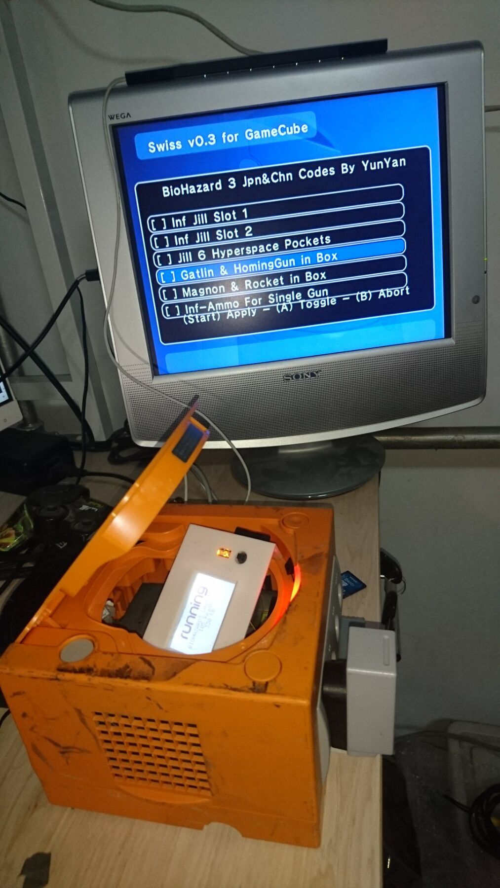

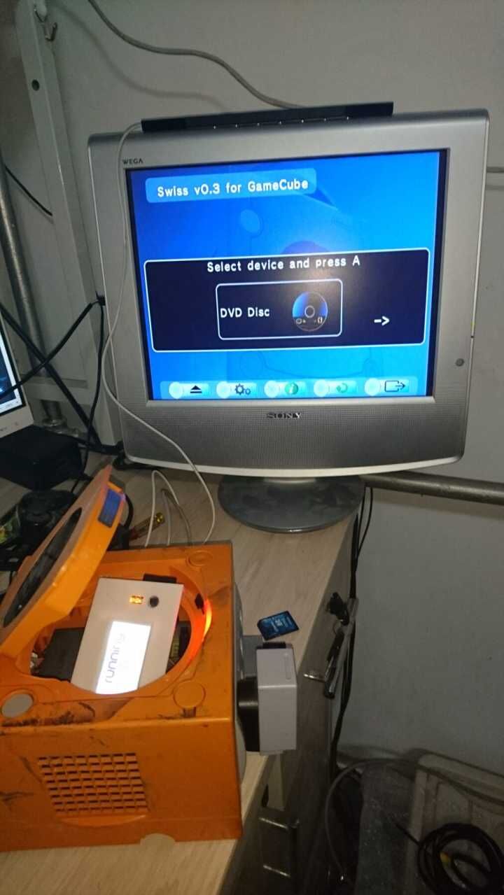

5 go back to Tv,Repeat "B" ,"A", Press Cross to choose "Dvd Disc" in the "Device-Window"
6 Press A 2 or 3 times and you will see the logo of the game, then Press Y ,a Cheats-Window appear, choose Cheats you want , and Apply them with "Start",
7 Press A again ,Will Start Game with the Cheats Codes you Applied .

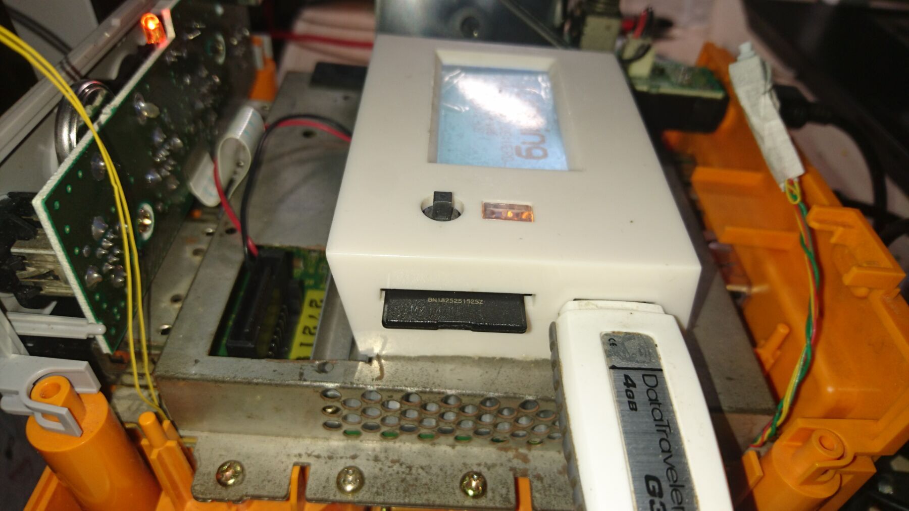

---Ngc Wth Wode JukeBox----
0 put Codes ( .qch must) into Sd gecko . (You can trasfor .txt to .qch with a tool named "QchEdit.exe", and after two games tested,I think "Master-code" is no needed in the .qch file)
1 put Swiss r241.iso into Wode-Sd:/ISO/ (Or usb-Hdd)

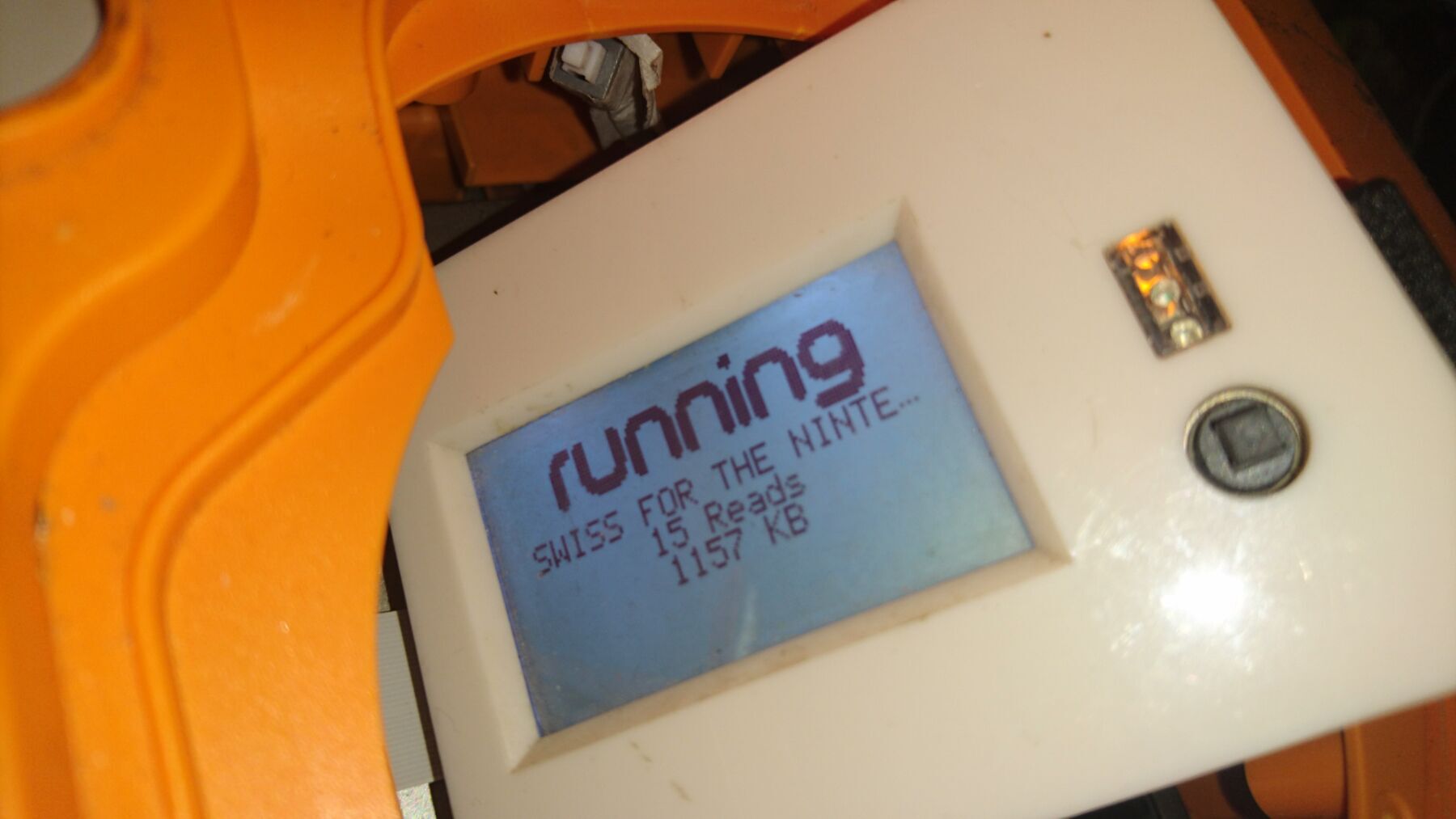

2 BOOT NGC With Swiss r241.iso Loaded by Wode.

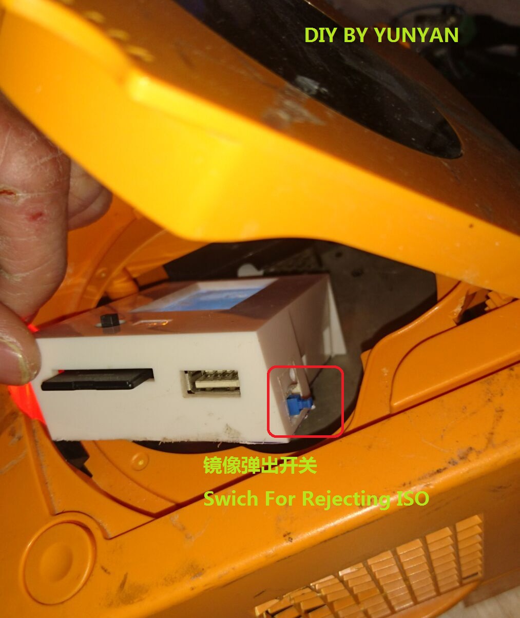

3 after GC succeed to boot swiss 241 ,Press "B" and see Down-Left on Tv, then pree "A ", a "Device-Window" will appear, then Choose "Sd Gecko", choose you Cheat Codes named "xxxxxx.qch".
4 Reject Swiss R241.iso (Use reject Swith DIY on Wode ),insteaded, Load the game.iso,
5 go back to Tv,then repeat pressing B and A, boot "dvd disc" in the "Device-Window" .
6 Press A 2 or 3times ,until you See the logo of the game, then press Y to open "Cheats-Window",Choose Cheats you want and Apply them with "Start",
7 Press A again Will start the game with the cheats codes you applied.

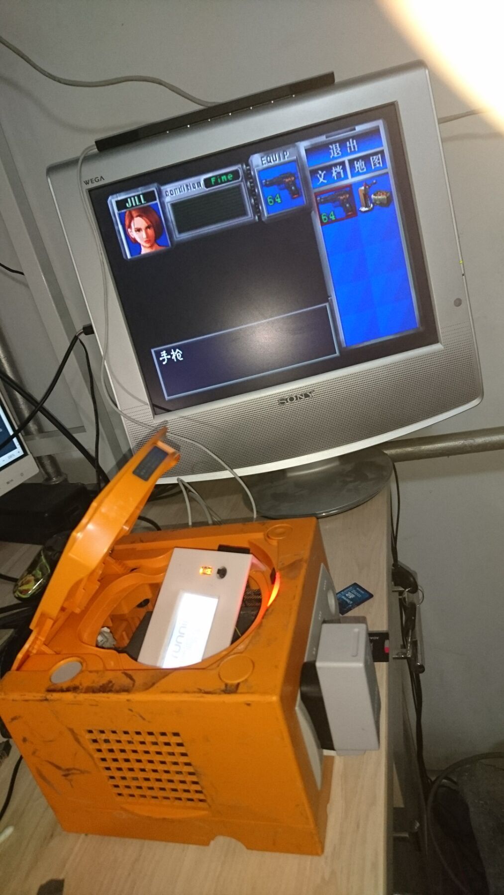

I think This Way Support Playing Gcgames with CheatCodes All methord, inculud Wiikey Fusion/ Wasp Fusion/ DVD-DRIVER/Wode JukeBox, But Not sure to Sundriver
