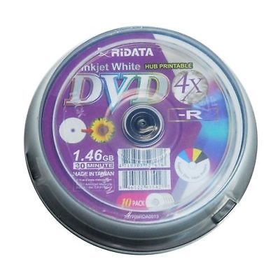

Hello all, I've been having issues with my GC giving me DRE with my ARMax, and on my backups using Ritek dvd-r discs via Swiss. Other retail discs work fine, and when I can get my armax to boot, swiss reads and boots the backups I have on double sided Sony dvd-r discs just fine. I'm at a loss as to why that is. I'm burning with braseo under ubuntu.
I bought the Ritek because they were cheaper and supposedly better, but it seems like I wasted money. The riteks are shown in the attached image in case anyone wanted more details on the exact ones.
(22.89 KiB) Not downloaded yet

What disc identifier do you get when you look at the disc info in something like imgburn?

emu_kidid, thank you for the reply. unfortunately, I do not have a windows machine to run imgburn, and cannot seem to get WINE to run imgburn properly. is there another way I can obtain the information you require?

`dvd+rw-mediainfo` should show that information for you.
