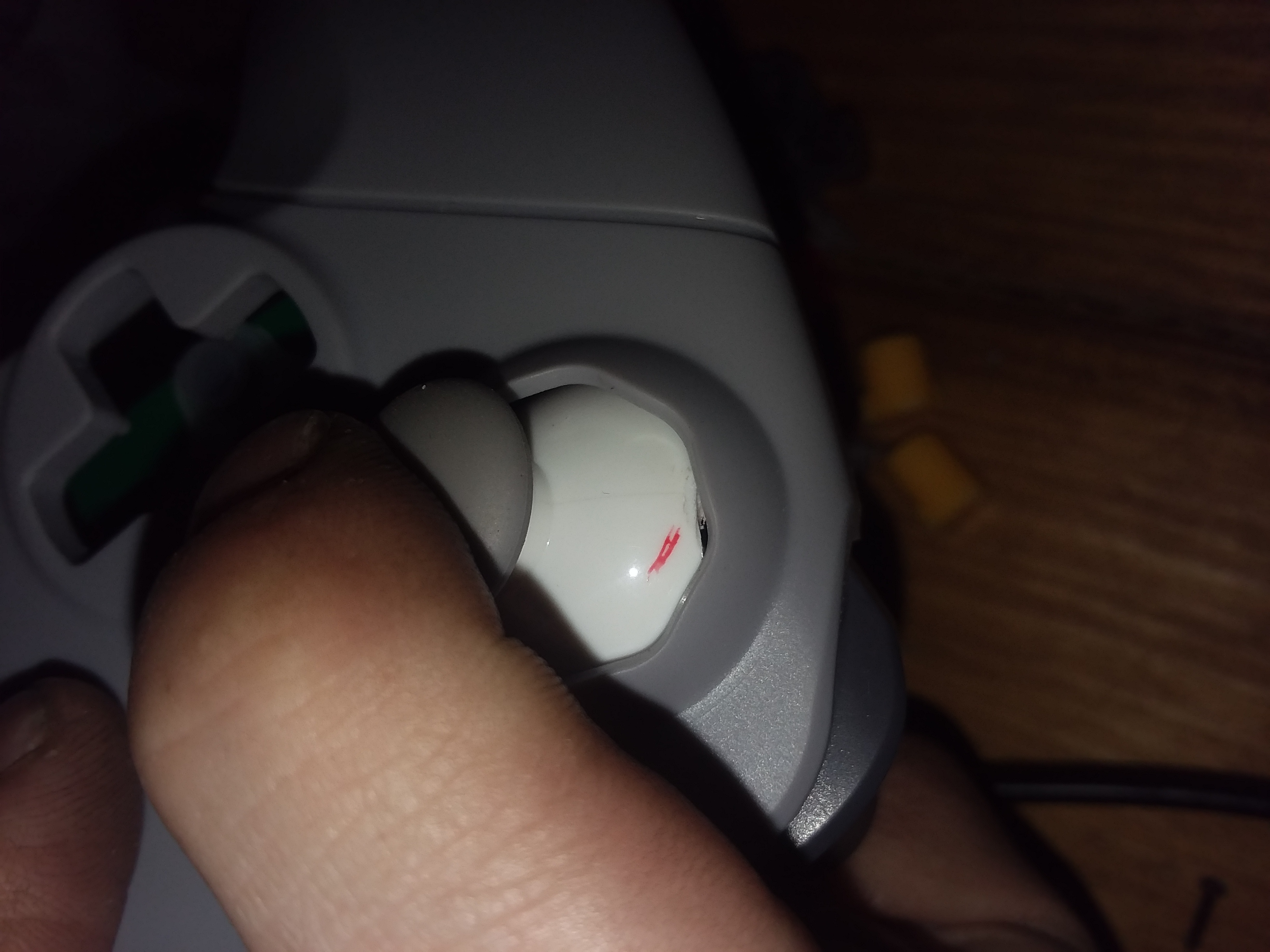

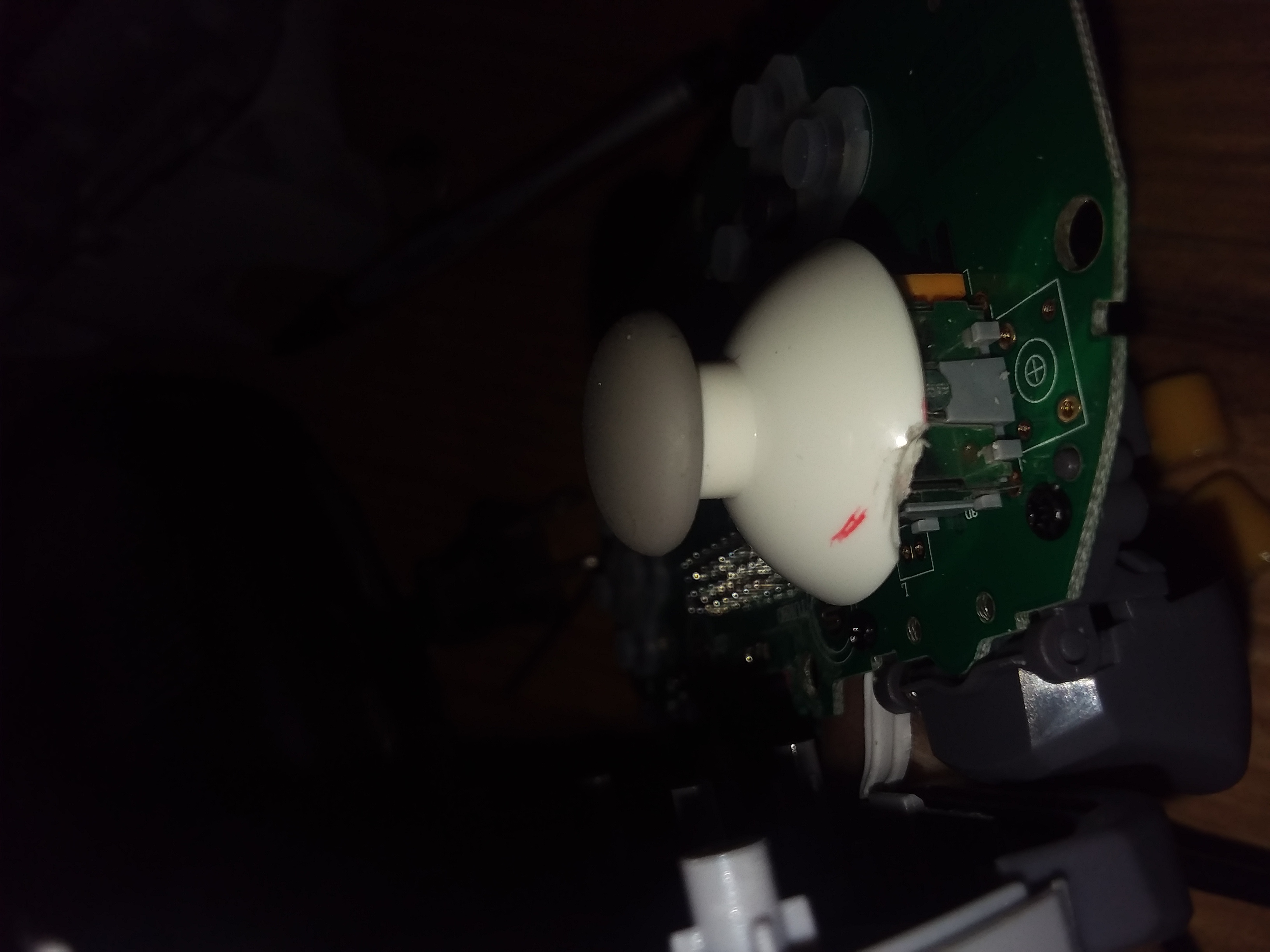

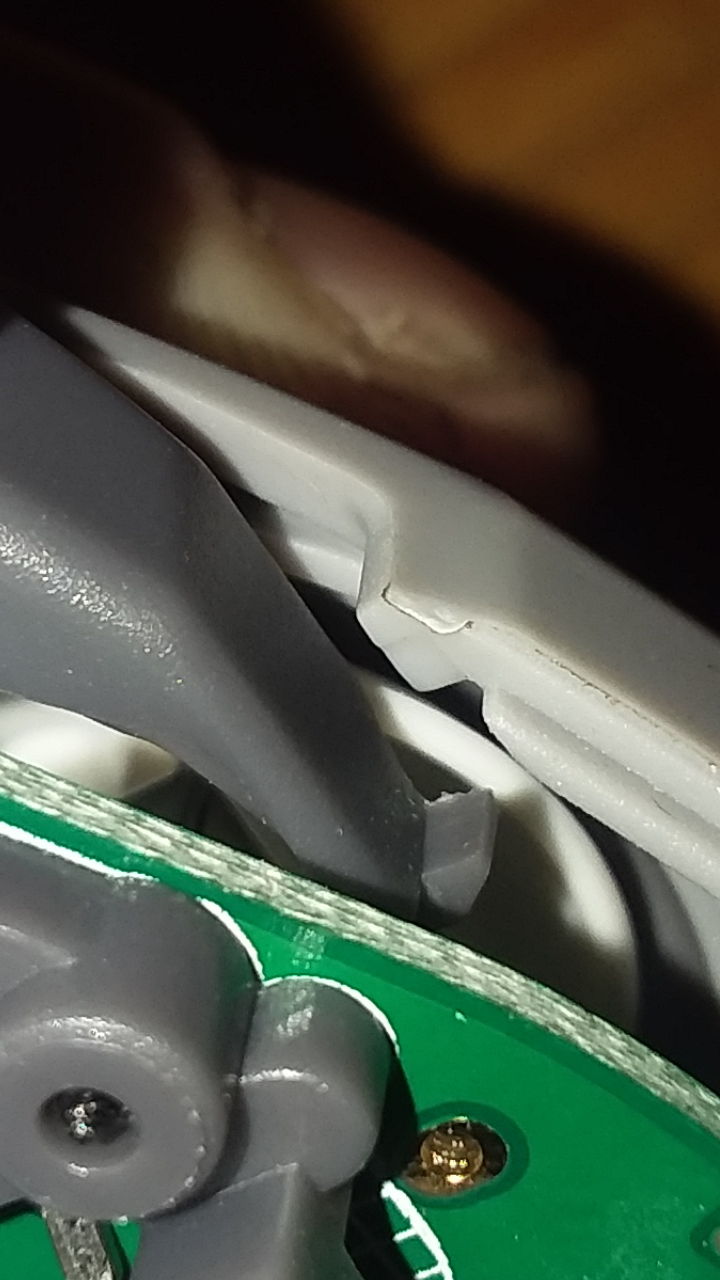

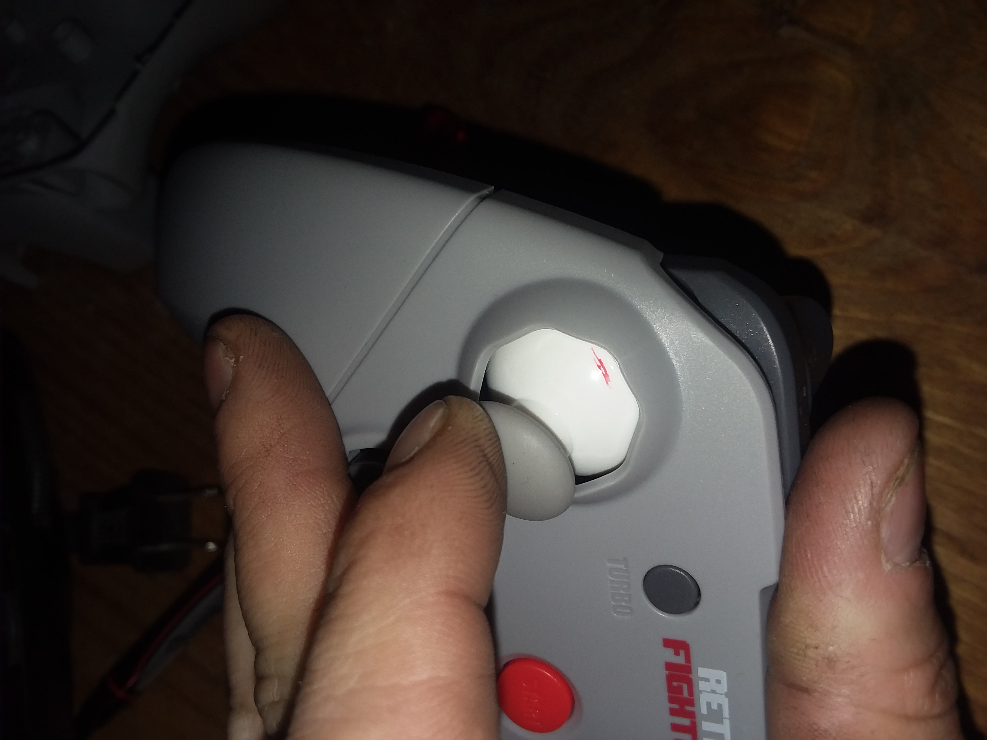

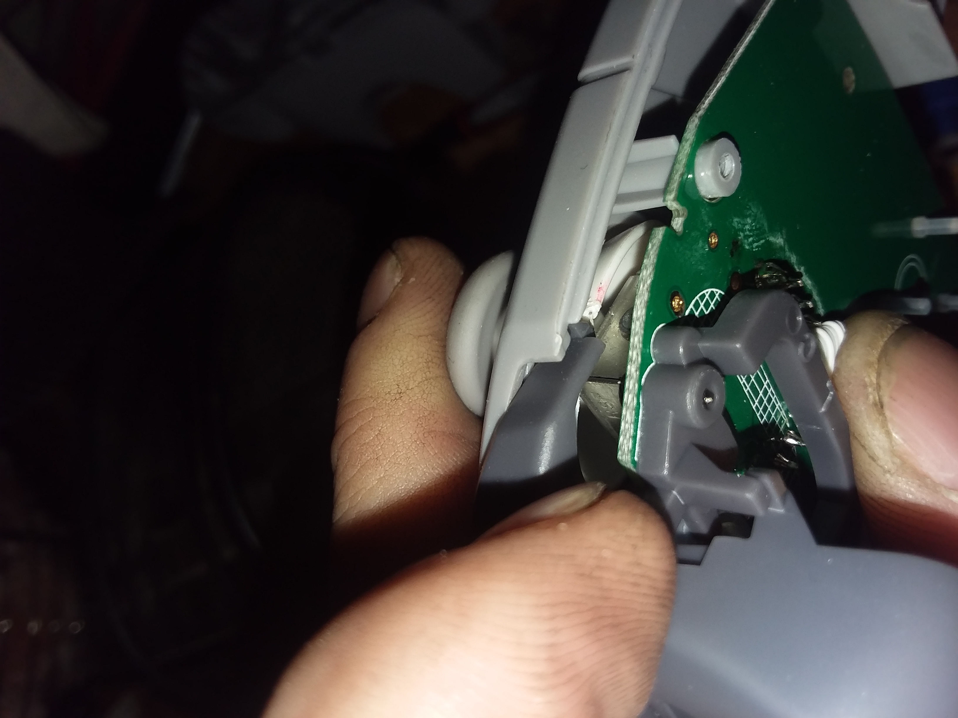

I found the part of the joystick that hit the L trigger so I used my dremmel and took some of the skirting off. I took a little much but I was in a rush as you can see from the pictures.
Should never have to use L and the joystick at the same time but it was a complaint so I fixed it

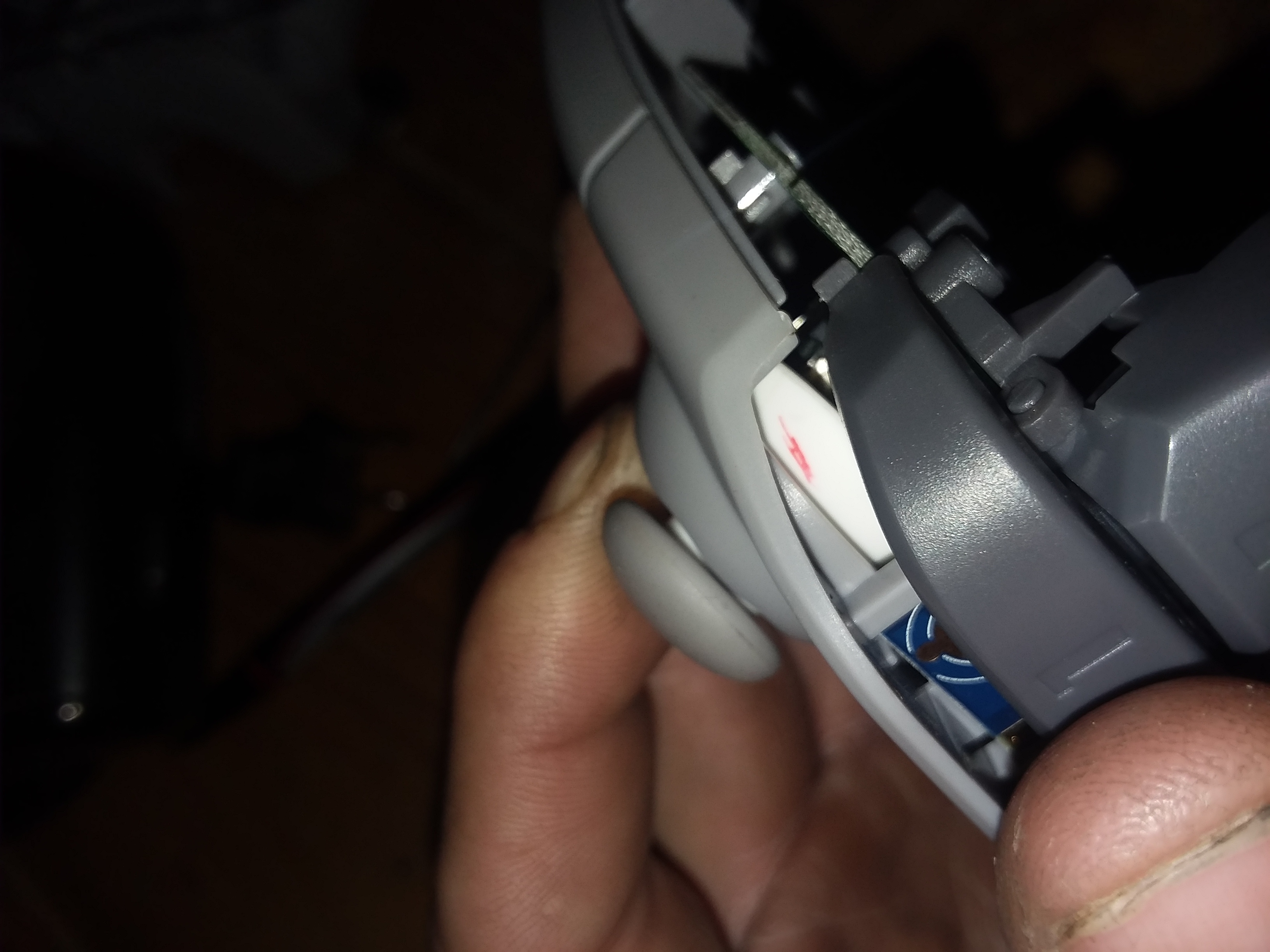

No the caps can not change. But I have found a better way to fix the issue just no way to contact them.
They just have to slightly change the L trigger. It's about 3 mm longer then the shell of the controller and has a hook/ stopper. If they took the hook part off, shortened the trigger just a tad and added a bit of plastic protruding in the middle of the L trigger 'inside the controller shell' the hook would no longer be needed and it would have all the clearance it needed.

Sorry for the mechanic hands in the pictures. I had just got home from work
