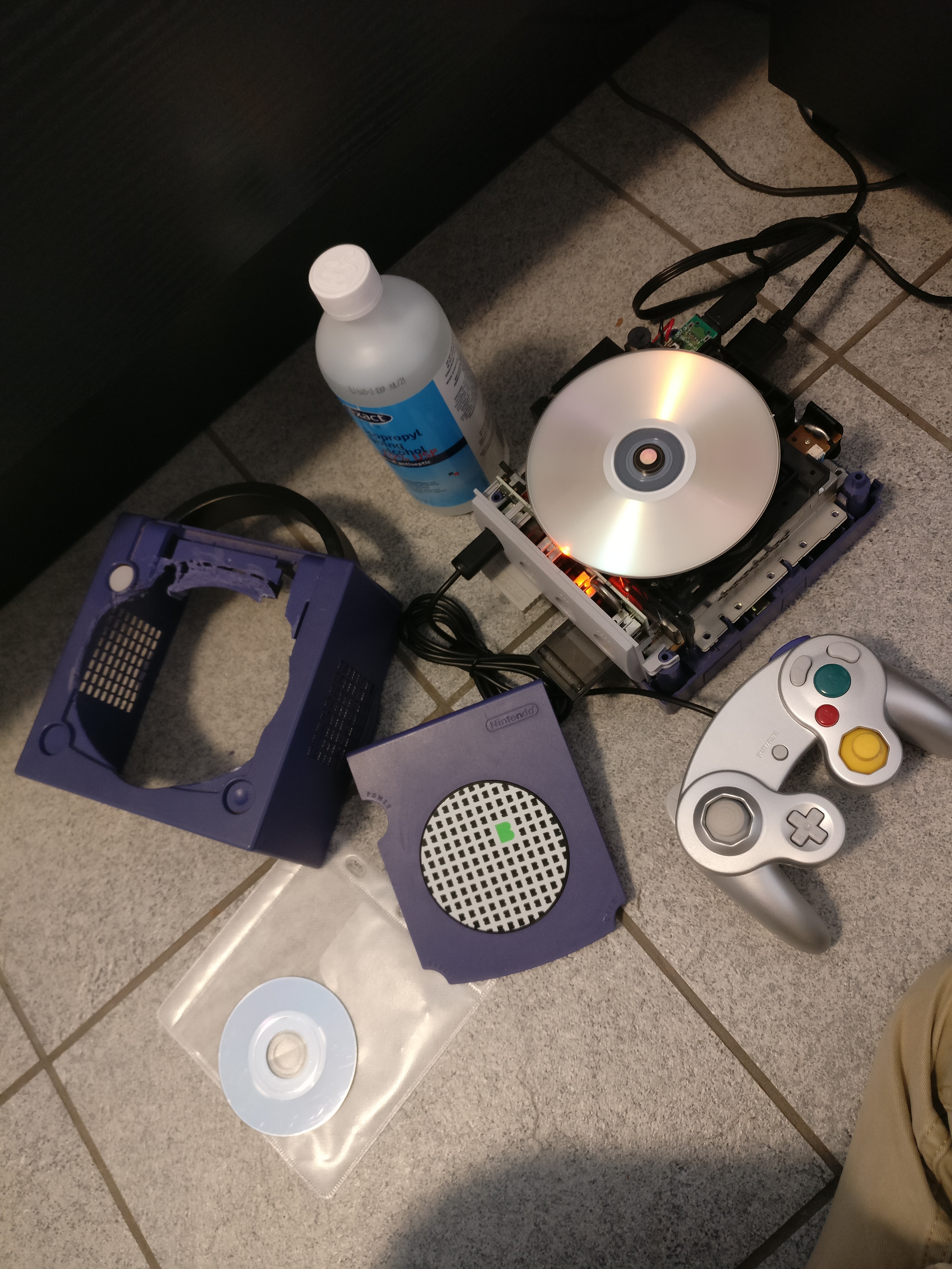

Im back! University and stuff has got me busy but i finally got the chance to thinker at the gamecube. I cleaned it with some iso alcohol and it works!!!
The bad news:
Itll only read discs under 20 ohms.. How long will my laser last like this? Is it doomed to fail in a few weeks?
Thanks!

Attached here is a picture

Nvm... 2 minutes into the game the disc stops spinning and says an error has occurred and to restart.. What now? Is the laser too weak?
