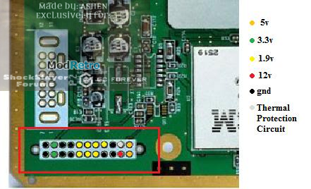

ok i tested the power board and all fuses are good, the voltage i'm getting on the board is 11.77 VDC and 1.88VDC on the board is that normal?
Re: need help with repairs urgently
- (241.68 KiB) Not downloaded yet
