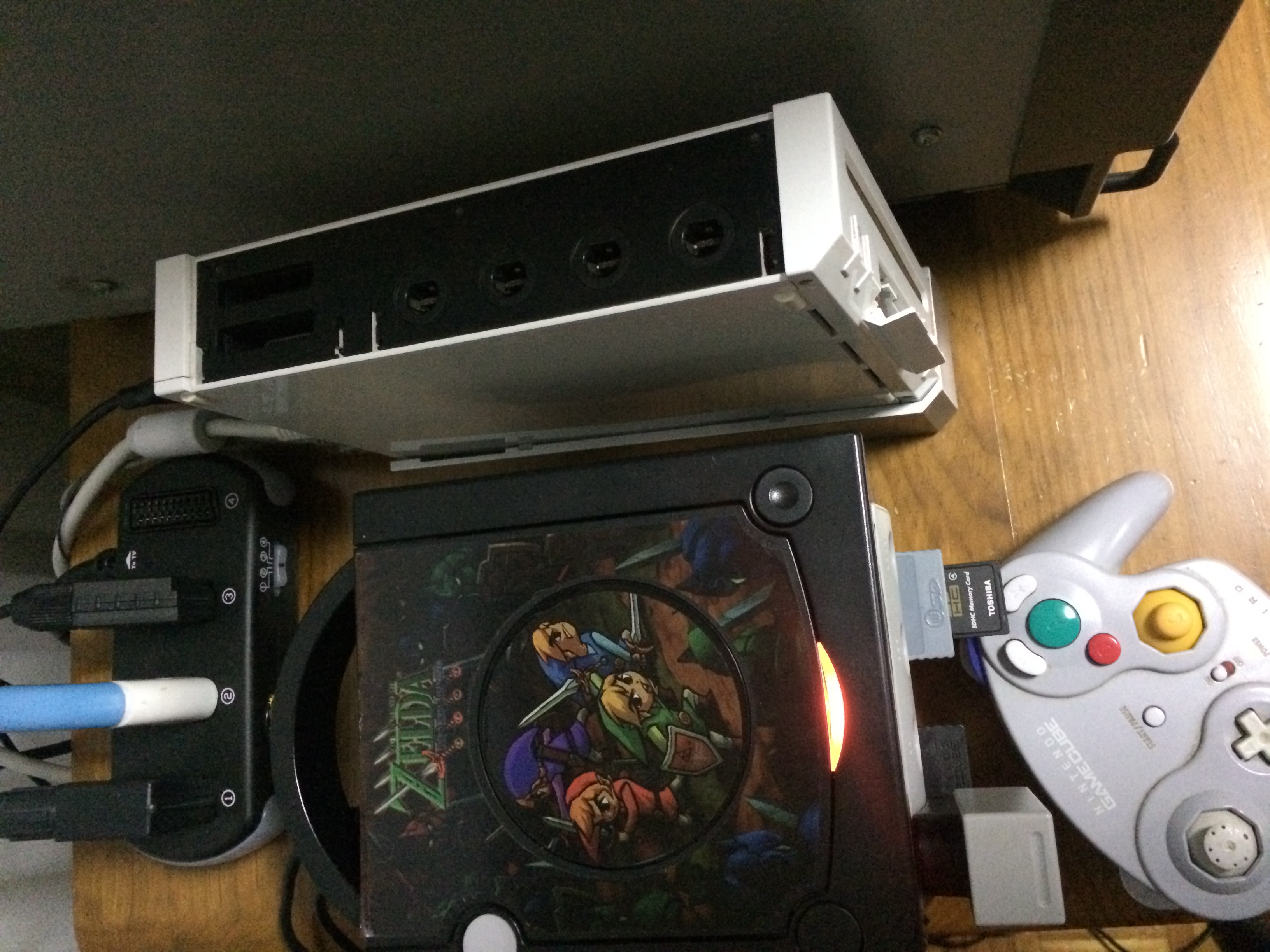

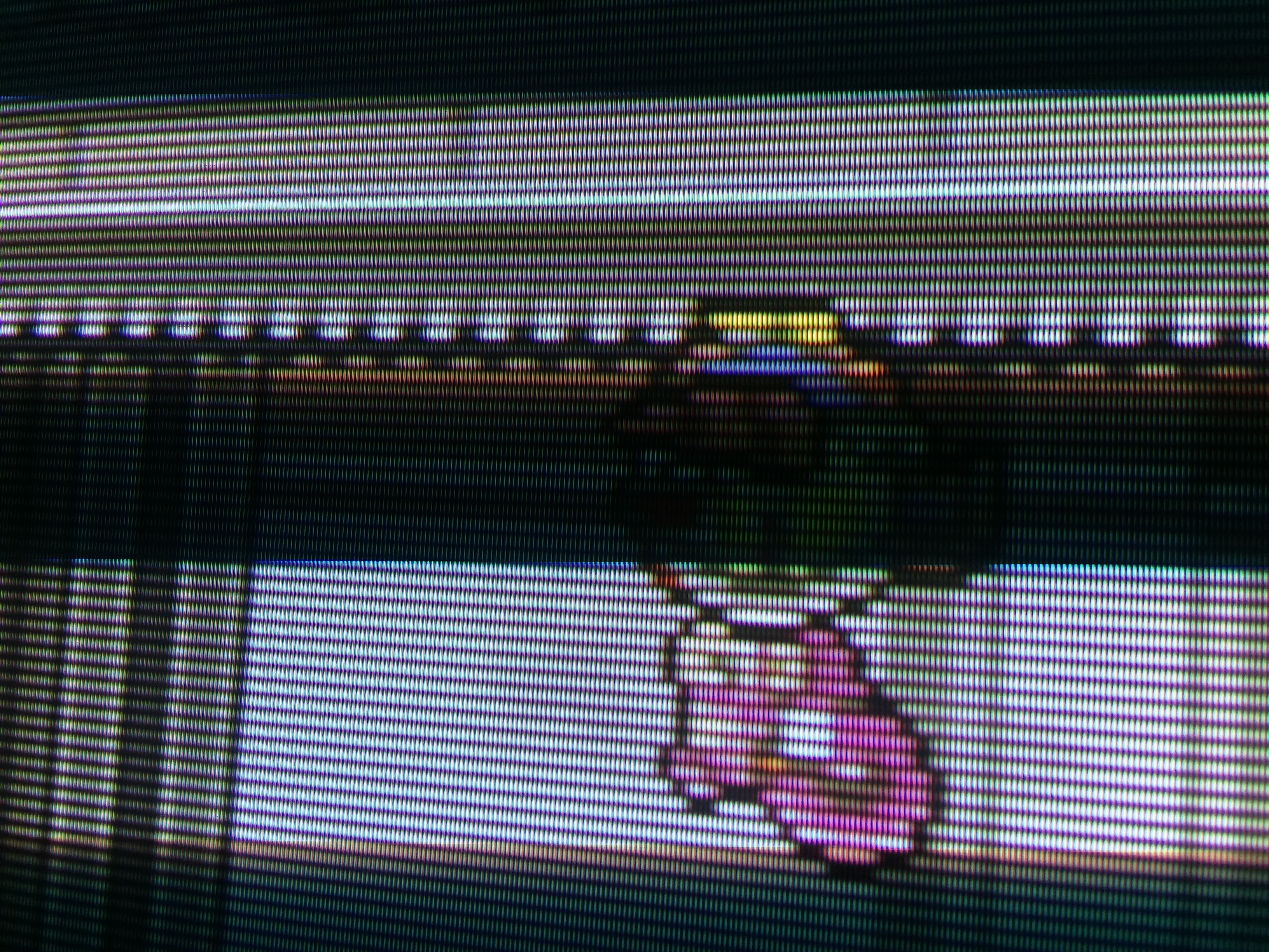

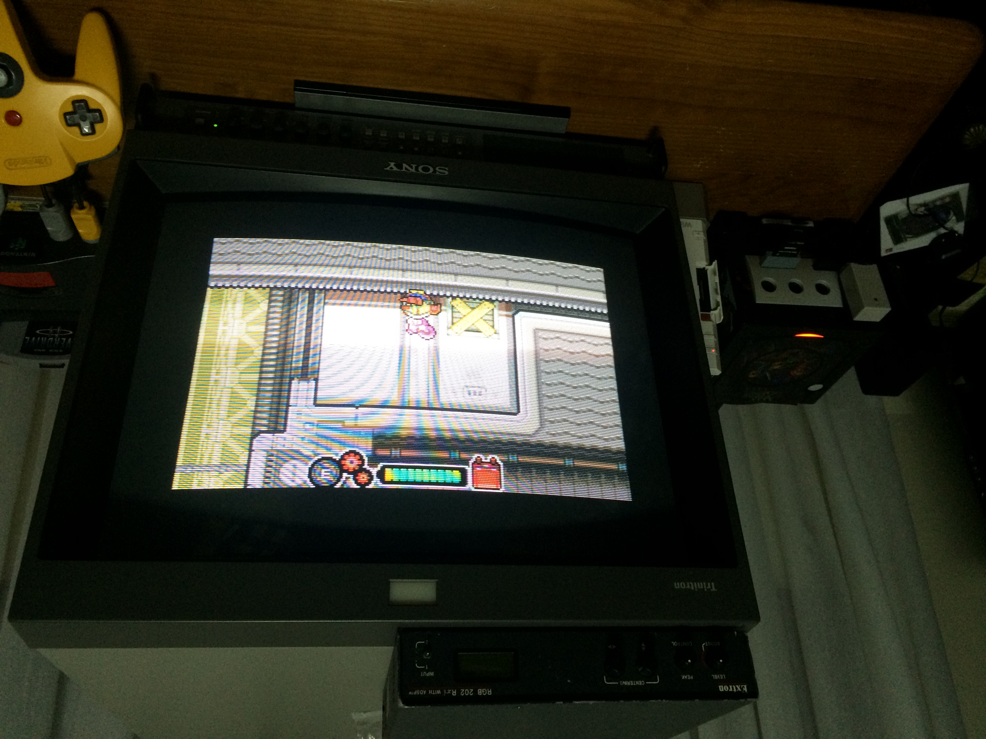

PVM-20M2E.
I have a scart switch that connects a wii, gamecube and RGB modded N64 to the PVM.
The pictures were taken with the phone.
All systems go

scanlines bliss
