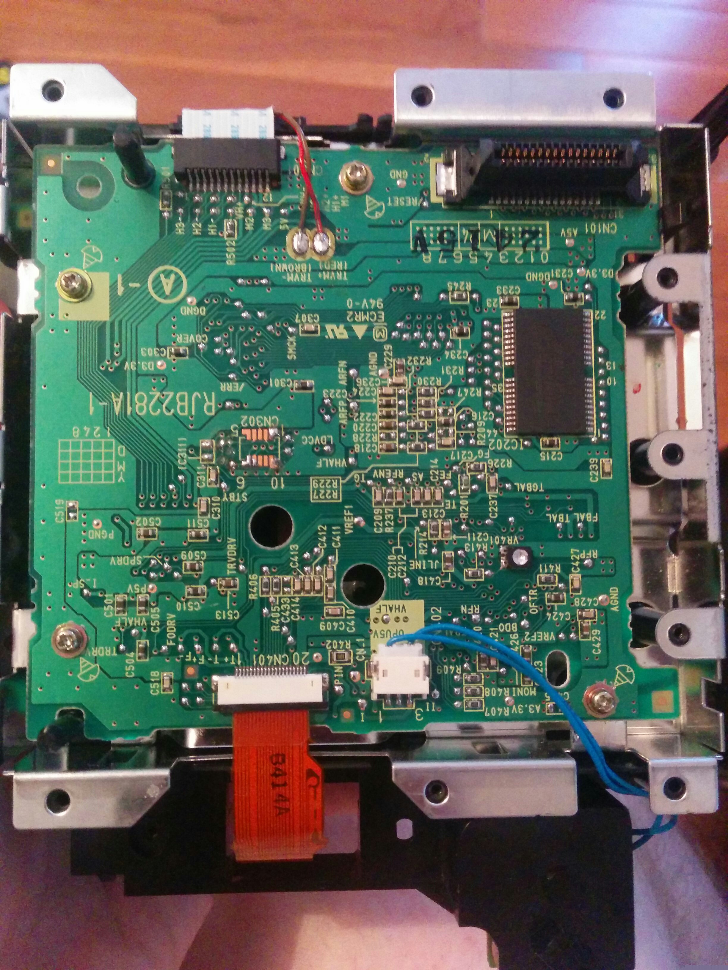

Hi all,

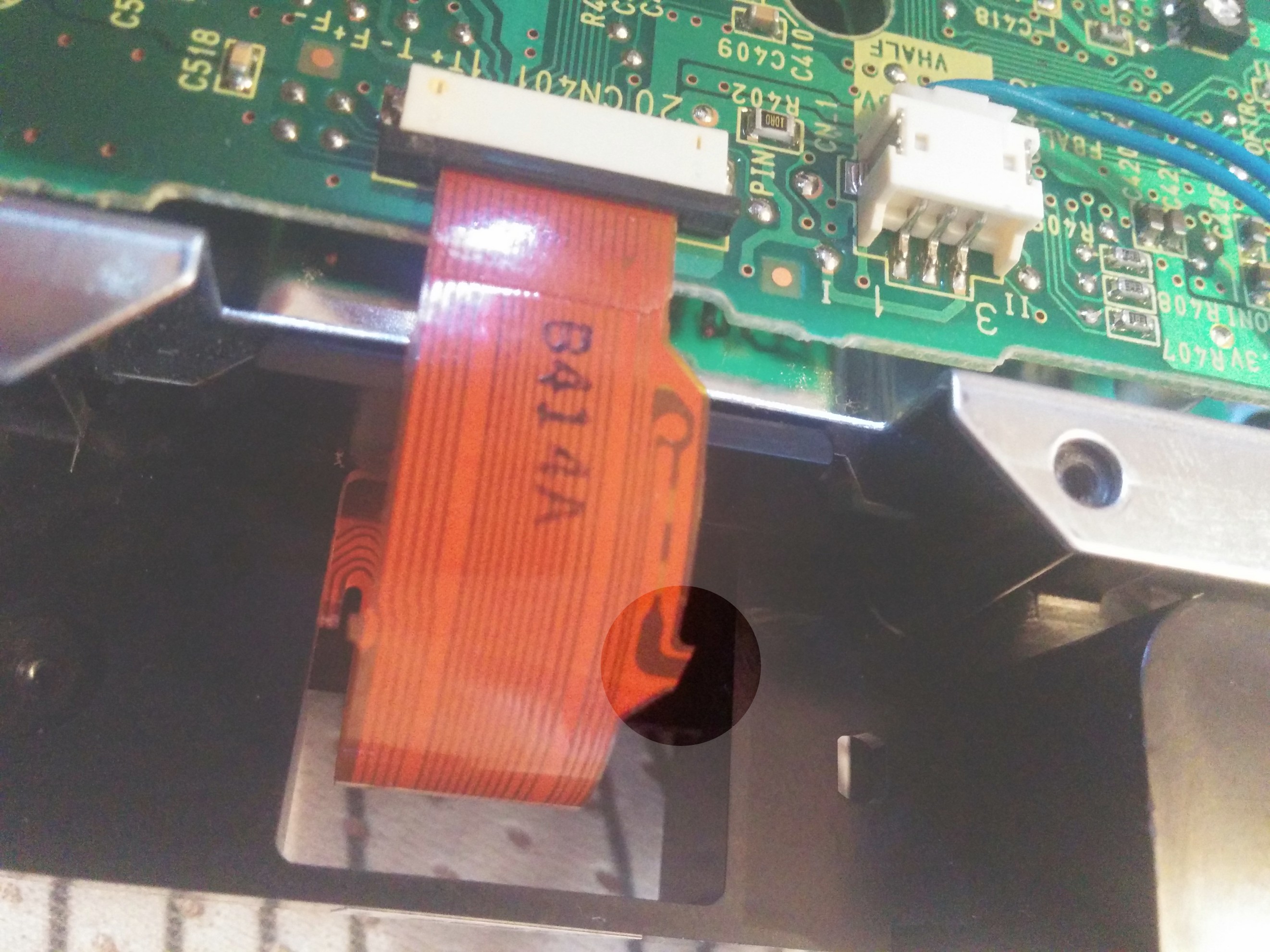

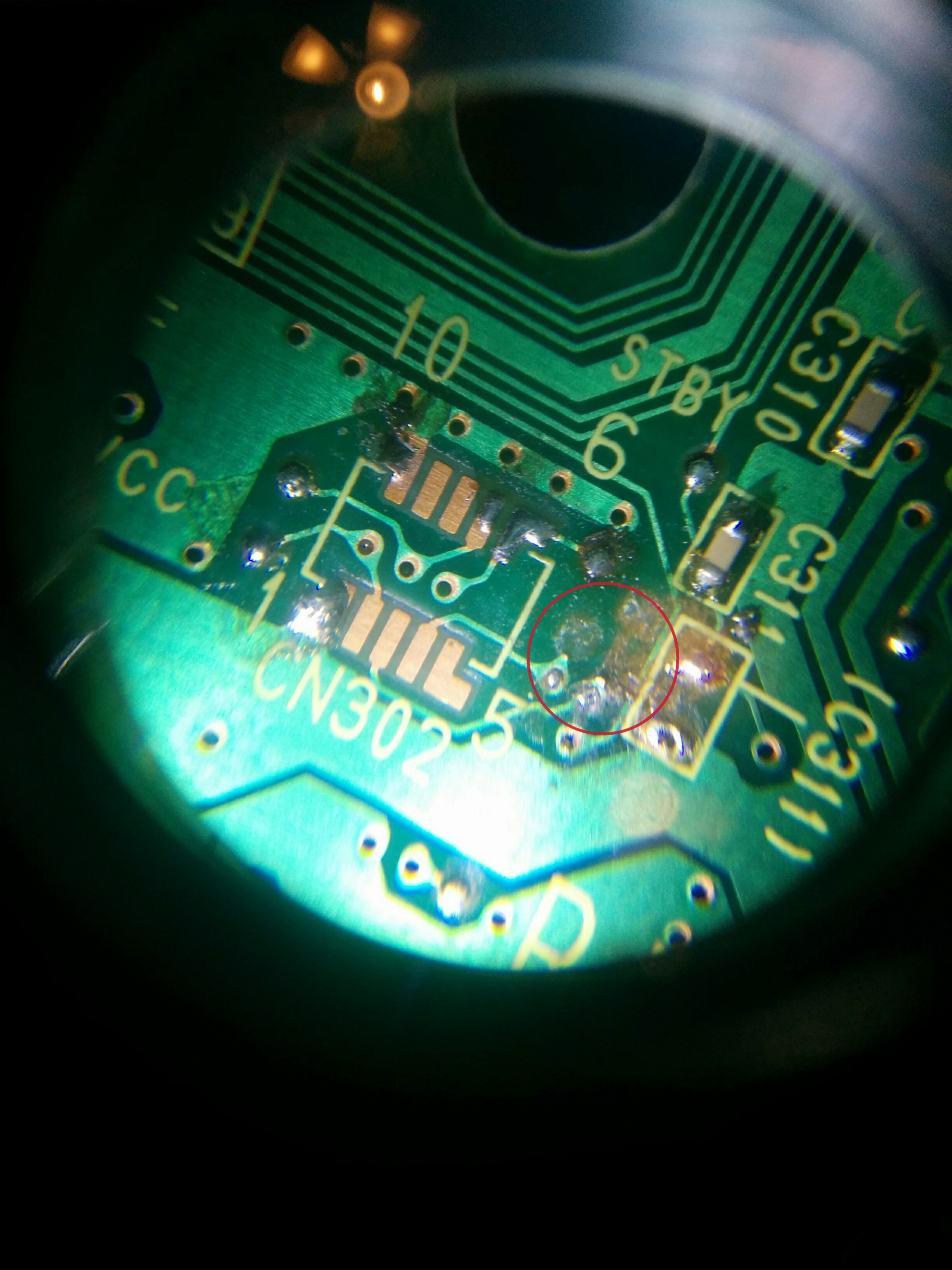

New to the modding scene and trying to figure out how I totally f'd up a gamecube. Here's what happened, tried to install a xenogc on a working gamecube, long story short I lifted a few traces on the mobo. For a while I was able to get it to turn on, but no video. I went back and checked for shorts I could have created when I was previously attempting to install leds on the controller board and everything was fine. I checked the controller boards cable, everything was fine. I checked the fuses on the power supply, both are good. Now all I get is the power light on for a second then off and the fan stays on. I need some help figuring out if this is definitely the disc drive or not, and if I can fix it. I also have noticed something with the disc drive ribbon cable that I wonder is an issue or not

Does the GameCube boot up without the drive, if so, it's your drive.

Post by Damiken » Mon Aug 17, 2015 2:35 am
No it doesn't boot without the drive so that's the confusing part :?

Post by emu_kidid » Mon Aug 17, 2015 7:22 am
You have a short somewhere for sure, look for lose debris on the GC mainboard. Don't have the drive plugged in, it's not required to get video out.

Post by Damiken » Mon Aug 17, 2015 1:20 pm
Thanks, this was driving me insane but I figured it out, its the cable on the controller board. I must have touched it with the end of my soldering iron and melted the plastic a bit causing a short. Easy fix :D
