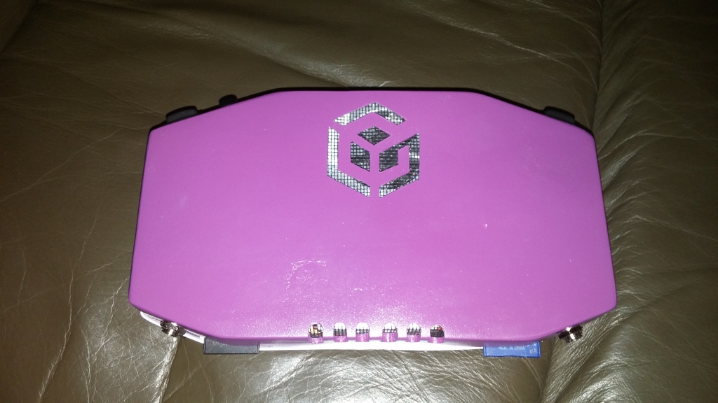

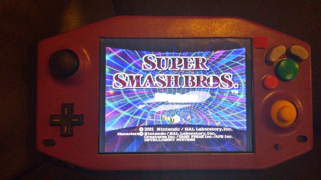

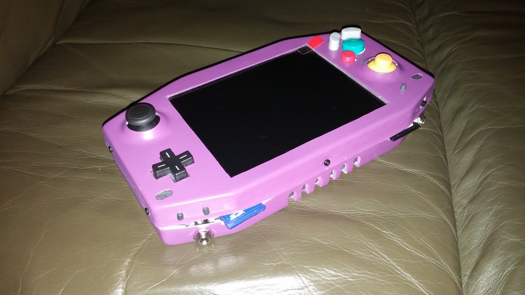

Hey guys,
I wanted to take the time to show off my latest portable Gamecube the Pixie Cube. It's design is inspired by Ashen's past designs with a little of my own flare added here and there. I had a great time building this one, as it was my first foray into vacuum forming and I am very happy with the results.
Features;
5.6" Dalian Good Screen
Component video chip VGA Modded for 480p video
Trimmed official Gamecube controller
Double tact modded L and R buttons
Full Range Analog Thumbsticks
Vacuum formed case with mold designed by me, but inspired by Ashen
7.4v Lithium Ion battery pack at 4000MAH
Wasp Fusion Modchip with 64GB SD card for storage
Built in 1000 Block Memory Card
Slot B SD Gecko
Zenloc's custom regulator. 1.8v, 3.3v and 5v
IBM Thinkpad Heat Sink
Measures 8" (W) x 4.5" (L) x 1.5" (D)
Thanks for looking! Feel free to leave any feedback for me below.
