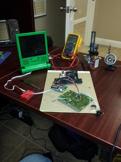

Post by marcus9199 » Mon Apr 14, 2014 9:51 pm

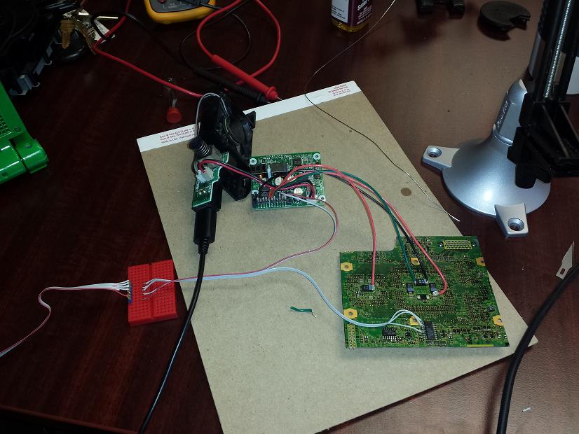

Got Controller port connected and Bios battery both working.
(65.87 KiB) Not downloaded yet

Post by marcus9199 » Thu Apr 17, 2014 8:16 pm

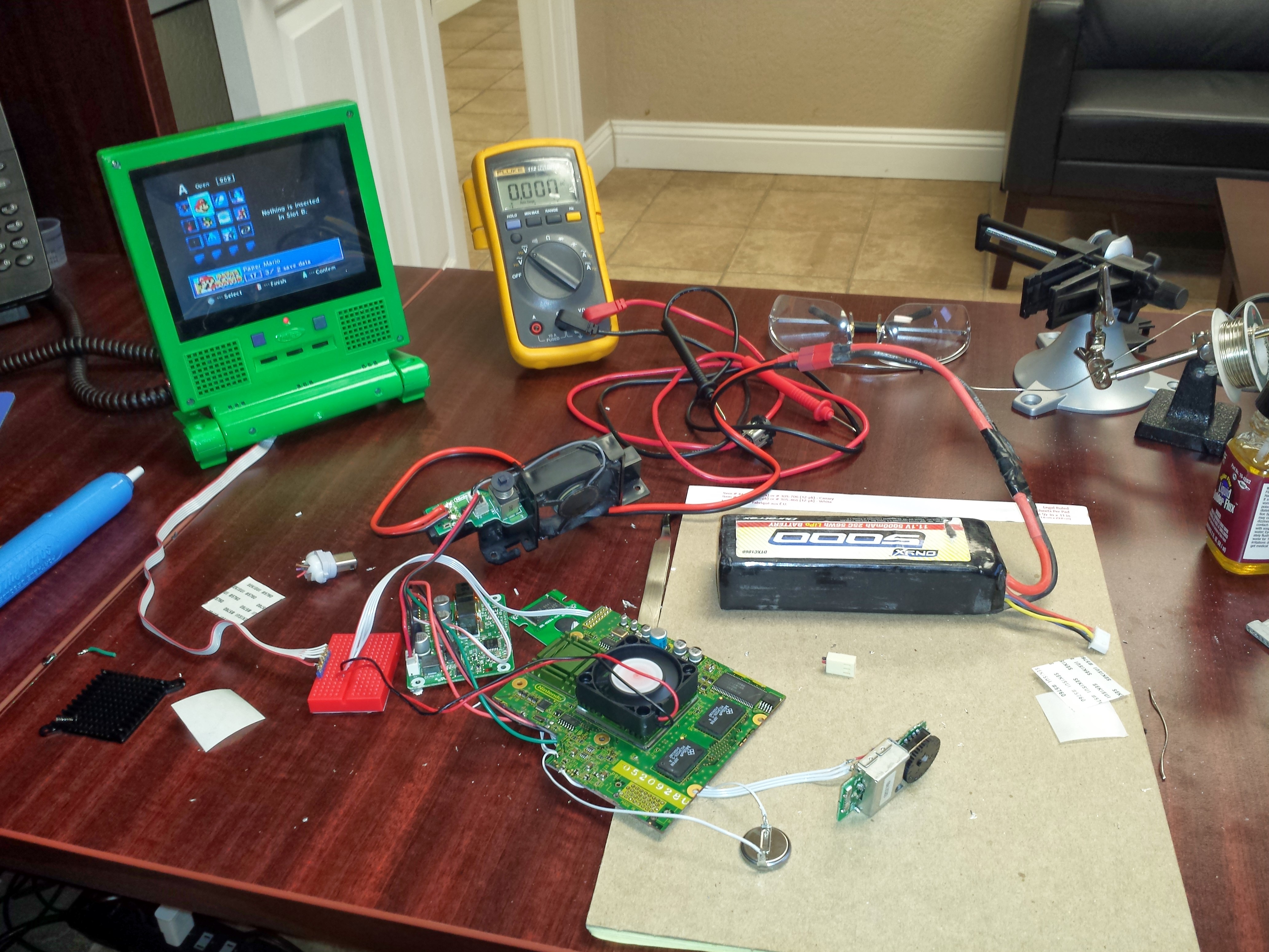

Made some progress. now have wavebird wired in mem card hardwired. and found a vga heatsink and fan that so far are keeping things cool.
(77.04 KiB) Not downloaded yet
My wife took my Beer Away!!!!
Re: WIP Gamecube All in One
Post by novenary » Thu Apr 17, 2014 9:55 pm
Is it just me or the CPU and RAM don't have cooling ?
Post by emu_kidid » Fri Apr 18, 2014 2:42 am
yeah, you'd want to cool the CPU and RAM for sure!

I do have a fan on the CPU now not in the picture though. How hot does the ram get? Would passive cooling work? Or do they need a fan also?
Post by megalomaniac » Sat Apr 19, 2014 2:23 am
use the heatsink + fan
...and post some larger pics if possible...

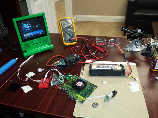

Post by marcus9199 » Sat Apr 19, 2014 3:38 am
Here's a Higher Res pic. I will take more soon as I can. Thanks for the advice guys.
(1.91 MiB) Not downloaded yet

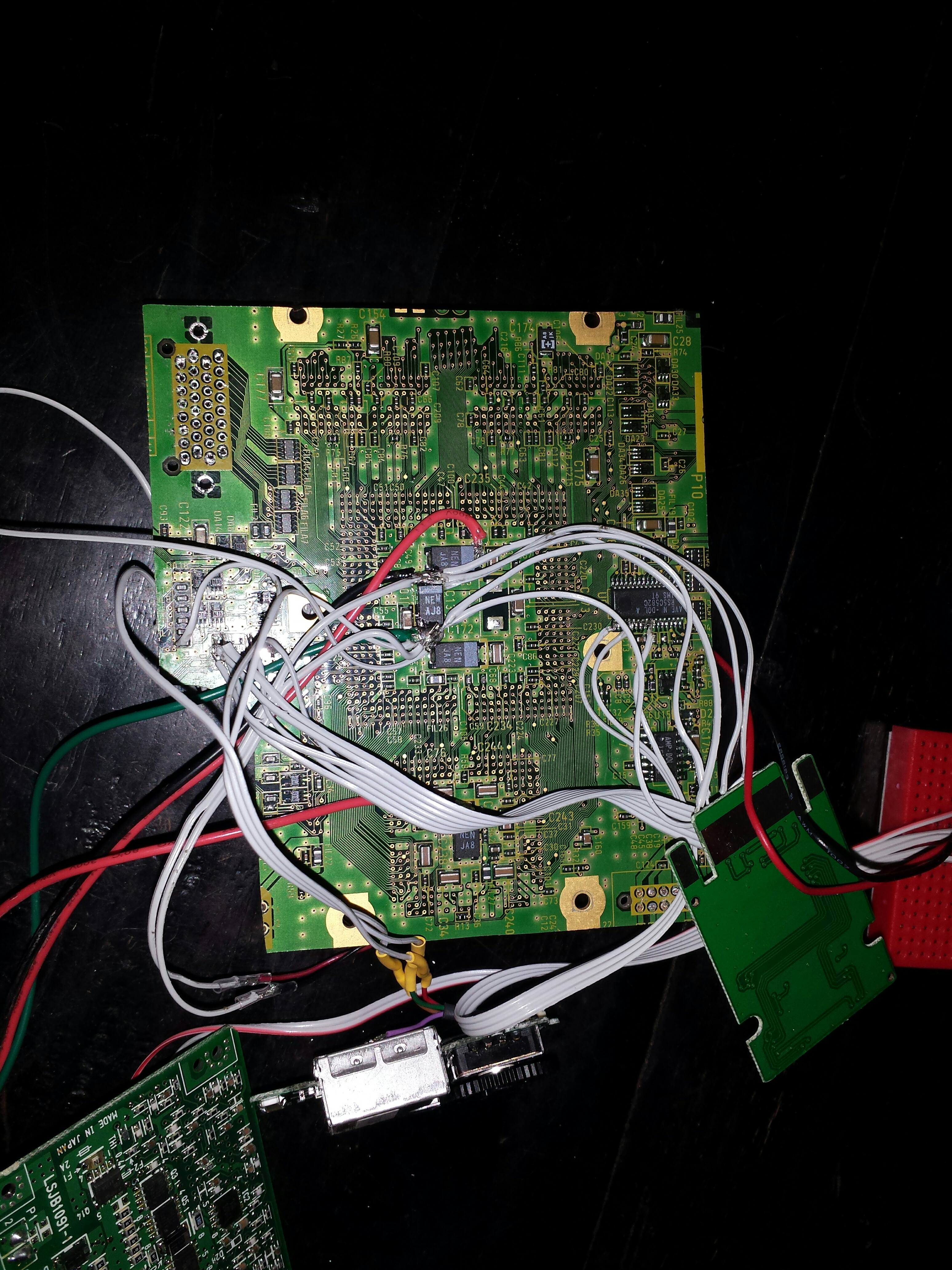

Post by marcus9199 » Sat Apr 19, 2014 4:35 am
A few more high res. My solder skills are terrible so go easy on me. But any advice is much appreciated.
(1.31 MiB) Not downloaded yet

RAM can have passive cooling, that's fine.

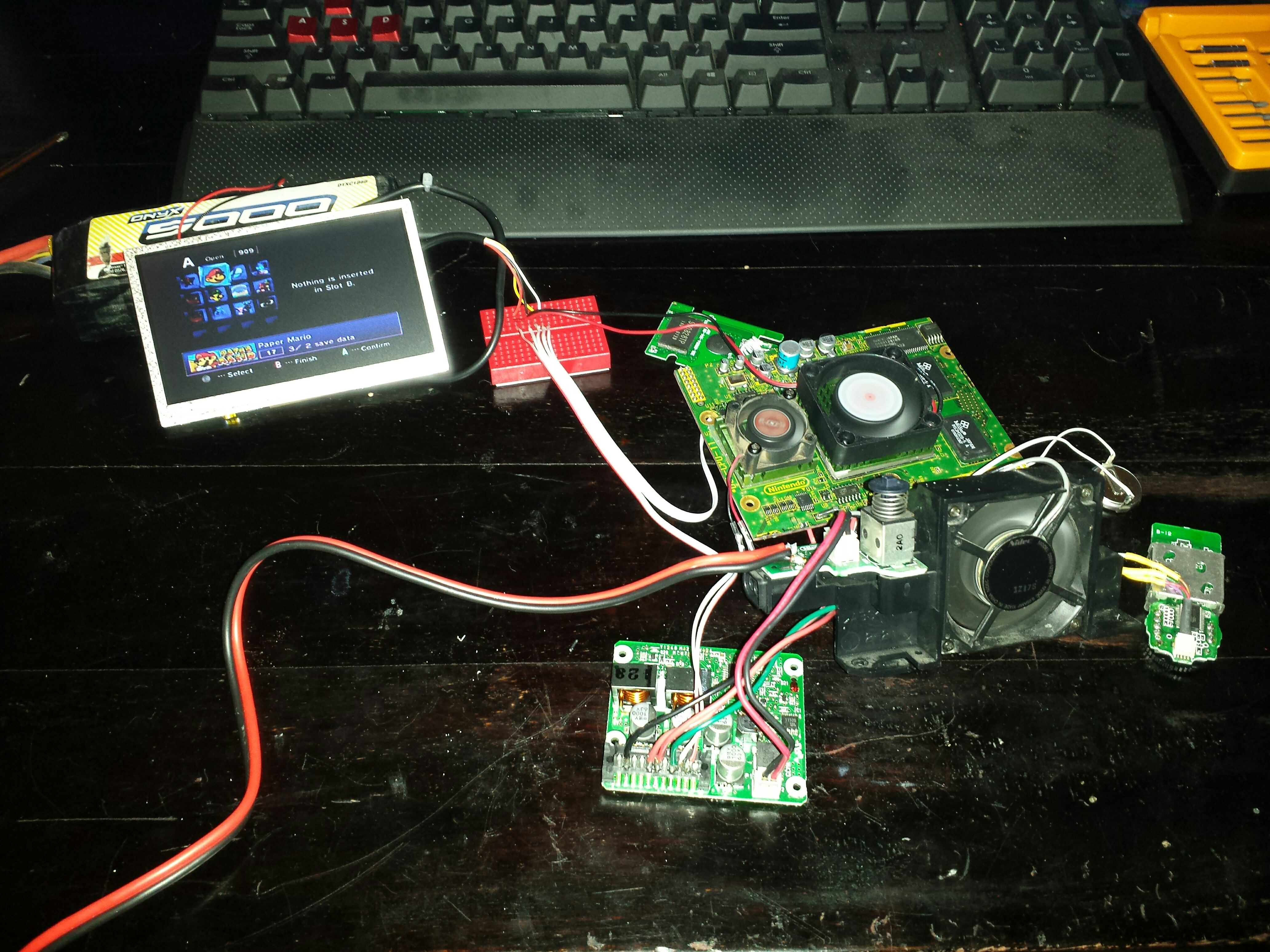

Post by marcus9199 » Sat Apr 19, 2014 4:44 am
One more with newer screen.

Okay I think I'm going to invest in a laser thermometer. What is a decent temp for the cpu gpu and ram to run at? I think I might just go back to a modified stock heat sink or find and IBM one. I don't think these have the surface area they need to keep up.

Well, there is one advantage to have a unibody heatsink : heat spreading. With a bigger heatsink your components will dump their heat into it and it will help balance the temperature. So for example if the CPU is pretty hot but the GPU is nice and cool, part of the heat will go into the GPU before it's dissipated. This also help because silicon has an optimal working range that is higher than ambient temperature.

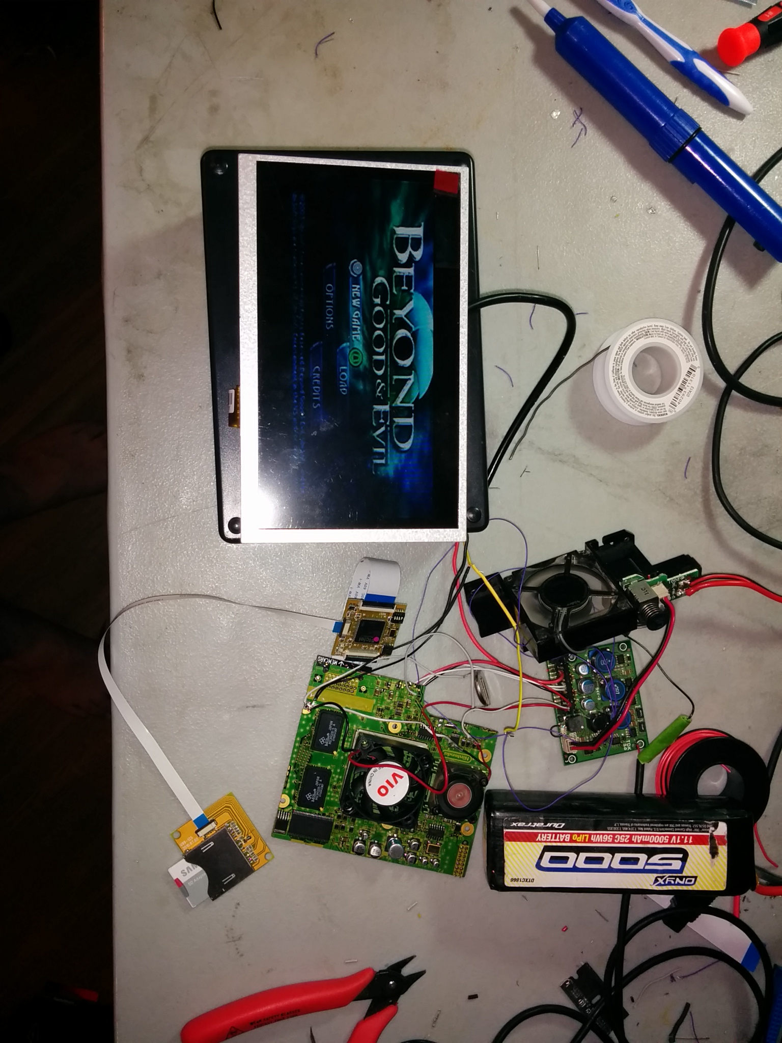

Post by marcus9199 » Thu May 15, 2014 4:16 am
Okay I know this is pitiful concidering how long I've been working on this but I got my first successful boot of wasp key fusion
(2.16 MiB) Not downloaded yet

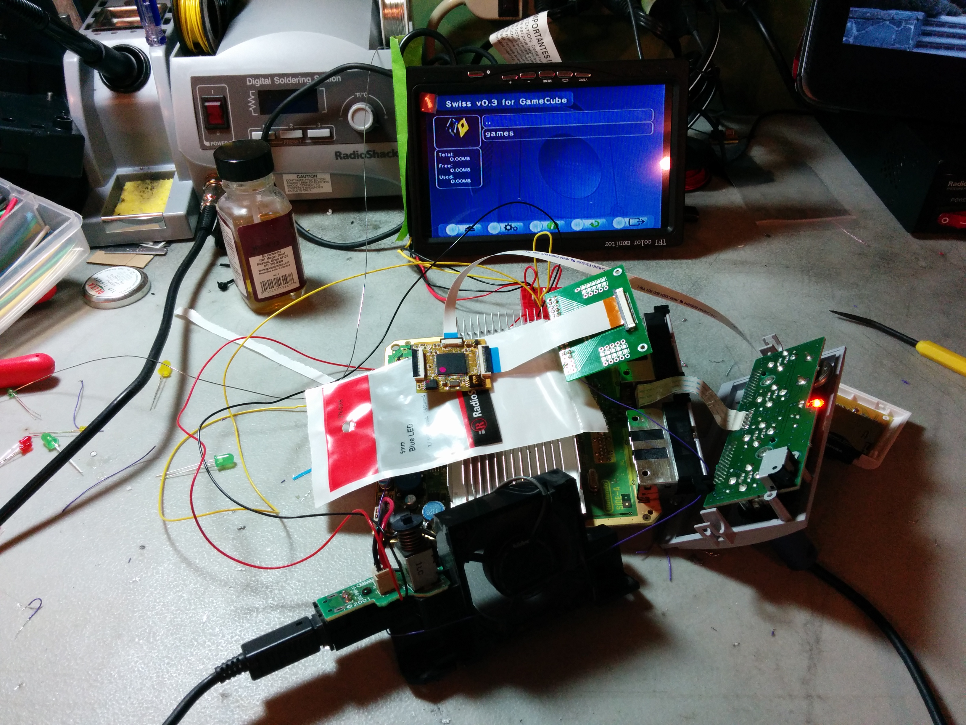

Post by marcus9199 » Tue Jul 22, 2014 4:39 am
Thanks to mega drive v.5 it LIVES!!!!!!
(816.01 KiB) Not downloaded yet
