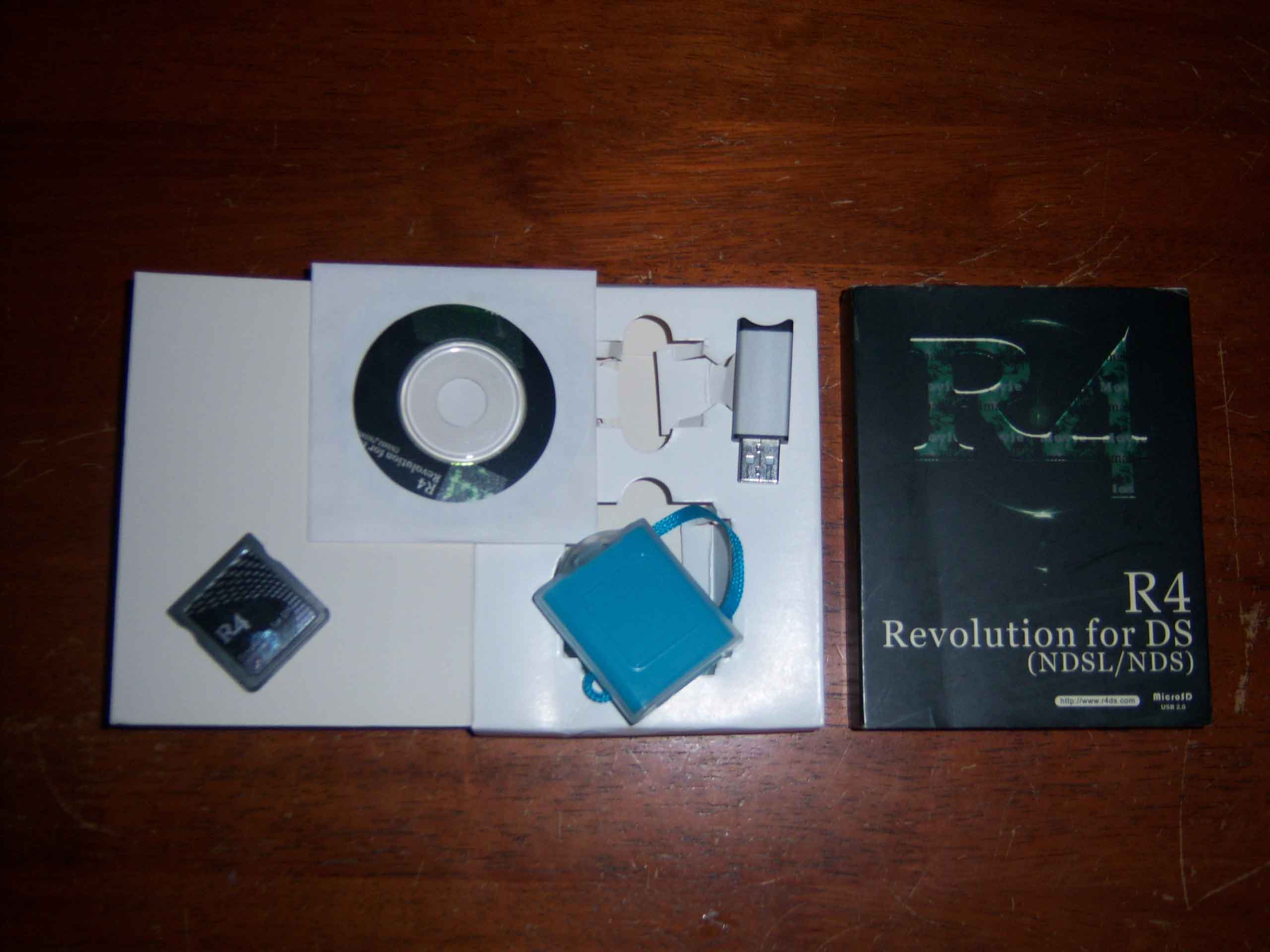

Does it look like this one in my picture? Its a tempermental card. Some of the wood firmwares don't work, some do. For my card, I use WoodR4 .... not WoodR4iDSN or WoodR4i. And not the RPG one or the .NDS one. Whatever the heck that is. I can run WoodR4 v1.58 (the newest) but a few others fail like the ones in the v1.55 range and most of them that 'fix' pokemon games. My R4 also can't use SDHC. So anything 2GB or less is fine. HOWEVER I have one 4GB card that works fine but only that one card. Someone tried to explain it once to me about trans flash something or another. I didn't get it. Try different firmware versions. Wipe the card between each test. Use 2GB cards. Good luck man.

siphoned wrote:Does it look like this one in my picture? Its a tempermental card. Some of the wood firmwares don't work, some do. For my card, I use WoodR4 .... not WoodR4iDSN or WoodR4i. And not the RPG one or the .NDS one. Whatever the heck that is. I can run WoodR4 v1.58 (the newest) but a few others fail like the ones in the v1.55 range and most of them that 'fix' pokemon games. My R4 also can't use SDHC. So anything 2GB or less is fine. HOWEVER I have one 4GB card that works fine but only that one card. Someone tried to explain it once to me about trans flash something or another. I didn't get it. Try different firmware versions. Wipe the card between each test. Use 2GB cards. Good luck man.
Yeah thats exactly the one. Only says "Upgrade". Might've been the SDHC Upgrade but i'm not sure anymore. I'll test the 1.58 - thanks!
btw if you say you dont use the nds or _rpg one - which one do you use?
