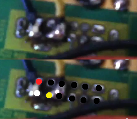

do not power on your GC / monitor anymore till you correct the issue....
i grabbed this photo from your youtube video
compare the pins you soldered together in the top photo compared to the red white yellow dots i placed in the bottom photo
ignore the black dots, those are just markers to help show all 12 pins on the board

Re: Tft screen issue. Urgently need help!!
On my 3.5 inch screen, when i only wire the yellow pin i get black and white. Only with the other pins did i achieve color.
