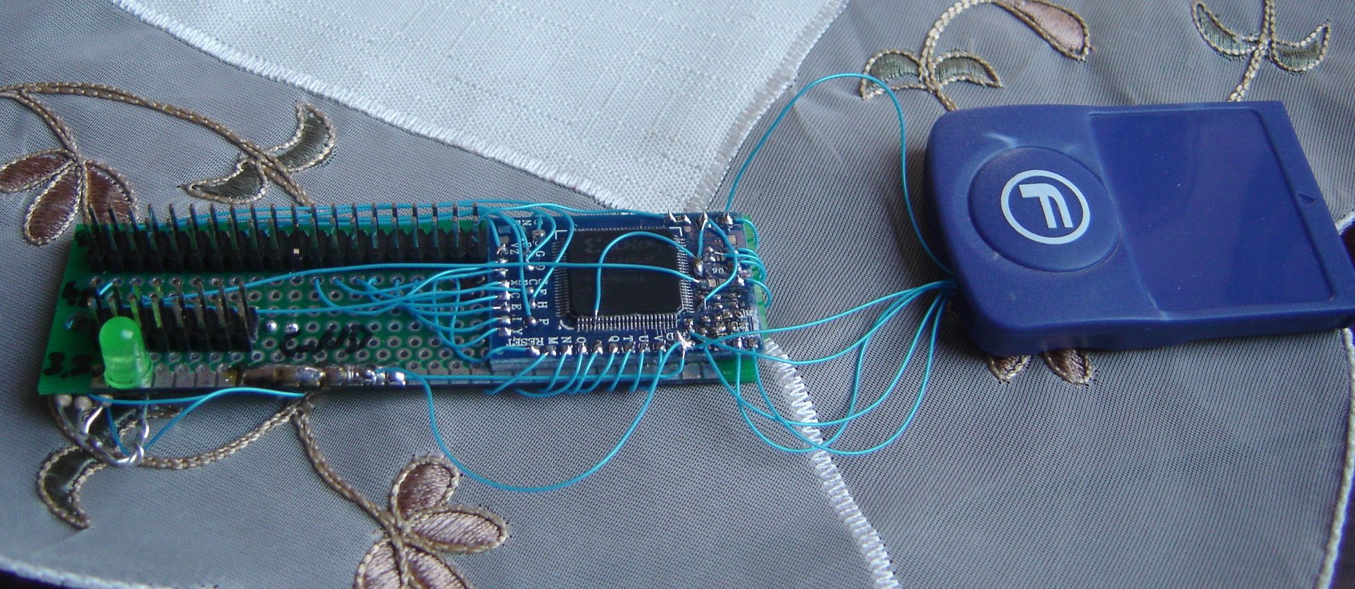

Post by emu_kidid » Wed Oct 27, 2010 4:49 am
status update:
I've built my adapter but I must've screwed up someplace, I'm going to re-check connections and try again tonight :)
Re: Homebrew HDD adapter for Gamecube Tutorial
Post by emu_kidid » Wed Oct 27, 2010 8:16 am
Got it working :D
Time to implement it into the new SD-Boot.
I had too many pins on the IDE grounded (pin 28) and I also had cpld pin not connected. I'll post up a guide on how it was built later this week.
(474.54 KiB) Not downloaded yet
(401.17 KiB) Not downloaded yet
antalpromille
Posts: 15
Joined: Fri Oct 22, 2010 9:51 pm
Post by antalpromille » Wed Oct 27, 2010 11:34 am
emu_kidid wrote:Got it working :D
my pin 28 is also connected to ground, is it used for something in this or could i just cut the pin? might be why mine doesnt work.
Post by emu_kidid » Wed Oct 27, 2010 12:48 pm
Nope, it's not used for anything, feel free to cut it.
