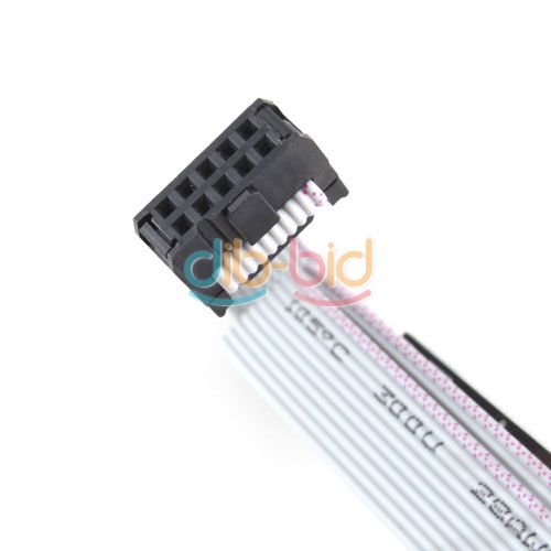

Questions:
1:Would this programmer work?
It comes with "10 pin ISP interface"

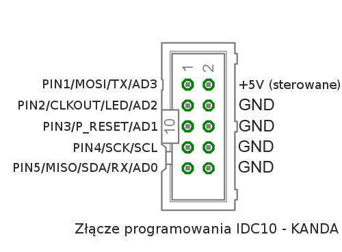

If I had to guess I'd say it's just your 6 normal ISP pins and the rest are NCs or GND.
(nice find btw I am currently doing exactly the same thing :D)
edit: bullseye :geek:
http://www.micro4you.com/files/avrpro/usbasp.pdf
(36.32 KiB) Not downloaded yet

Re: Homemade XenoGC Clone questions
Post by megalomaniac » Thu Jun 14, 2012 12:05 am
you can use either a 6pin or 10pin cable...
just make sure to match up the connections appropriately
....if it becomes too confusing, take another look on ebay because some of those usb programmers also come with a 6pin cable

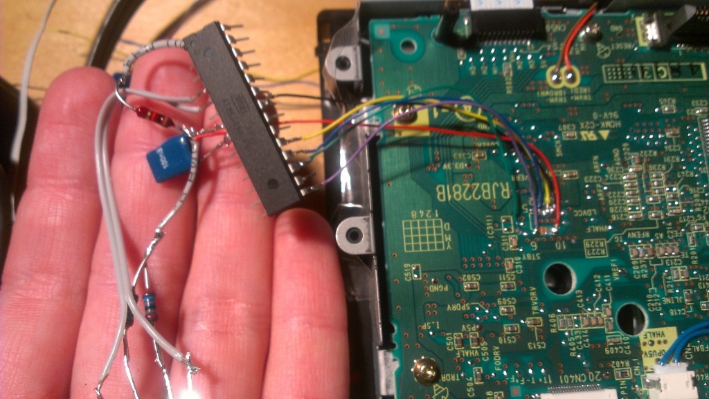

WatsuG
Posts: 11
Joined: Sat Jun 09, 2012 10:50 pm
Location: Sweden
Post by WatsuG » Wed Aug 01, 2012 1:49 am
I just rewired it. Doesn't work. Still red light.
Took wires the same colours as in your guide :)
I'm going to bed now. I'll have to look at this tomorrow. Maybe I just wired somthing wrong again...

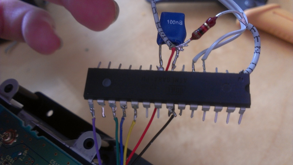

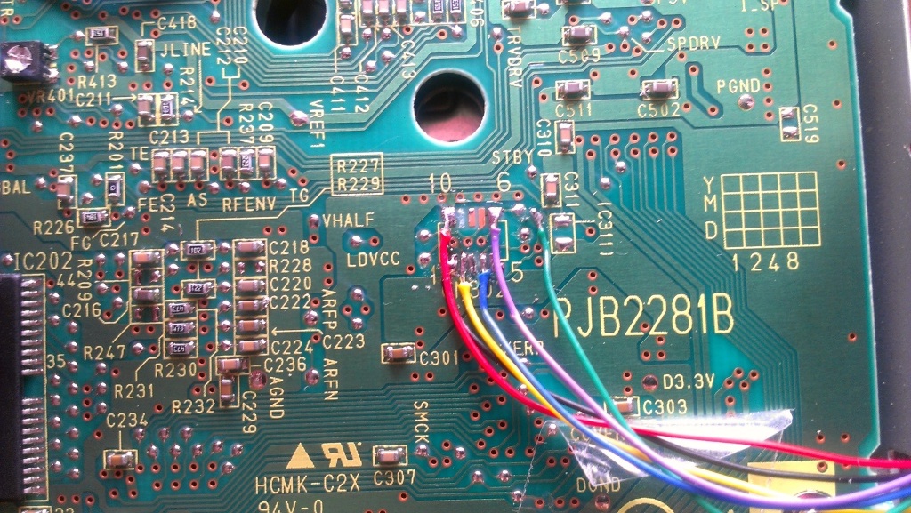

WatsuG
Posts: 11
Location: Sweden
Post by WatsuG » Wed Aug 01, 2012 8:54 am
Heres the chip.
And heres the driveboard
I broke off my voltage pin :oops: Could that be causing the problems? I soldered a cable to what was left of the pin and it seems to make a connection. I have no way to test though...
(355.02 KiB) Not downloaded yet
(162.12 KiB) Not downloaded yet

black and yellow look like they might be shorted together

Post by WatsuG » Wed Aug 01, 2012 11:35 am
I just tested with my multimeter and they werent shorted. Is setting the fuses important?
dilav
Posts: 129
Location: USA
Post by dilav » Wed Aug 01, 2012 1:33 pm
100nS? This is a Capacitor?
Yes setting fuses can be very important.
Post by megalomaniac » Wed Aug 01, 2012 5:41 pm
pad 2 and 3 look like there might be solder contact...
try moving lead wire of pad 2 & 4 to the alternate solder points like you did with 3
this will help ensure no crossover contact is made and clean up pads 2/3/4 just to make sure...
if this still dont work, unsolder the chip, set those fusesbits...then connect everything again and see what happens...
