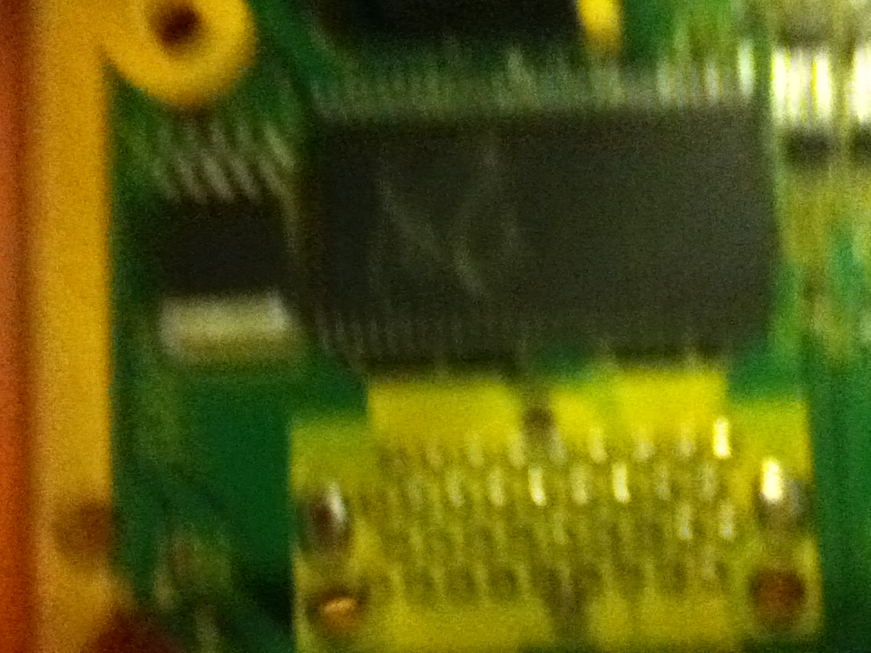

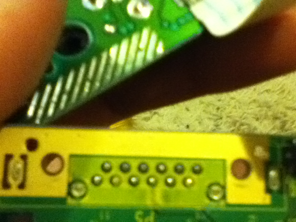

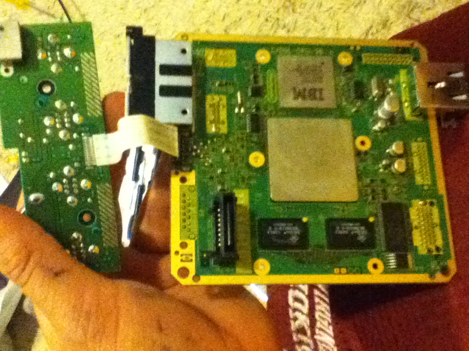

Day 1 Progress Report:
Today I have opened up my gamecube and removed several of the connectors. I only had my iPod Touch with me so I had to use it for now. Anyone see anything troublesome yet?

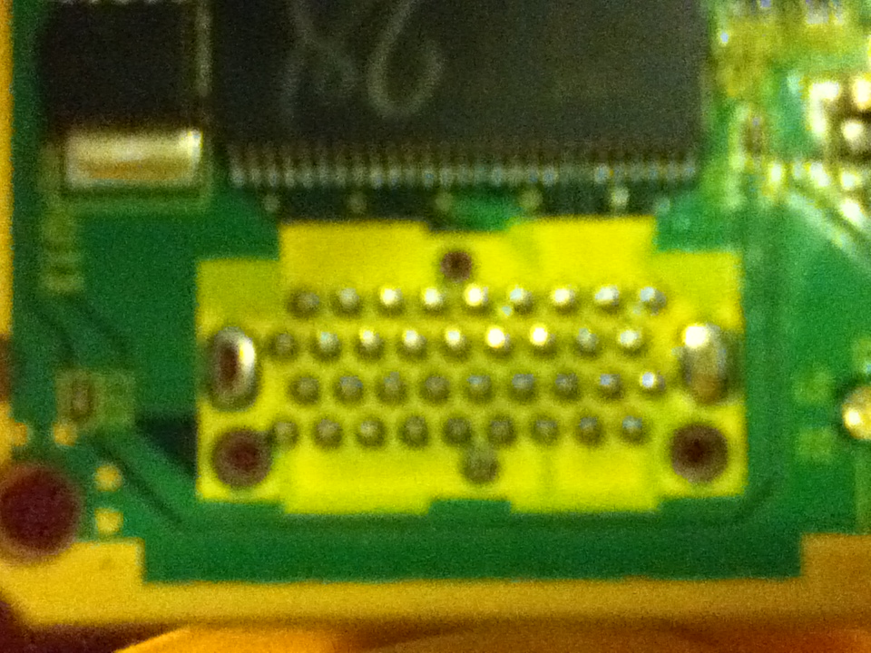

This is my main concern. I am able to see through several of the vias and some more (look for burgundy). Is this bad or normal?

looks fine. never needed macro so badly :)
Re: First Gamecube Portable
Post by megalomaniac » Wed Apr 04, 2012 4:05 am
have i been drinking too much, or are all those pictures blurry???
as for the burgundy color, you may have ripped off the traces, but you wont need em since you will cut em away during your board cut....
and if you dont cut, those just appear to be GND connections...
no real worries, the board still looks good so far...
suggestion....wire everything up before any cuts to ensure you have it all working....
then unsolder all your wires and cut the board and wire everything up again...
lets hope everything still works...
good luck...
and get better camera if possible...

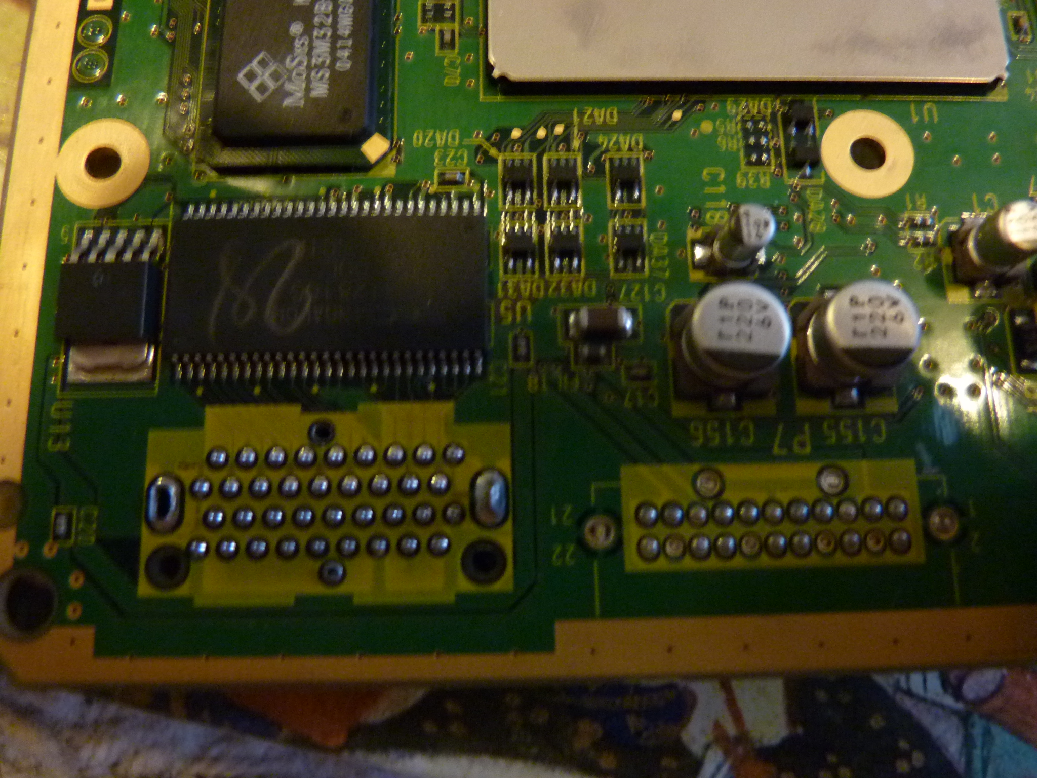

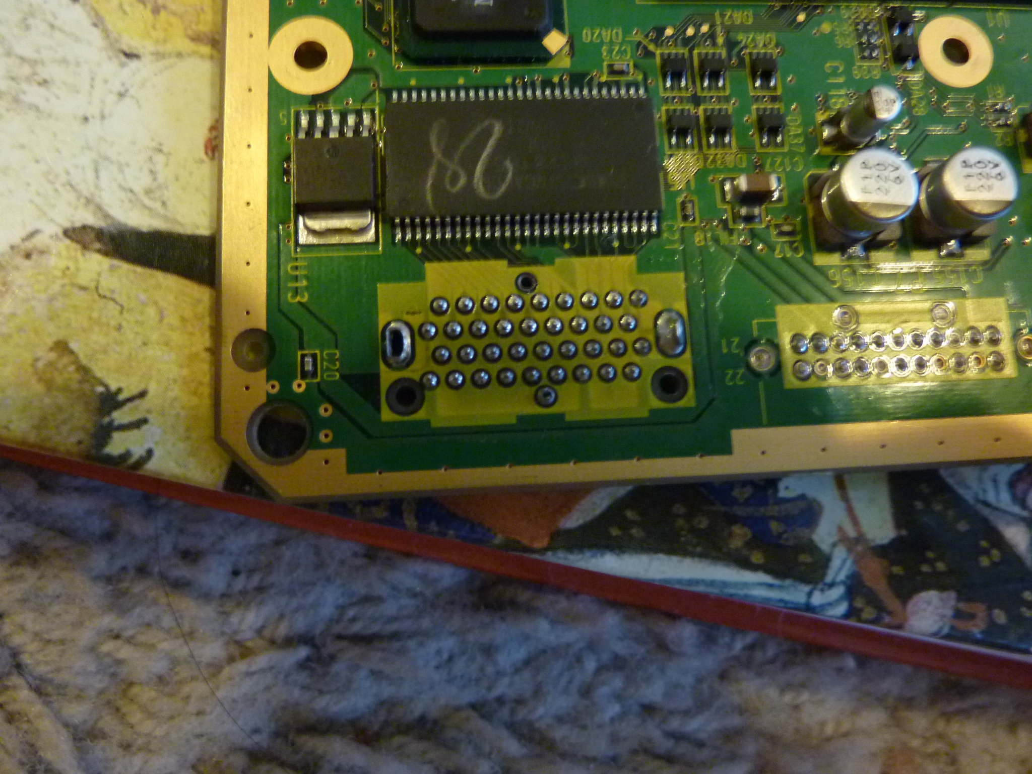

Took some better pictures today. I am getting ready to order parts for my portable. What is the best way to test if the motherboard is working? (wanted to test it before trimming)
Post by megalomaniac » Thu Apr 05, 2012 2:09 am
damn...i must be sober, talk about having a moment of "clarity"
to test the board, connect wires as if the board was already cut
this serves two purposes, it confirms the board works and most importantly, "IMO" it will test your wiring is accurate...
